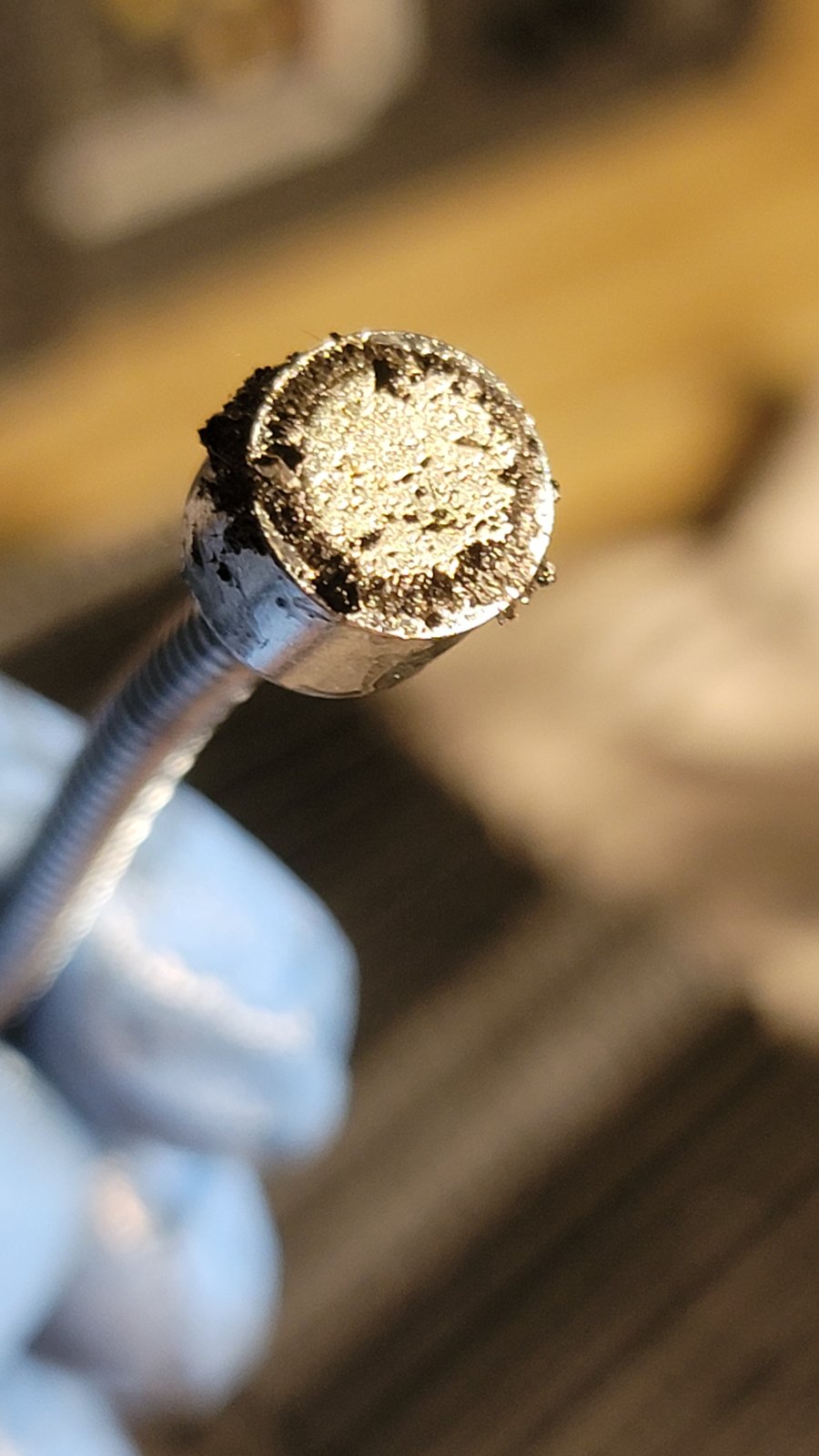

    Also changed the oil and did a little filter dissection.. it looks and feels like sand in the filter. Nothing bigger than a grain of sand. Is this abnormal for break in?
    Filled it up with some 10-30 conventional and stp additive and fired it up. Runs amazing with the new distributor. Will take it around the block tomorrow to see if the sound persists.
    Check out this filter...

  4. Take a magnet to it and see what the magnet picks up off the paper. Hard to tell what I'm seeing there.

    Here we go, ran the magnet across a few folds.

  7. That is not good and not normal.

    That my friend is a motor that needs to come apart judging from the filter and magnet pictures. A tiny bit of "shiny stuff" in a filter isn't the end of the world but that is bad news. I've cut and ****yzed filters for years trust me. Now it doesn't really matter what caused it!

    So when you do round two of this make sure that everything involved in engine timing on this one go in the garbage. This was definitely a timing issue. It would be fun to pull it apart and see the carnage.

    Looks bad, pull it out. Friend just went thru this, a machine shop did not clean out block after machining, debris was behind cam bearings. Bearings full of metal. Pulled, cleaned, turn crank, back together running good today. **** happens...402 BBC.

    Well, filter is working. There’s that.
    I think now becomes ambition and time.
    Ie flush and run, or pull it and see what’s up.
    Odd(not really) the shop said (imo to deflect blame) it’s caused by detonation.

    The oil pump gears and most likely the oil pump housing/timing cover, are likely trashed, too. Aluminum doesn't care much for steel bits p***ing through tight clearances.
    I would drop the pan first, then inspect and go from there. Odds are the filter didn't catch everything, but sometimes we get lucky and only some soft bearing wear surface material made it through. I bet the oil pump pickup screen has some debris trapped in it, too.

    Its always bad to find out a newly built engine has major problems. I would show the filter to the builder and make sure he agrees that there is a problem. Since this all started with a "clacking sound" I have to suspect a lifter may have wiped. The problem with returning an engine is that a low profit margin builder may get it going again but not do all the needed steps. It might be a good time to learn how to ***emble the parts yourself and have him clean and repair the block and crank on his dime. He might even let you do the ***embly in his shop so he doesn't lose time. My point is that if you yank the engine and start dis***embly without his approval, he may not stand behind the engine.
