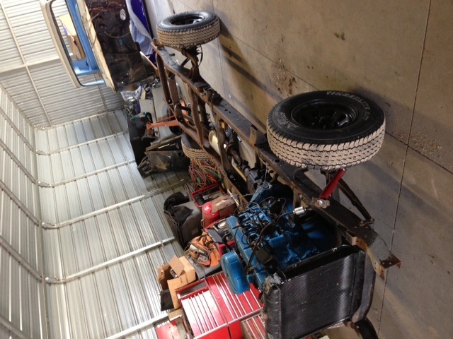

    Agree with the others on the bag and the tie rods. Also the tie rods should be parallel to the lower arm to reduce bump steer.
    Would not trust heim joints , go to tie rod ends!

    Firestone bag gambino kit but I did parallel 4 link instead of 4 link in kit
