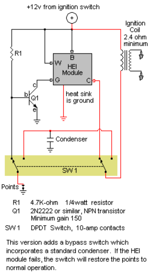

    Here's how to connect a HEI module to points using a NPN transistor [#2N2222] to keep the phasing of the Module consistent with points [so re-timing isn't needed]

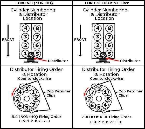

    Confirm firing order until you know it.
