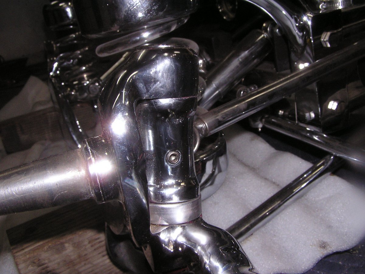

    Most tube axles like that use a simple set screw. Just drill and tap where the slot sits.

    Like this, but usually it sets up higher in the middle of the kingpin slot.

    Here is how I modified the axle on my Mysterion clone. Got rid of the ugly Ford lock pin and hole like Ed did on the original. jaj 9-12.JPG

    Looking at the picture the gusset weld looks different than the kingpin boss weld. I would bet it was added at a later time, probably over a concern running a tube axle with hairpins like a lot of guys voice.
    The only zerks on spindles are the two for the bushings on each spindle. If there is a hole on the kingpin boss, make sure it is at the height of that kingpin slot, and just add a set screw. Make damn sure you add lock***e because they can and do often come loose if you don't.

    Willys36, so your set screw is hidden on the end of the axle. Very nice. I like that detail. What size set screw can you recommend?
    Prewar, the axle did indeed have hairpins on it, and i plan to run the same, I think. I thought I would make my own so I bought the seamless tube. Buy the time I bought it I had enough in the materials to just buy a set. Oh well.

    I think I used 5/16". Lots of Lok***e!! This is of course for a parking lot cruiser/ trailer queen but I personally would have no problem running it on a rod. To each his own!

    I wasn't knocking them, and have built and driven many that way, but some guys , well, I don't want to get that debate going. The only issue with putting the set screw on the very end (but that's where I put them) is that sometimes brakes and steering needs to come off to be able to tighten the screw because the spindle has to move so far to give you room.
  12. The set screw will only work if the bearing is under the axle,, I don't see a bearing in the OP's post.

    I hadn't noticed the spindle. Set screws still work, BUT it looks like in the picture that the kingpin isn't the correct one for that spindle regardless.
    You need the kingpin kit to be correct for your spindle year. It looks like you have a pre 37 type spindle, but a 37 to 41 or 42 to 48 kingpin kit.
