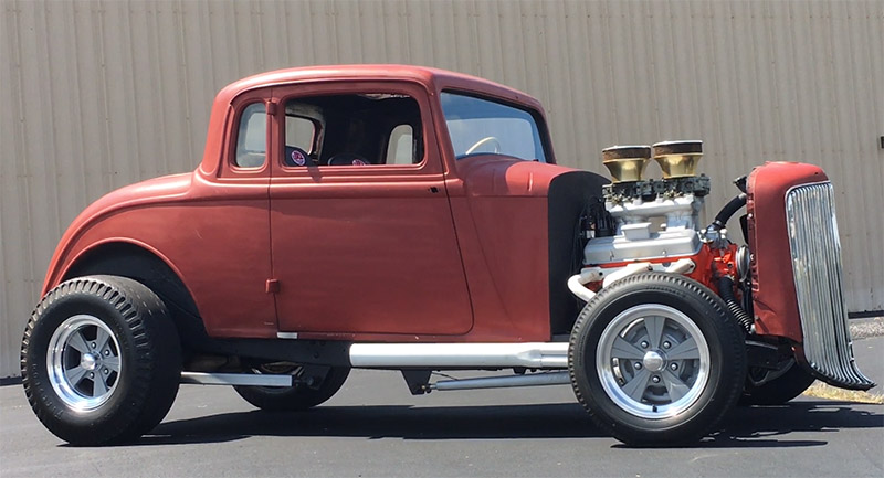

    I'm working with a '34 Plymouth coupe that's on a '40 Ford frame. It's a fenderless car, and the proportions are wacky. My father-in-law built it in the '60s and used what he could scrape up to build a hot rod on a paper route budget. The '40 Ford frame was nearly free, so he cut the rear frame rails off and built his own rear suspension. He utilized the stock front crossmember and suspension. This resulted in some odd proportions due to the spring being in front of the axle and the giant '34 Pontiac grille. I'd rather not change the grille, since it's been with the car 50 plus years. I'm looking for opinions and some early Ford wisdom here...I haven't started disassembling anything yet.
    The plan in my head is retain the stock crossmember, but use an aftermarket "spring behind" axle kit. I realize clearance between the frame and axle shrinks as the axle moves forward (the frame rails sweep down), but I think I could remedy the clearance issue with the right combination of spring height and axle drop. I'm not concerned with making the car sit any lower than it does now. I just want the wheelbase to be longer. Here are a couple pictures of the car. Any guidance is appreciated.

  3. Cool car
    Definitely move the axle forward
    On thing with the mopars is how far toward the engine can sit due to the firewall depth
    Could you modify the firewall so you can move the engine rearward
    This would let the grill shell move back

    Imho it is the grill that throws things off-cow catcher anyone? Looks like the radiator sits near engine so a 32 Ford shell or something like it would fit and add visual impact. Leave rest of car as is.
    Why do you want a longer wheelbase? What is wb now, as Ford A is 103.5" and 32 is 106"

    I agree. It's not my favorite grille ever. My thought is that I can keep my father-in-law's vision by keeping the grille, but just move the axle forward to give a little better proportions.

    When I clicked on this thread, I was prepared to be horrified, but the little car actually looks pretty decent. It looks like the front axle could move forward a bit, which you can do easily by cutting out the stock stuff and putting a new front crossmember where you want it. Also, the grille needs to be tipped back a bit to get rid of the cow catcher vibe.
    Here is the same grille tipped back just a tiny bit.
    No matter what you do, make sure to post lots of pictures.

    I had the engine and firewall out of it last year. My initial plan was to move the engine/trans back and then just build a new firewall, or even section the cowl to take some of the meat out of it. What I realized was moving the transmission back further would require cutting nearly the entire X out of the frame. As it is, the X just has a small notch in it, so I decided to leave it.

    Oh wow, that does make a big difference! I think I need to consider this before I start cutting up the frame haha. Thanks for the inspiration!
  11. That x member mod is not very hard
    I think it would be worth the effort
    The grill shell needs to lean back a littte more
    I would also suggest maybe to section the grill shell. It it were slightly thinner and shorter it may look better
    Don’t think for a second you are messing with your relatives vision. You are continuing it.

    I would think you could move the axle forward and mount it under the spring rather than behind it. You'll have to mount your radius rods further forward or make them longer and may need more drop on the axle to keep your ride height where you want it.

    Actually, the car has good proportions now, but the grille kills it. I'd move the front axle forward about 6 inches, use a 34 plymouth grille to match the car, replace the square tube rear hairpin with round stock and call it good. How does it drive? You're damned lucky to be driving your father in laws car, nice piece.

  17. The car does not look that bad actually. The easiest option would be to run the axle spring over. You can get a main leaf for that and some standard spring perches. That will move the front axle forward about 4" (just measured the spring in front setup on my dragster). A reverse eye main leaf should easily make up for the difference in ride height.
    My old dragster has a suicide mount hung off the very front of the frame that is also an option. But the easiest way to go would be spring over the axle.

    what about moving axel forward, and clip off the bottom of grill, lean alittle lean back?

    I know you want to keep the grill but moving the axle forward so it’s under the radiator and a repop 32 ford shell would fix the car to me ... the rest looks like a neat old hotrod
    Moving the axle forward wil probably cure a ton of its handling problems you talk about, what steering is in it ? Cross steer ?, does it have a panhard? What’s the caster at?
    6x2 or 2x4 cross ram and different headers would be the other things I would personally add in the looks department

    I will go against the crowd and say the grill is awesome. the whole car is a great example of the '60's vibe.
    Now, things I see that could be improved or changed:
    -the grill shell is mounted to the original crossmember via a bracket going to the original '40 fender brace hold. probably to position it around the (original '40?) radiator. changing and tilting the grill would help the flow of looks but will involve changes to all these parts.
    -the engine is front mounted via chunks of 2x4 tube and biscuit mounts to the original '40 engine mount holes. functional but looks bulky, side engine mounts would help a bunch, and you could re-locate the engine to help proportions.
    -the front spring has a reverse eye, but no drop to the axle. a drop axle with conventional springover axle would help proportions a bunch and you would not have to jack with the wishbones or crossmember.
    - seeing the single trailing arm and coil springs on the rear, yeah, that definitely needs improvement. Is there a panhard bar to keep it centered?
    Now, you have a running, driving car that's pretty righteous. Any major work to the chassis will mean serious downtime. consider having a new chassis built to incorporate the changes everyone is pushing, but will minimize downtime. I would be sad to see this survivor blown apart, then sit and you become disappointed. of course, budget will dictate what you do.

    I think the OP is right on, the grille is part of the history and should remain, although a repositioning would look nice. Front axle centerline is way too far back, and rear suspension could use some rework. Everything else I'd keep. Neat car with history.

    Axle for sure needs moved forward. Grille shell needs to lean back a bit, and needs a surround built to go on the bottom from the frame rail down, it looks cobbled the way it is now with only the grille below the frame and the surround above the frame.
