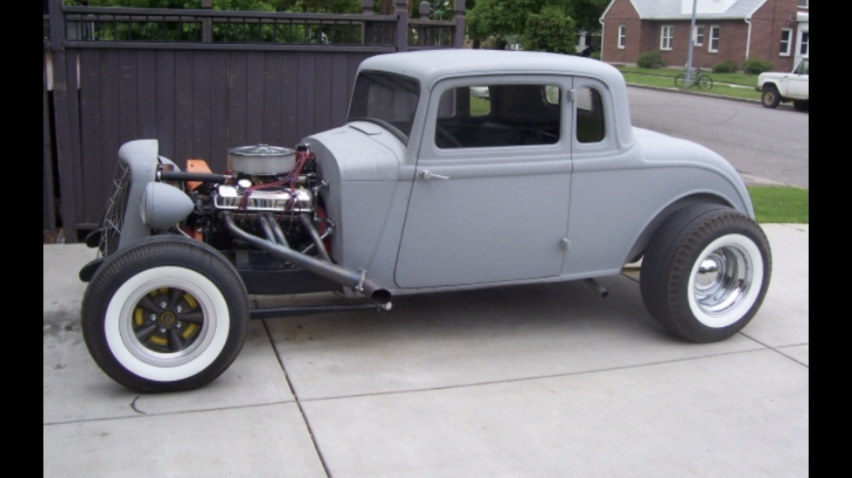

    For what it is worth, the body is a '33 Plymouth PC, not a '34. PC's had no glove box on right side and no fake glove box on the left. Later '33 PD had both. '34 Plymouth (and Dodges) had the instrument cluster on the drivers side with a matching shaped glove box on the right. '34 cars had a lock cylinder under the p***enger side outer door handle. '33's had a slide out windshield with arms on each side, '34's had a center crank out. Front of roof was taller on '34's and posts were at a little different angle. BTW, if it is ***led as a '34 that really doesn't matter, at least not to me. Probably thought it was a '34 so that's what they did.

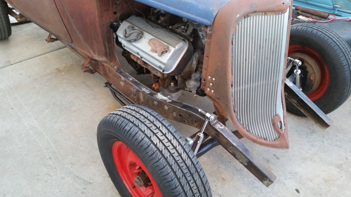

    I am doing a '33 Plymouth coupe too, with a 331 Hemi. I'm using a '34 Dodge grille shell with a custom bar grille. The shell is cut to a point to eliminate the "Jay Leno" chin cuz they look funny with the chin and no fenders.
    I agree, tilt the radiator shell a little and go to a spring over axle and lengthen the front frame horns a little and call it good! I still need to trim my horns just a touch. I love your car. Here are a few pics of my project.

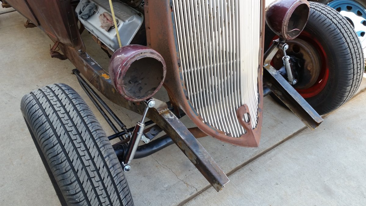

    Thank you for the feedback and inspiration. My first attempts will be moving the grille around and mocking up some headlights. I already have some lights, but just don't have any tasteful mounts for them. I'll work on that. The rear end does have a home made panhard bar to keep it centered but it needs some type of third link (torque arm) on the top of the housing to keep it from trying to wrap up on accel/decel. The rear suspension needs some major help and I have some ideas to get it right.

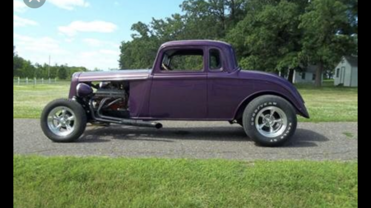

    34 Hiboy HAMB Photoshop.jpg Heres a photoshop pikky that one of the clever folk over at the P/S thread did for me last year. The style points which I thought were important on a highboy 34 Chev were moving the front end forward about 4 inches, fitting a dropped forged Henry type axle and shortening up the front of the frame horns so the tyres were the furthest forward part of the car.
    I also wanted the ch***is sitting lower as I think they look better that way, tho I see that you are happy with your ch***is height as it is.
    Reality of our build was that
    1) the front end didnt need 4 inches - I think it we stopped at 3
    2) we used a repro 32 crossmember
    3) we arent as far on with the project as we had hoped to be by this stage (so nothing photoworthy)

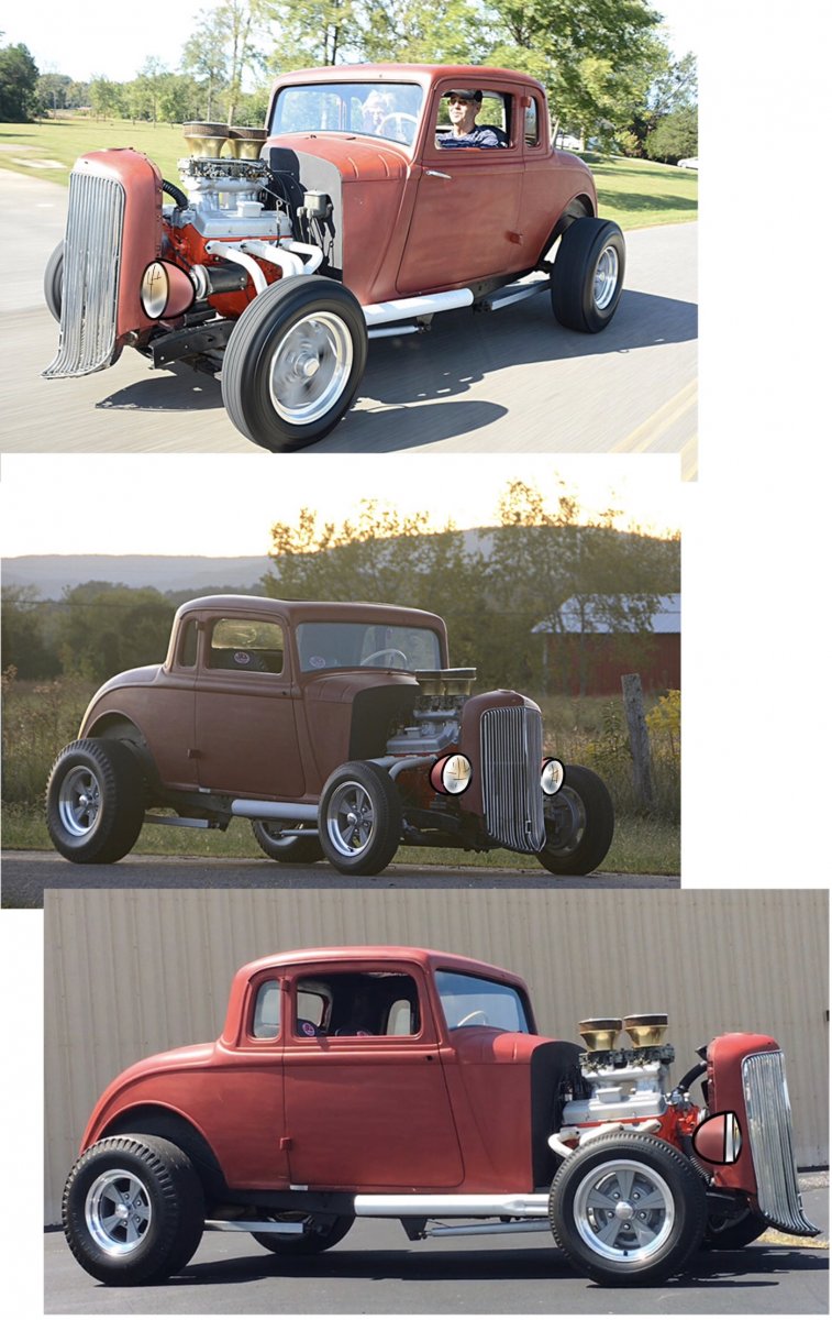

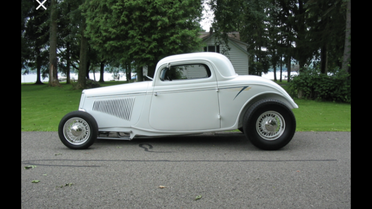

    Looking better ....can you try one pushing it forward to centerline of radiator and then maybe one pushing it just forward another 4-6” and shortening grill bottom about 4”?

    If you notice, all those great looking cars Thirtytwo posted have the front axle directly or very close to directly under the grille. To really get your coupe looking right you will have to do the same. You will probably have to move your front crossmember clear out to the front frame horns. It would most likely be best to use a Model A style front crossmember instead of reusing the 40 and then put the spring up on top of the axle.
    Squablow and kidcampbell71 like this.
