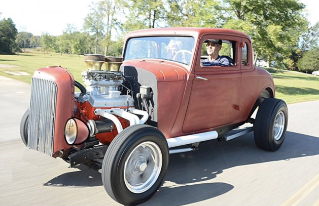

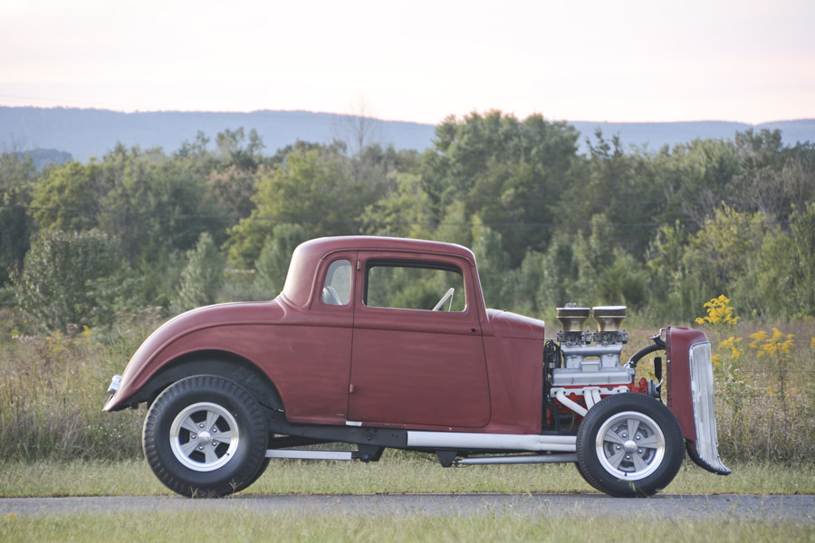

    I just watched the video and well it's a very cool story, just about Family, Hotrodding and Life...
    This is really a personal choice but here is my take on it...I think it looks more proportionate but did I lose the appeal...not sure...I hope it helps...
    This is one of the downfalls of Frame-swaps...not that they can't be and weren't done back in the day...
    its just getting it right...You may have to add frame forward.
    I wouldn't cut the bottom of the grill of either. Why its a huge part of its appeal...
    You could even fab some fancy metal skirting to fair it into the frame...
    I increased the size of the rear slick to better fill the wheel-well. There was discussion just today on slick size availability.
    Slick Post with info by @D-Russ...
    https://www.jalopyjournal.com/forum...years-resolution.542263/page-44#post-12894171
    Also added was Headlights and a Partial Hood, Ladder Bars :)...why the face...
    I'm no ch***is guy...technically they taper in to mounts on a cross-member underneath.

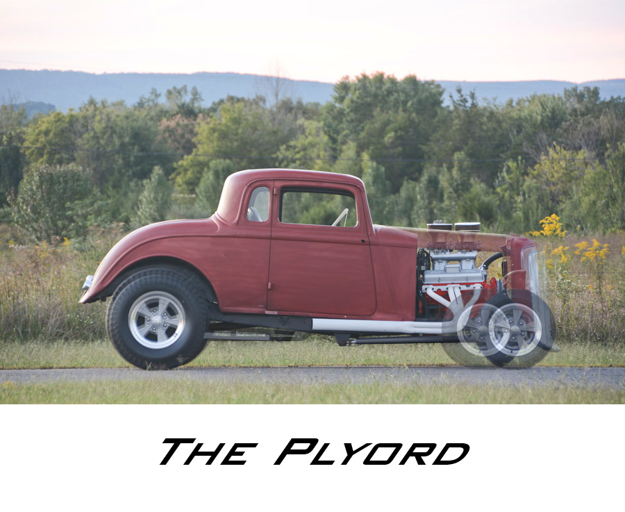

    If you clic the thumbnail below, I did an Overlay and you can see the amount the Front was moved ahead...The Grille Up, moved back & angled back slightly

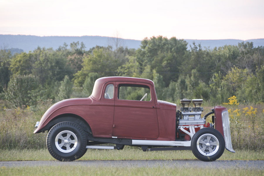

    Just chopping off the cow catcher part of the grill would make a big difference. coupe 2.png

    Drop the rear an inch or two, maybe drop the front a bit too, lean the grille back a hair and call it good. It really doesn't look bad in my book. I'd spend more time worrying about how to get it to drive right. I like the look, its clearly a 60/70s hot rod.

    Spring eyes are reversed, as it sits. Replace axle with '33-'36 dropped, from SID'S in Oklahoma. (partnered with 'Okie Joe') Replace spring with correct length for '33 axle from POSIES. Spring hangers from Pete n Jakes. Wishbones can be hairpins to fit the axle. This will move axle forward 5.5", and the length between hangers and king pins will be correct. Car will look like the renderings from STOGY, quite correct, splendid, in fact.

    I'm going to go against all the grain here. I suggest starting over. It's so goofy looking and out of proportion you would be wasting your time. Build a proper frame and fix all suspension problems at the same time. Forget all that **** about history and family heirloom ****. Life is too short to put up with half *** measures because of it. If you don't have the skill to pull it off I would suggest find a hotrodder with good taste and have him do the work. It has potential but not doing all this other stuff. Find a picture of the coolest one you can and copy it with your personal touches. You will be much happier in the long run. My input. Take it if you want or tell me to piss off. I'm ok with either. Cheers. ( Ps. the grill looks like ***)

    I think a taller tire in the rear would even out the proportions quite a bit.

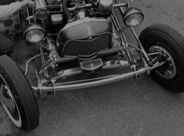

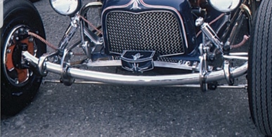

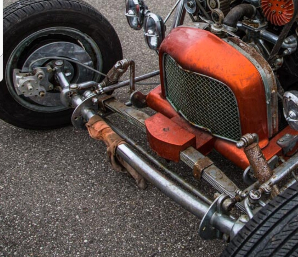

  10. Reversed purch spring behind
    seb fontana, scott27, Cosmo50 and 2 others like this.
  11. now there is one that never would have occurred go me. Does it go wonky on caster angle? I could look at my heap and figure that out but you have already done it.
  12. Caster adjustment is in the Hairpin wishbones, crank in 6 to 8 deg. and you're set. JW

    Stogy
    Is that gusset on the axle welded or bolted to the reverse perch...with this Hotrod it may not be far enough of an offset to work...it may need more...
    This is an altered wheelbase but reverse of it's normal application...

    Reminiscent of Norm's Kookie T, yes ??
    Screenshot_20190127-123605_Gallery.jpg Screenshot_20190127-123648_Google.jpg Screenshot_20190127-123730_Google.jpg
    dwollam, Tim, scott27 and 4 others like this.

    And just to give everyone an update, we've decided to go with a '32 style spring-over axle setup. I'm going to likely use a Speedway kit, which comes with wishbones. That will gain 4 inches up front. Moving the steering box to accommodate the new axle location will give me a good excuse to go through the steering system and get it tightened up so the car drives a little better. I'll keep everyone updated when the parts start coming in.

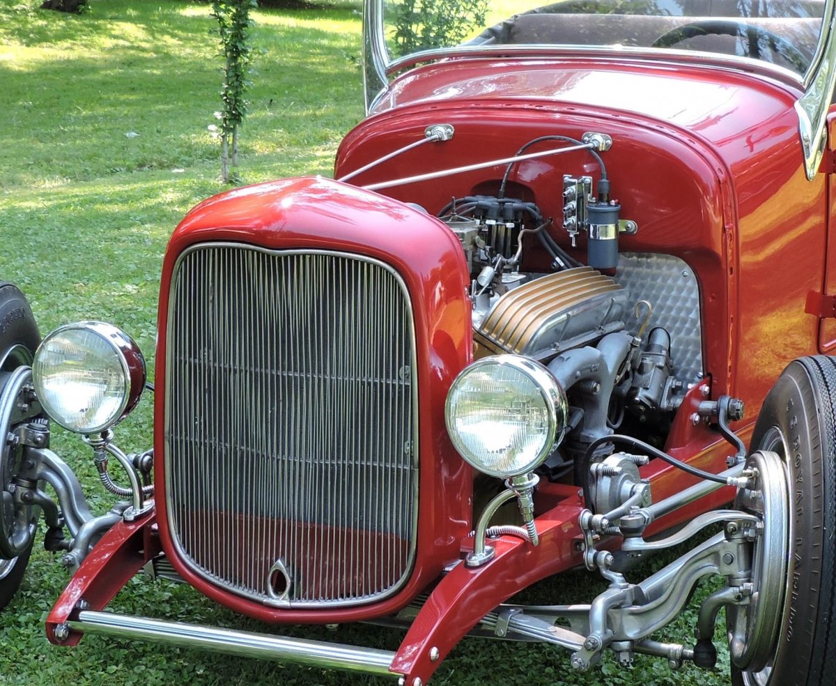

    Wait a minute you have wish bones , you will need an axle, perches and leaf spring , no need to get a kit , I think an old dropped ford axle would better suit the vibe of the car also... just another opinion though..

    This version looks much better!
    Stretching the wheelbase, tipping the grille shell back and lengthening the hood made it look GOOD!

  20. Check with Von Franco he's built two T's with this setup recently and can set you straight on how to do it. JW
    Stogy likes this.
  21. It is welded to the axle and wishbone.
    Stogy likes this.

    A great video and an even greater tribute to your father-in-law. That being said, I couldn't help but notice how flat that front spring is. At first I thought it was camera angle but looking at the first shot of the car in the video from the right front and again later on the shot from the front driver's side and the spring is definitely flat. The angle on the spring shackles is right but it looks as if there wouldn't be much travel in them at all. If the body is coming down the shackle can't move sideways as it should. If the body is going up, the shackle will bind and push up on the axle. Either way, the ride is going to be erratic. Maybe I'm wrong but I don't think so.

    That grille looks like a snowplow no matter if you change the wheelbase. The short wheelbase looks cool and if it was an Altered Coupe without radiator, you could keep it. But even with a super decent grille it will be difficult to make it look right.

    I would try moving the spring behind the axle like the doane ? deuce roadster .
