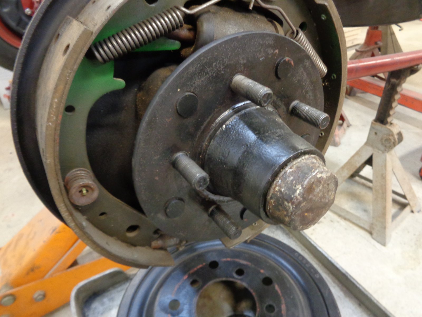

    You can buy a template to re-drill them yourself .https://m.roadkillcustoms.com/wheel-bolt-pattern-re-drill-guide-jig/
    Or you can make your own template.
    You need a piece 1/8" or so metal. ( aluminum is easiest)
    Mark a center.
    Draw two concentric circles. One for each bolt diameter.
    On one of the circles mark the lug spacing. (every 72 degrees) Then use a pair of dividers to confirm even spacing.
    Do the same on the other circle in between the marks on the first circle.
    Drill all the holes with an 1/8" drill
    Drill the existing bolt circle out till it fits very snuggly over the studs.
    Leave the new circle at 1/8".
    Cut out the center large enough that the plate will lie down flat on the hub and drum.
    Take the assembly to the drill press and use the 1/8" holes to pilot 1/8" holes in your drum and hub.
    Remove the template and finish drilling to the appropriate size for your new studs.
    When I get out to the garage I'll post a picture of how mine turned out.

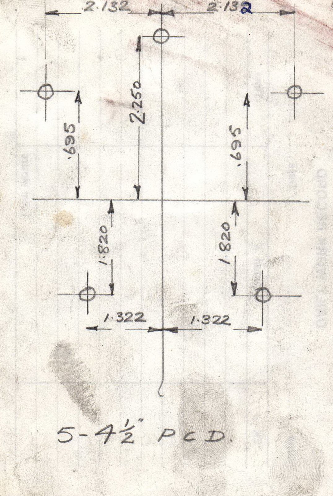

    If you got access to someone with millings machine with digital readout here are the dimensions for 4.5 and 5.5 patterns. I built a mold years ago for wheel pattern checking. wheel bolt 1.jpg wheel bolt 4.jpg

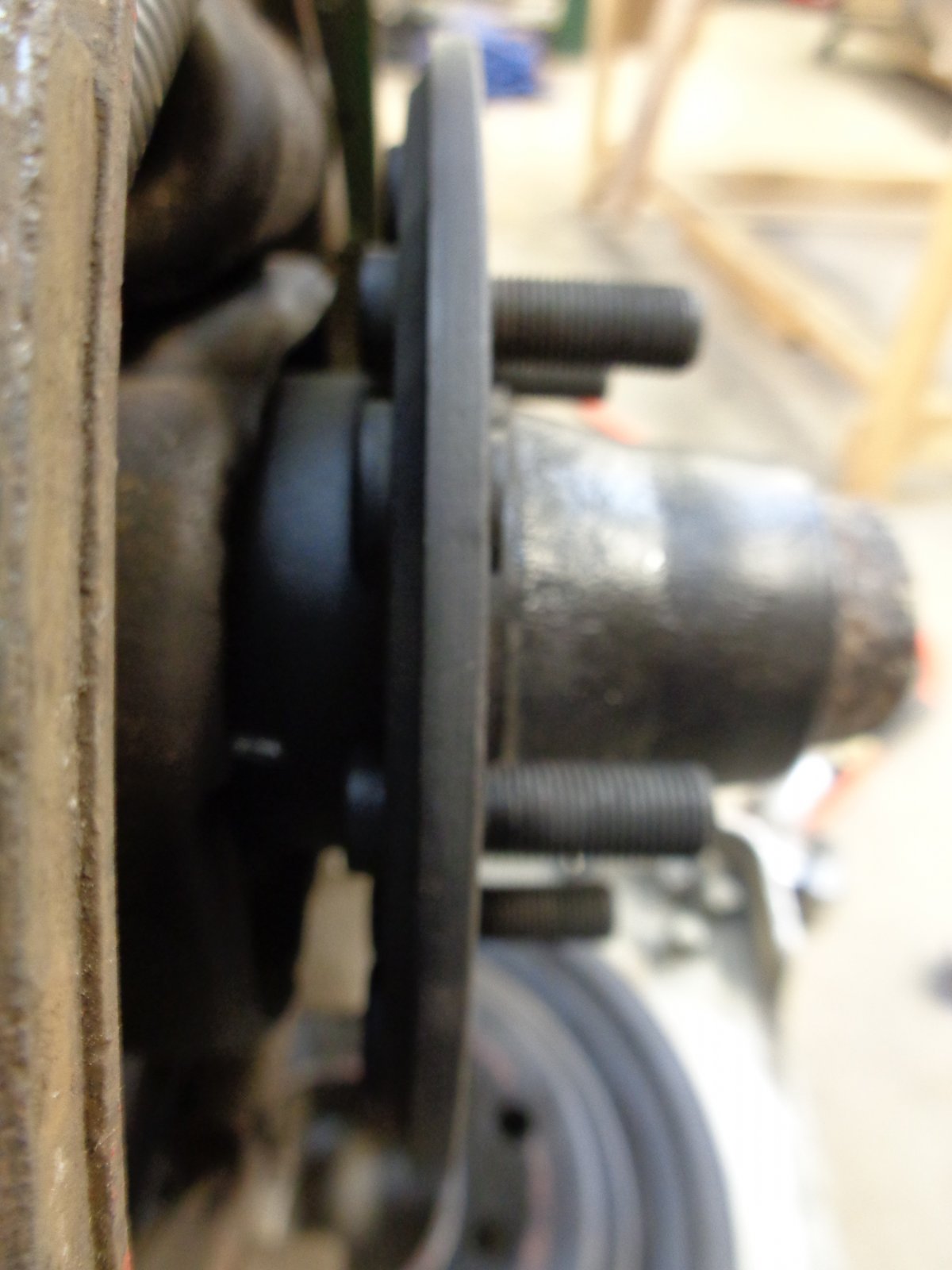

    It is tough to re-drill 40 hubs. The studs are fitted in raised bosses and the rest of the flange is not really suited to redrilling. You would be better using 42-48 hubs. They are flat on the back.

    X-cpe
