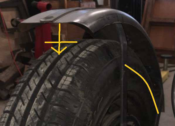

    Hi all
    I've been working on my front fenders. I used 1/4 x 1" strapping to make the supports. I have taken the car around the block a few times (30mph) there is some shake on my local roads. Is some shake inevitable? l can reinforce these supports but I don't want them to be too bulky or do I need to start again.
    Thanks Phil IMG_1270.JPG ok

  2. I would have made them so they were closer to the tire, pretty big air gap. They're going to shake around either way since they move with the rest of the suspension.

    Yes, like 2/3 closer to tire!

    Close that air gap and possibly add an arc shaped reinforcement bracket, mimicking the fender radius. That bracket will stop the shimmying from occurring by adding some inherent strength.

    No, you cannot stop the shake without making them from industrial grade material. I wouldn't go more than 1/4 inch thickness, they'll look odd, and I agree that you should build them closer to the tire, I use a few small pieces of 2X4 for mine, 1 1/2 inches off the tire is about right and looks good. The shorter the bracket, the less shake you'll have.

    Look at all the original fender braces over the years. They all have some sort of contour built into them for rigidity. None are built from flat stock. Maybe try tubing , either round or square.

    I went out to the shop today and made some modifications. I tightened up the radius of the fender so I could bring it closer to the tire. I redrilled the brackets to shorten them. Even 1" shorter seemed to stiffen them up quite a bit. I will try a small reinforcement from below the top bolt to just above the offset as that seems to be were all the vibration originates from.

  25. Another option is to as a rib. 1/4x1/2 would work real well.
    Just adding an option here @mgtstumpy 's advice is good.
