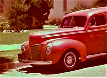

    The last thing we were going to do when we had saved up as young 20 somethings, was to get front disc brakes for our 327 powered 1940 Ford Sedan Delivery. The stock brakes worked well when new, but discs offer far superior braking power over drums. You will get a lot of different answers, so do your research. YRMV
