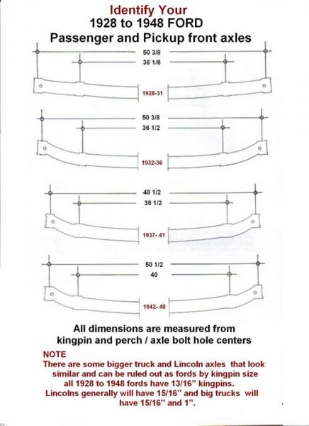

  6. '29 Gizmo
    Joined: Nov 6, 2022
    Posts: 1,172
    '29 Gizmo
    from UK
    If it compatable with stock installation it should be ok depending on the model year its meant for
    2Blue2 likes this.

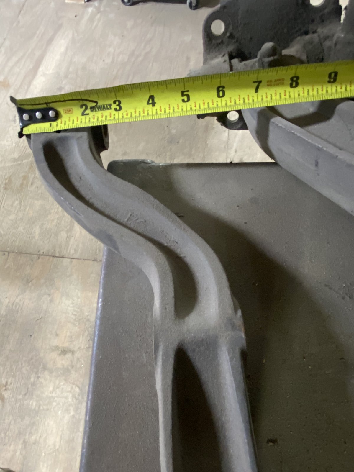

    At 51.5 across the kingpins the rims don’t fit under the fenders (wasn’t going to use fenders but),
    tires/rims hang out about an inch and a half.
    Does the wider 51.5 axle have a better turning radius then a say 48 inch axle?
    Or is that also dependent on rim width?
  11. 1946caddy
    Joined: Dec 18, 2013
    Posts: 2,352
    1946caddy
    from washington
    How did your axle get to be 51 1/2" inches at the king pins ?
    What is your c to c on your spring perches ?
    1928 - 1936 Ford axles are 50 1/2" king pin to king pin and when dropped properly
    will be streched back to 50 1/2" or not streched to 48 1/2" ( most
    popular choice) 4" drop
    1937 - 41 Ford axles are 48 1/2" and if used in a spring over the axle will be streched to maintain 48 1/2" and use a special spring to make up for the difference in spring perch lenght.
    I'm guessing that some one that didn't know what they were doing dropped your axle and welded up the ends to cover up their screwup. Craigslist special.
    alchemy and 2Blue2 like this.

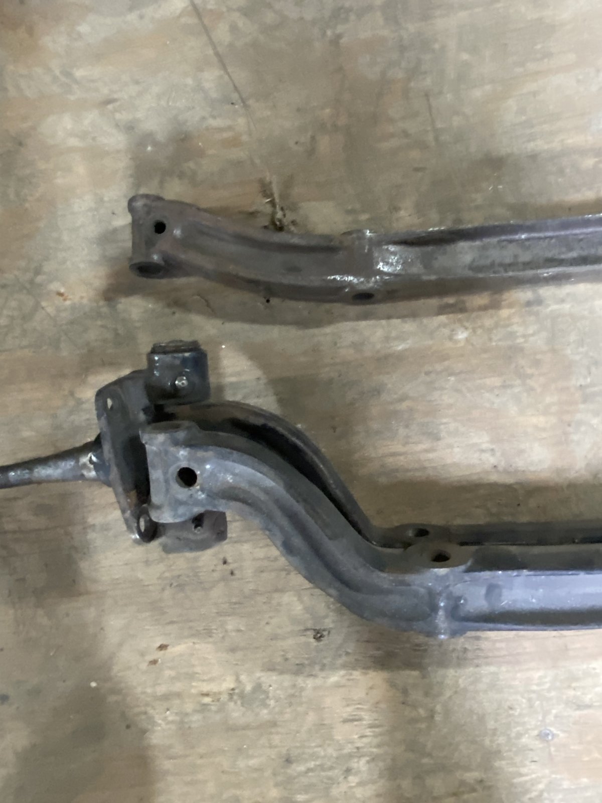

  15. The aftermarket narrow axles are copied from original axles that were cut in the center, narrowed and welded back together and dropped. The spring perches are closer together. Some were done nice and some were done like a shetchy death trap ****. Someone decided to just make new axles to those dimensions- narrowed and dropped.
    The biggest reason for narrow axle is that changing brakes and wheels pushes the tires out and changes the Overall track width. Look at stock wheel mounting surface and stock wheel offset. So logically the answer getting it to fit again is to bring the king pins closer to each other.
  16. 2Blue2
    Joined: Sep 25, 2021
    Posts: 411
    2Blue2
    It has a mono leaf (with reversed eyes) mocked up on it now and I’m not sure the spring affects scrub line, right?
  17. The spring changes frame to axle distance.
    Not axle to ground.
    That blue axle looks pretty long in the drop portion.
    2Blue2 likes this.

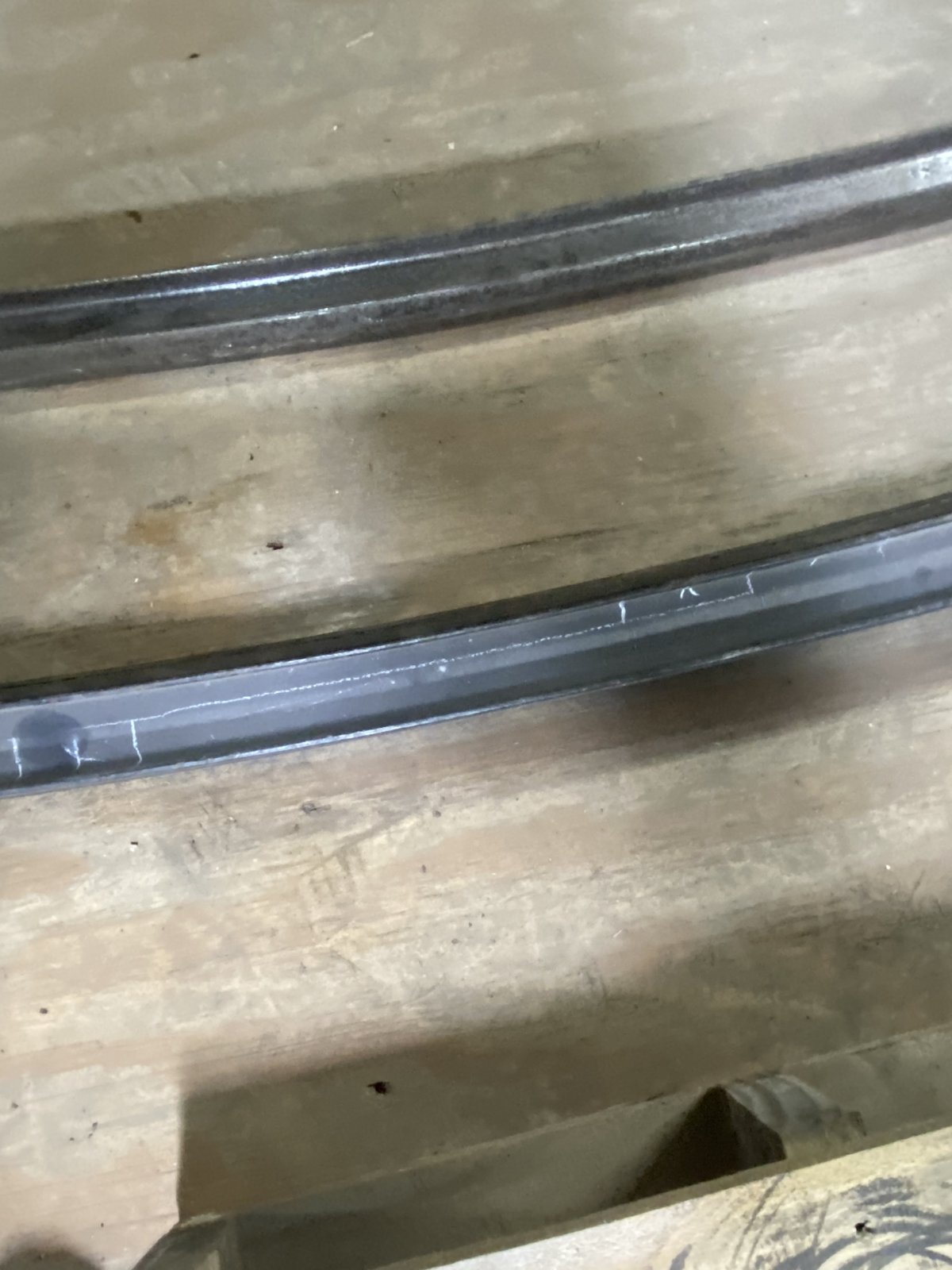

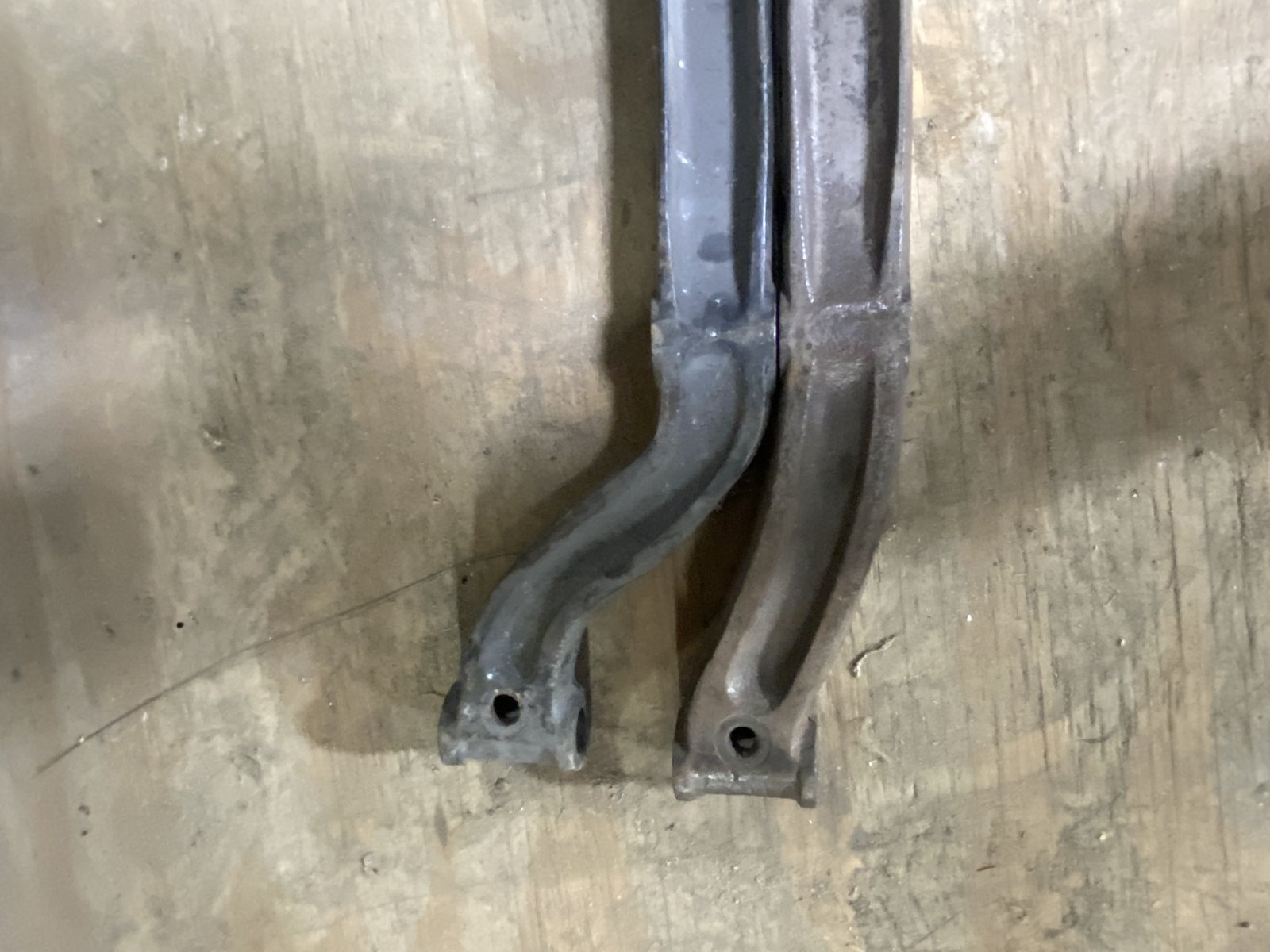

  18. Here’s a 36 stock and 36 dropped
    here’s another dropped axle under the 36.
    I can’t really positively ID the lower one, but it’s a lot prettier and uniform. Same C/C dimensions but a little less drop
    Here’s the layout to cut and narrow a factory axle.
    36 dropped shows 4” total change from top spring thru change to top king pin
    2Blue2 likes this.
