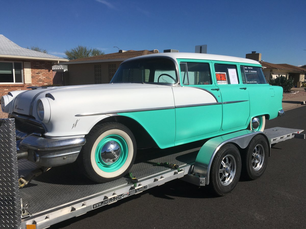

    Has anyone cut (1) coil off the front springs on a 56 Chieftain wagon to drop the front end down? If so, how much did it lower you front end?
