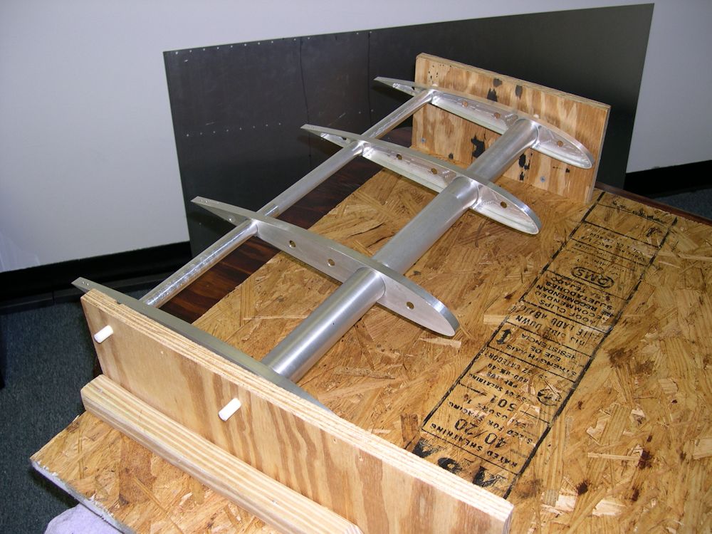

    The airfoil shape I used is the Clark Y. It has a thickness of 11.7 percent and a good lift-to-drag ratio at the speeds my dragster should run. (It was used on the Waco biplanes and the Spirit of St. Louis.)

    The ribs have a wall thickness of .070". They are attached to formers which measure 1.5" O.D and .75" O.D. respectively. The wall thickness of these are .030".
    The overall dimensions are 24" x 14.5" (or 2.4 square feet).
    My friends who fly said that this was way too overbuilt and would never get off the ground. "That's the whole point", I replied :)

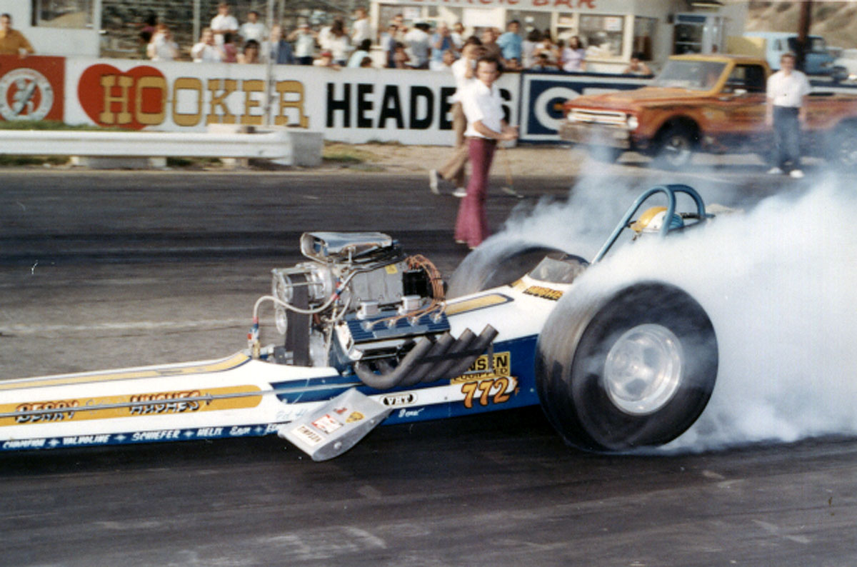

    Don Long front wing kit

    That explains a lot. Thanks for posting. Were these also the pattern for the side wings that got so popular in 1971? Berry%20&%20Hughes%201.jpg

    Temporary wood fixture kept the framework elevated allowing me to use Clecos on both sides while wrapping the wing skin.
  6. dreracecar
    Joined: Aug 27, 2009
    Posts: 3,476
    dreracecar
    from so-cal
    Yes they were, Bore the inner spar at the "X" and towards the back where it comes together for tube supports and corresponding bolt holes on the outer spar. slide ***y into frame mounts and pin.
    The shape had enough cross section that no other internal spar or frame work was needed for the front. The rear cannards were just mudflaps to kick the air over the headers and tires and really did create that much downforce, but since the stall was so high , it needed the support tubing.
    Funny story---- Don once hid lead inside a front wing to fool everyone that he could build a car that didnt need any front ballast and that the wing would suffice.
