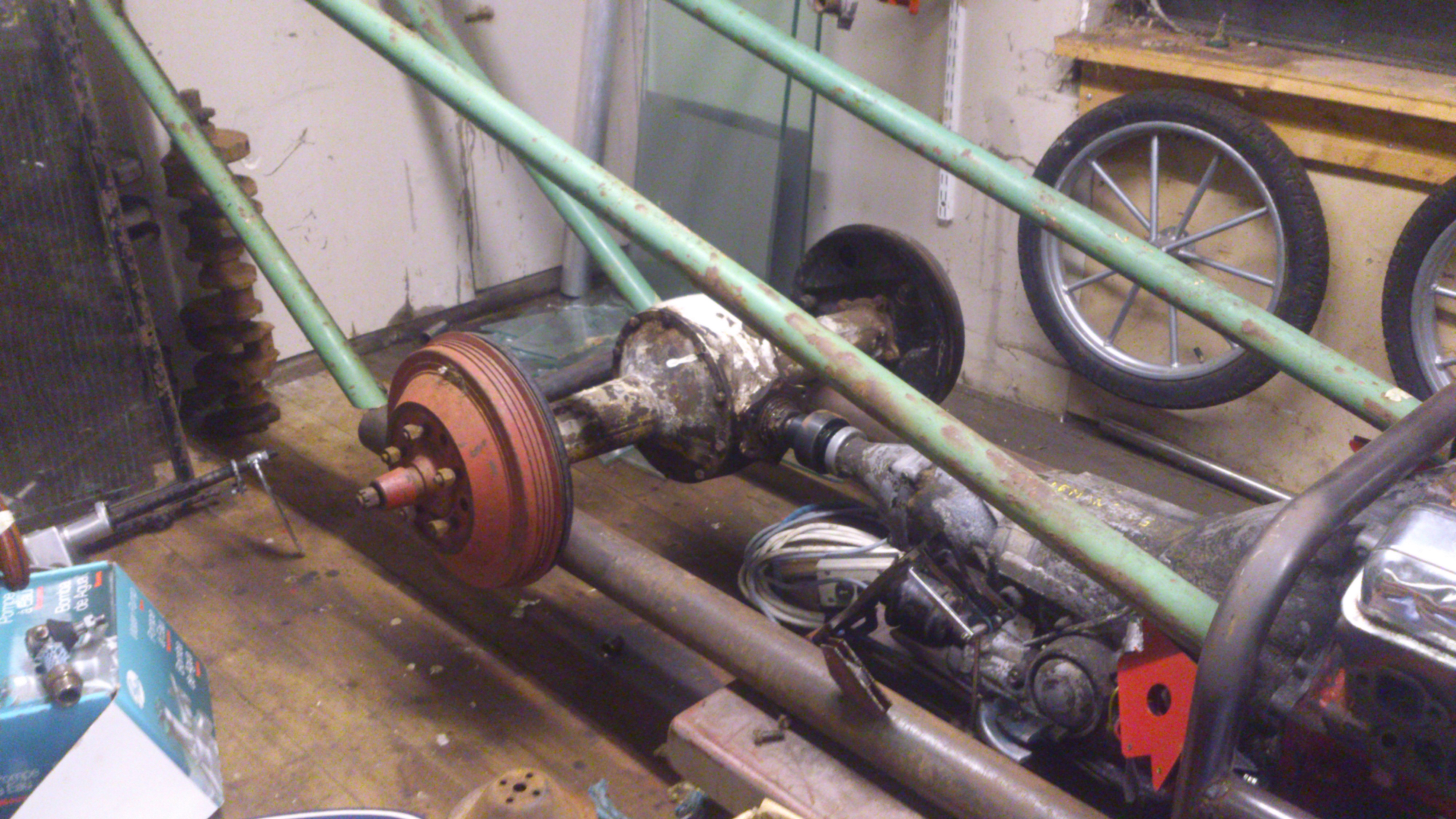

  9. TheTumbleweeds
    Joined: Jul 29, 2010
    Posts: 539
    TheTumbleweeds
    from Sweden
    After this picture, the housing is repolished and the screwaxle where checked up. And the main axle with bearings are put together. Screenshot_2015-02-19-18-42-40.png
  10. TheTumbleweeds
    Posts: 539
    TheTumbleweeds
    from Sweden

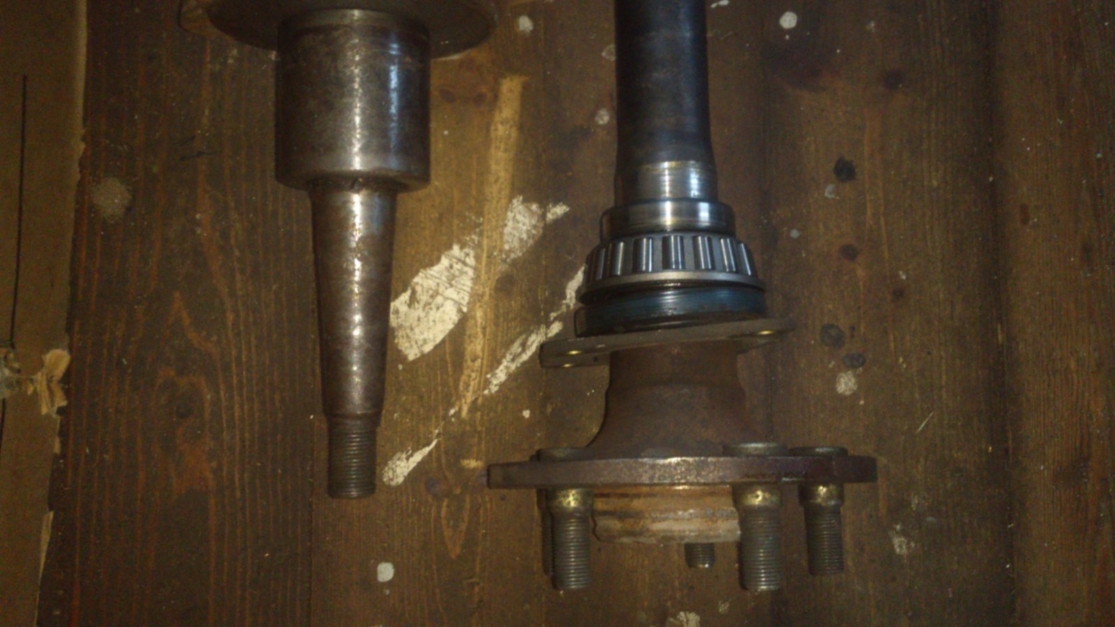

  26. dragsled
    Joined: May 12, 2011
    Posts: 1,975
    dragsled
    from Panama IA
    Some companys have differant spline cut , Mark Williams have there own spline cut , Their axles fit their spools only
  27. TheTumbleweeds
    Posts: 539
    TheTumbleweeds
    from Sweden
    Here is the difference between the axles
    A little bit safer this way, and the right one is famous to hold the strength. DSC_3110.jpg
    volvobrynk likes this.
