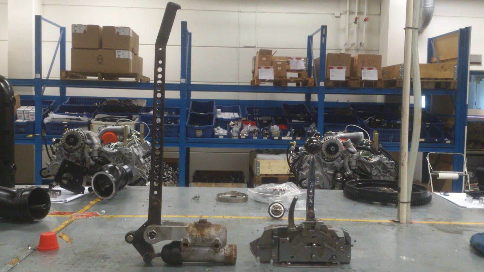

    I found the ultimate head brake cylinder for my dragster! I dont know why the Picture came upsidedown? But anyways, I Can Mount a brakebar directly to the cylinder, I LOVE it DSC_3129.jpg

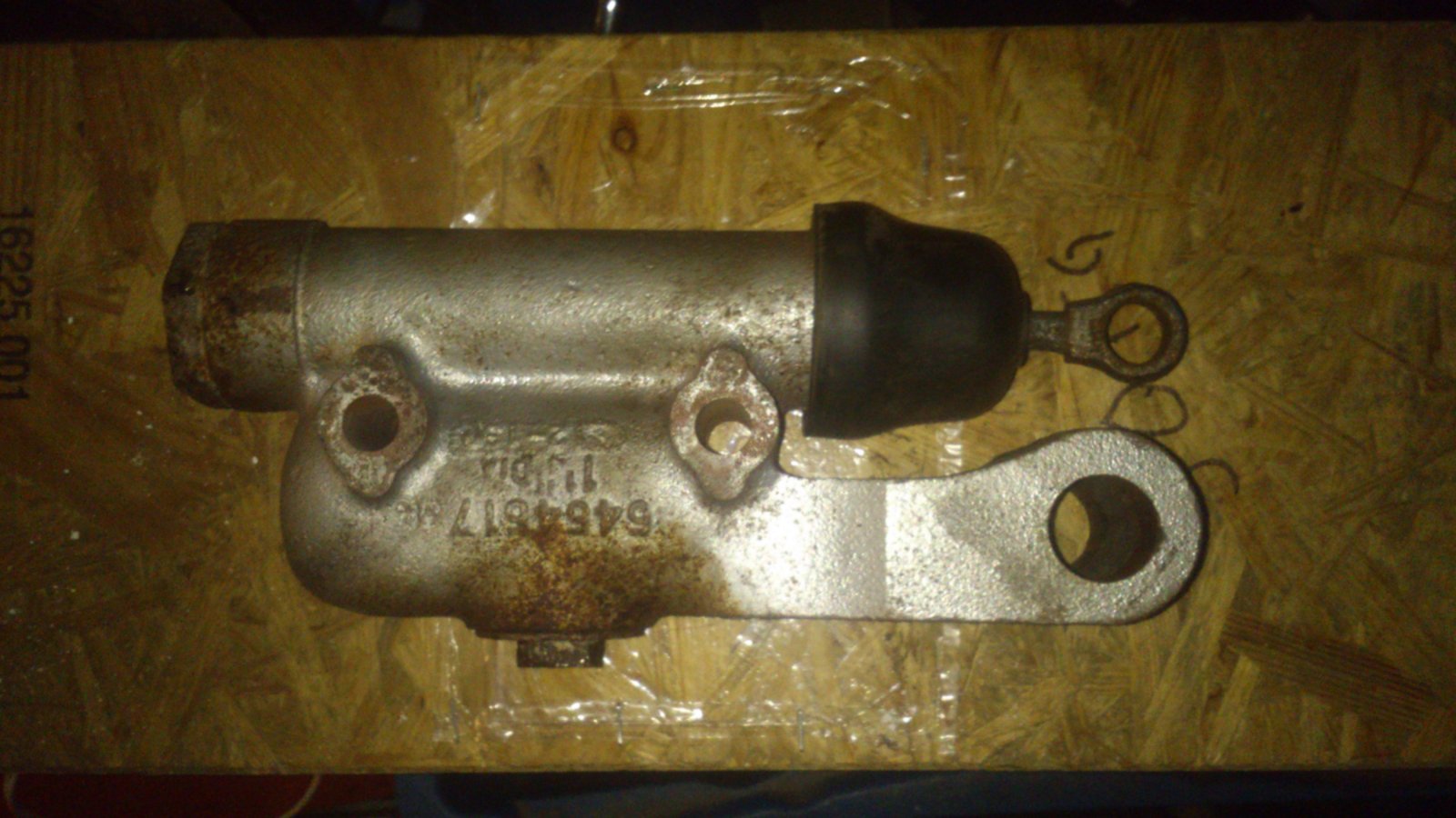

    I belive chevy truck 55-59?
  3. volvobrynk
    Joined: Jan 30, 2011
    Posts: 3,587
    volvobrynk
    from Denmark
    That's a early Chevy single circuit truck master, fits most Chevy AD and TF, 1949-59.
    The are mostly the same.
    Maybe @squirrel knows more or @55sedandelivery

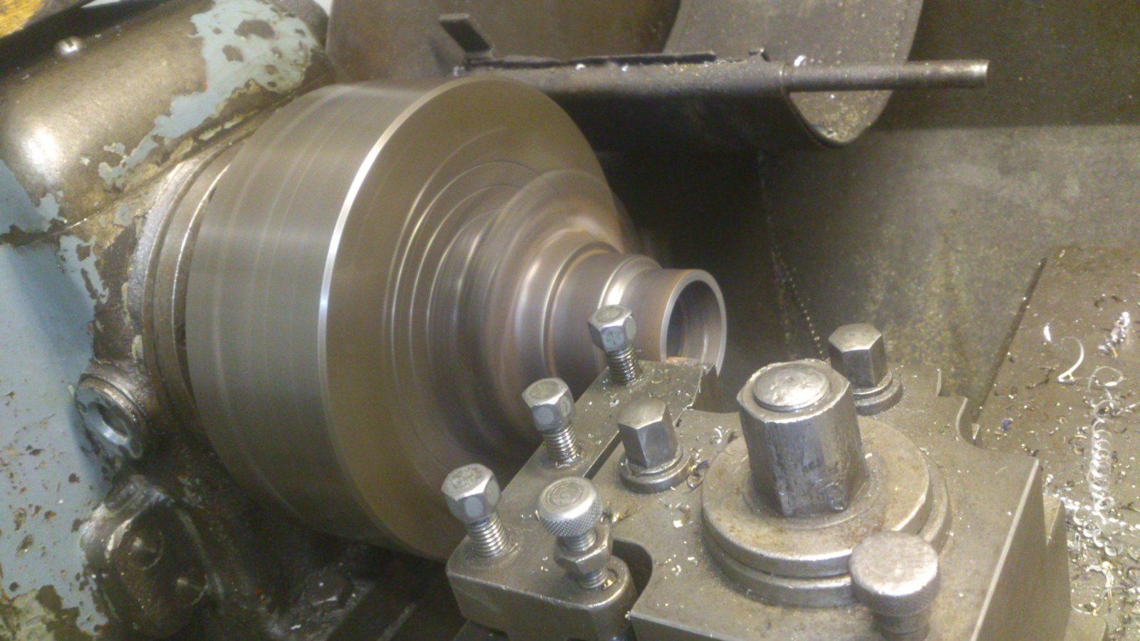

    Machined the last piece, now, I need to replace the old endings. DSC_3142.jpg

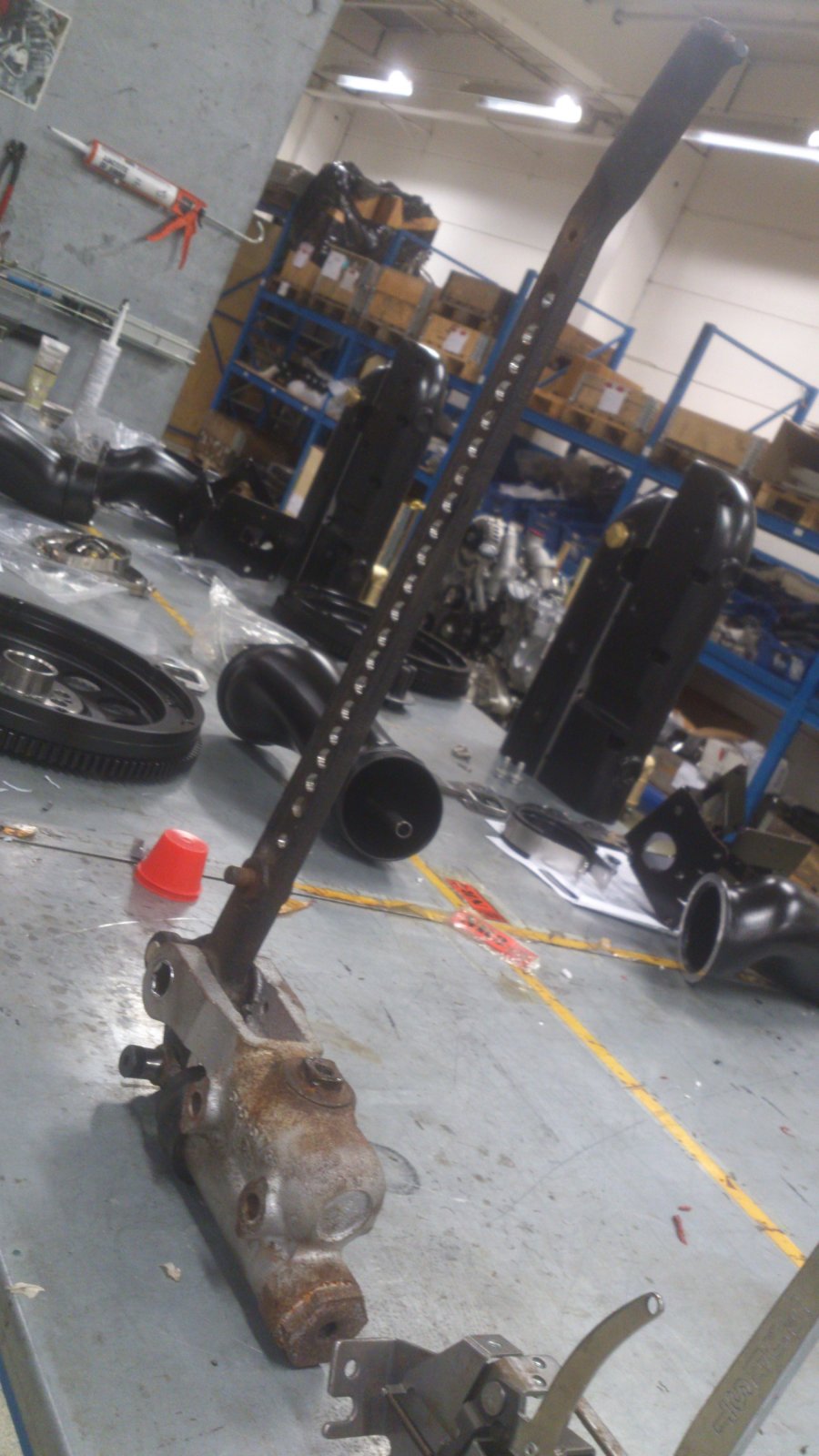

    I've been workin a little on the brakehandle, It would be nice in Chrome :) DSC_3205.jpg

  11. loudbang
    Posts: 40,346
    Wow you better make sure the brake handle has some over travel stops built in. With it that long as they say you could move the earth or bend your brackets or master cylinder in a hard pull panic stop.

    Good point there, maybe build a bracket, so I can adjust the bottom end...
    And I think I need a hard spring to return the brake handle, so it keeps it at place when not braking.

    Does not need "limiters or stops" and as long as the pushrod remains with the MS and there is a return spring inside the bore you are fine.There isnt a Fuel car out there that has any of those.
    there are 2 things that brakes do on the back of a dragster, One is to hold you on the line for the start and the other is to keep you from running into the back of the tow vehical on the way up to the line. If you grab the brake hard at the end of the run the car will start bouncing and you will not slow down.
    TheTumbleweeds and Countn'Carbs like this.

    Using info from the Mark Williams web site, that setup looks like the ratio is in the ballpark for a hand-brake on a dragster ...
    http://www.markwilliams.com/braketech.aspx
    1. Their recommended pressure target is 1200 PSI.
    2. Their recommended force for a hand brake lever is 75-100 lbs
    3. Google says that the 55-59 Chevy truck master cylinder is 1 1/8 bore
    So using the pedal ratio calculator on the above link it says the ratio required to get 1200 psi from 100 lbs force with that master cylinder is 11.88 to 1.
    Roughly scaling the pedal ratio from the side-on picture above, I got 11 to 1 so it is pretty much on the money.

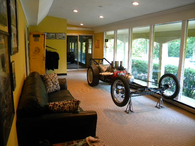

    Something like these (not my Picture, loan from a thread on HAMB)
