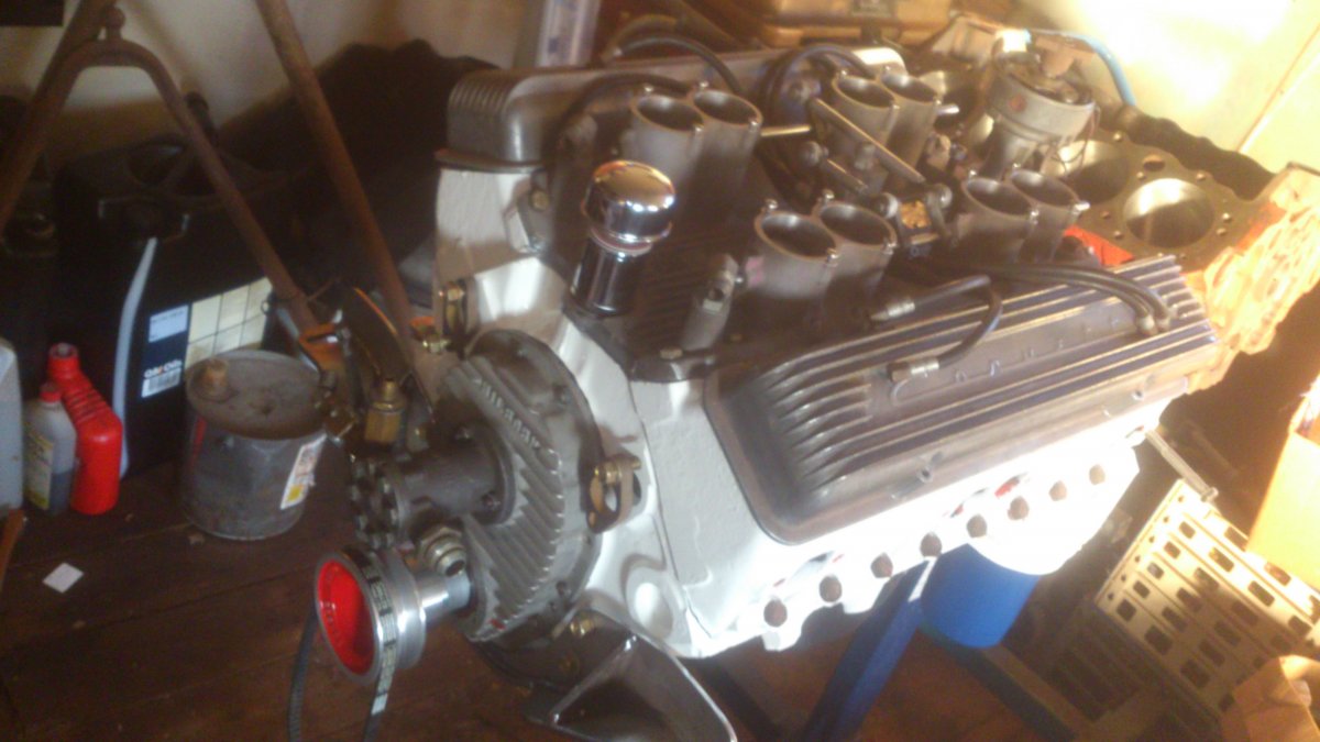

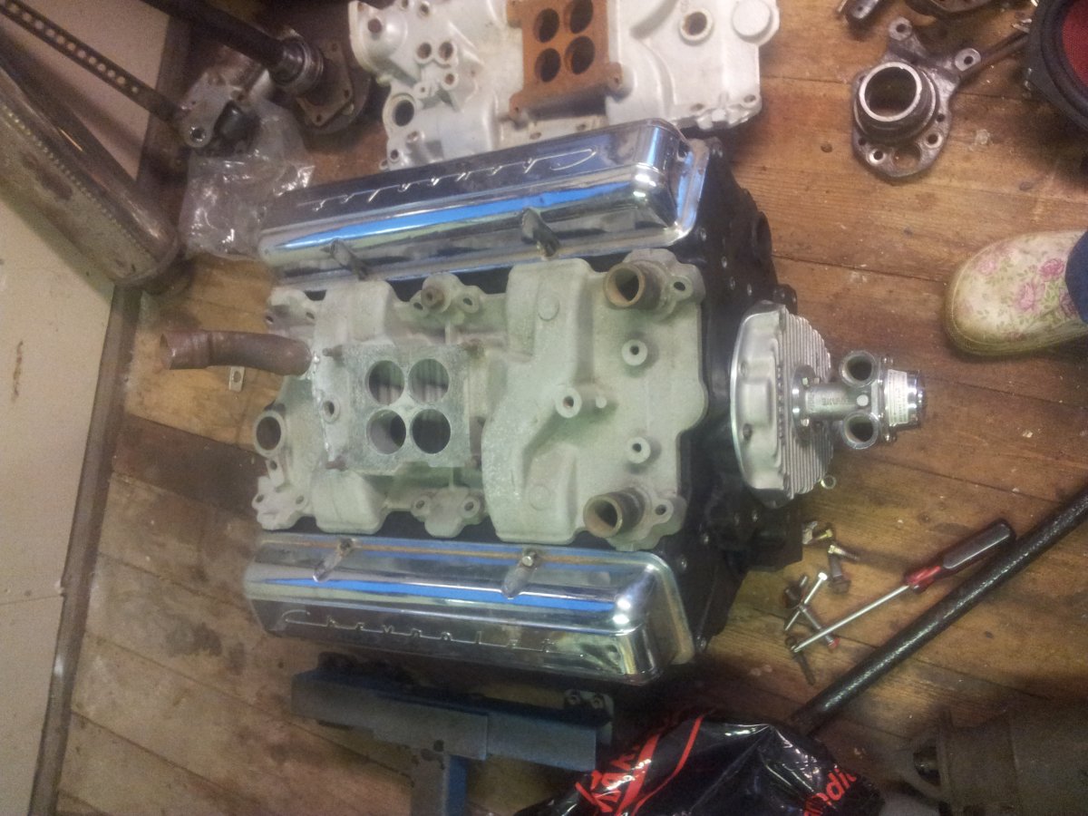

    A great moment for me, to finally get this Hilborn fuel pump, to fill up that hole in the timingcover ;-) Screenshot_2015-08-17-20-25-04.png DSC_3923.jpg

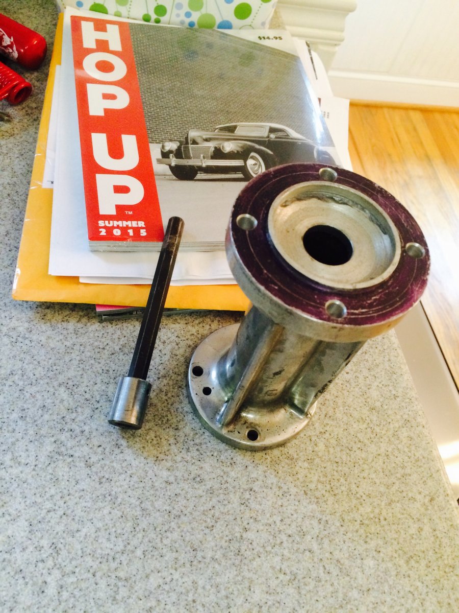

    Hey wow!! I Love that piece! Would fit nice on my Engine!
    sorry for a late reply, I have just changed working place after 13 years.
    Maybe you pm me about a deal?
    many thanks

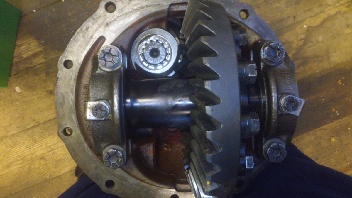

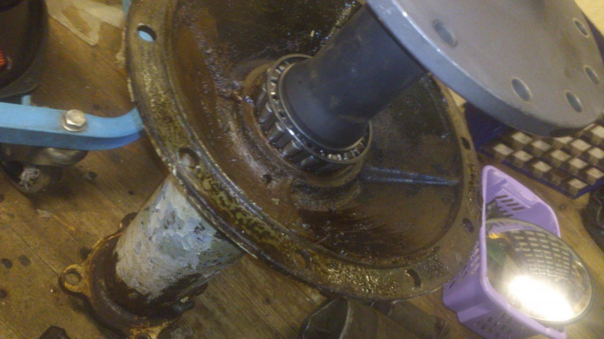

    DSC_4352.jpg and...... It didnt fit....
    Bearings are too big, and the housing is too small....... Is there any bigger housing for this spool?

  15. dusterdave173
    Joined: Dec 30, 2010
    Posts: 226
    dusterdave173
    If you run roller cam get all that extension/fuel pump on-- Then check end play and set it
    all those items can effect end play--
    Lookin Good!
  16. flatheadmurre
    Joined: May 23, 2014
    Posts: 41
    flatheadmurre
    I love the build and just hate that rear axle.
    I got a quickchange with a full set of gearing if youre interested.
    Still have to be narrowed to fit.

  18. dreracecar
    Joined: Aug 27, 2009
    Posts: 3,476
    dreracecar
    from so-cal
    8 3/4 Chry over the Ford 9 , Smaller and cheaper to build and they look like the early 49 Olds

  23. ckh
    Joined: Jul 1, 2013
    Posts: 90
    ckh
    In the 60's Halibrand made steel spools for the V-8 quickchange. One of these would work in your housing depending on what year the housing was made. You may be able to find one on ebay or? It's possible Winters makes spools also.
  24. TheTumbleweeds
    Joined: Jul 29, 2010
    Posts: 539
    TheTumbleweeds
    from Sweden
    I will contact winters and see if they can help me out, maybe I need different housing and bells ( a new axle...)
    Or maybe they have the bearing "seats" for the bells, so I can machine my bells and fit slightly bigger seats for my bearings.

  27. ckh
    Joined: Jul 1, 2013
    Posts: 90
    ckh
    The Champ is the larger size of the Halibrand quick change center sections. That is why the spool you have won't work. ****uming the banjo housing you have is 1940-1948, what you need is a spool for a V-8
    Halibrand quick change. Then the center of the ring gear must be machined (center bored out) so that it can bolt to the spool. Winters makes a V-8 quick change also, so if they make a spool for it, that should work too.
    TheTumbleweeds likes this.
