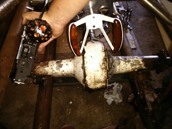

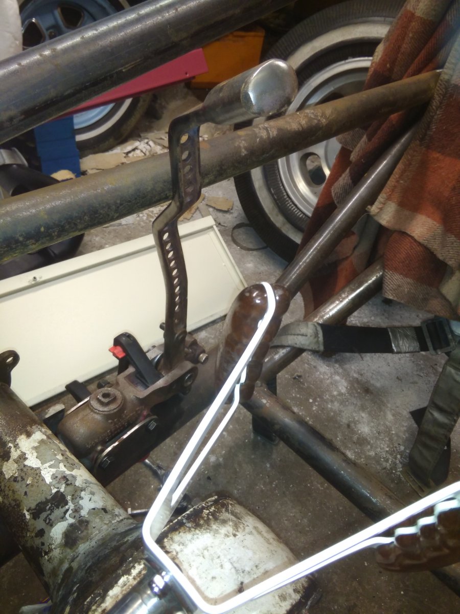

    After sittin in that rail for hours, I finaly figered out where to put the shifter. Its going to be placed on the left Side, and lean towards the ****erfly MG_20180822_125402.jpg lean towards the ****erfly MG_20180822_220453.jpg made a bracket to hold shifter MG_20180827_165014.jpg and made a weld on bracket for the rail MG_20180827_183619.jpg and here it is, need a friend to weld when I sit in right position. Same with brakehandle and foot pedals

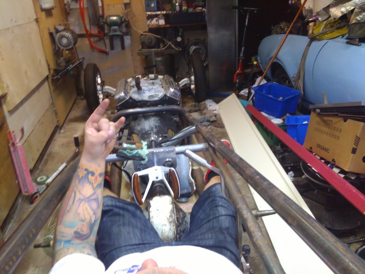

    Think the brakehandle turned out cool, just Chrome plate it IMG_20180912_200435.jpg made the pedals rough now, make those little cooler, soonest I made the brackets for them IMG_20180912_201153.jpg I need to drive this nooow! IMG_20180912_201328.jpg feels good and strange to see the build start look like something IMG_20180912_202752.jpg

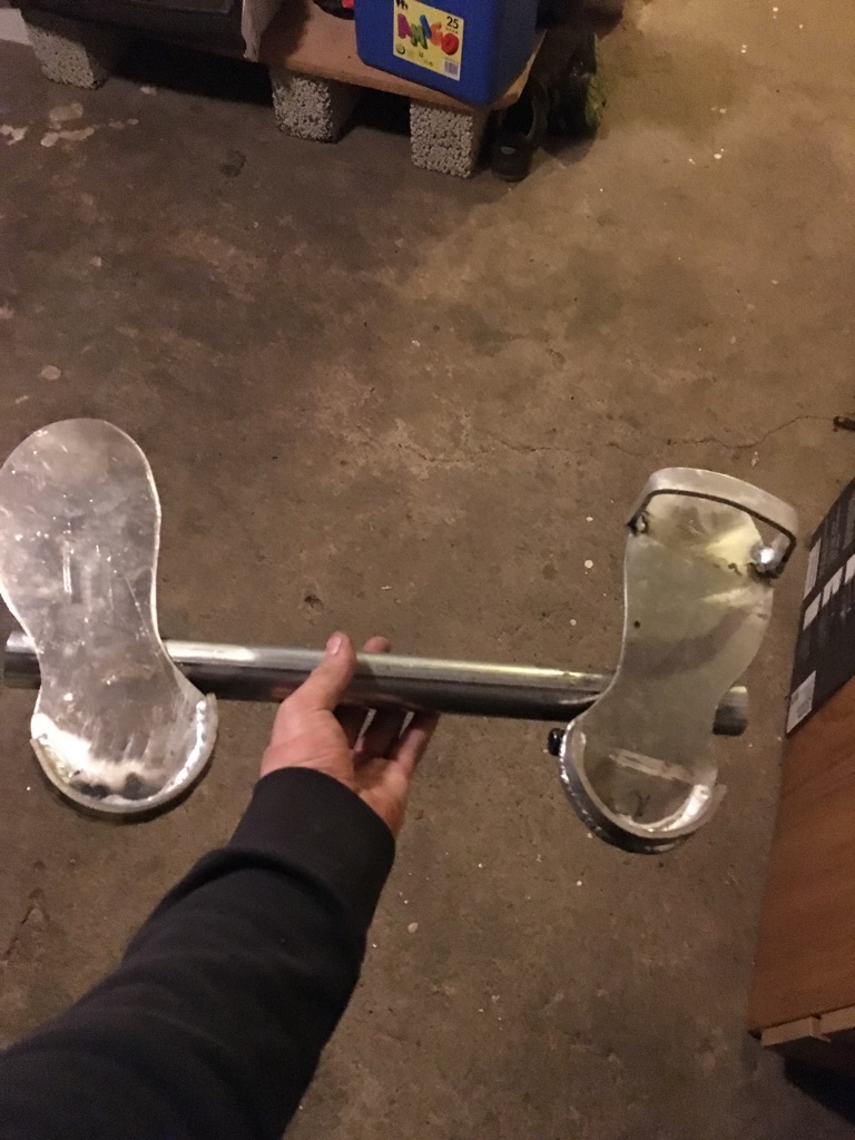

    Im building a tube with the padals installed. Then I can weld the tube in the rail IMG_20180918_163538.jpg then I use the tube between pedals, to make a support for the tail in gearbox.
    IMG_20180918_163547.jpg just need to check the angle on foot, to weld the pieces correct for me.
    Hey, by the way, I have seen transbrake with a pedal, can you teach me on this. It would be fun having that on the left foot , if it works?
  9. dreracecar
    Joined: Aug 27, 2009
    Posts: 3,476
    dreracecar
    from so-cal
    like this

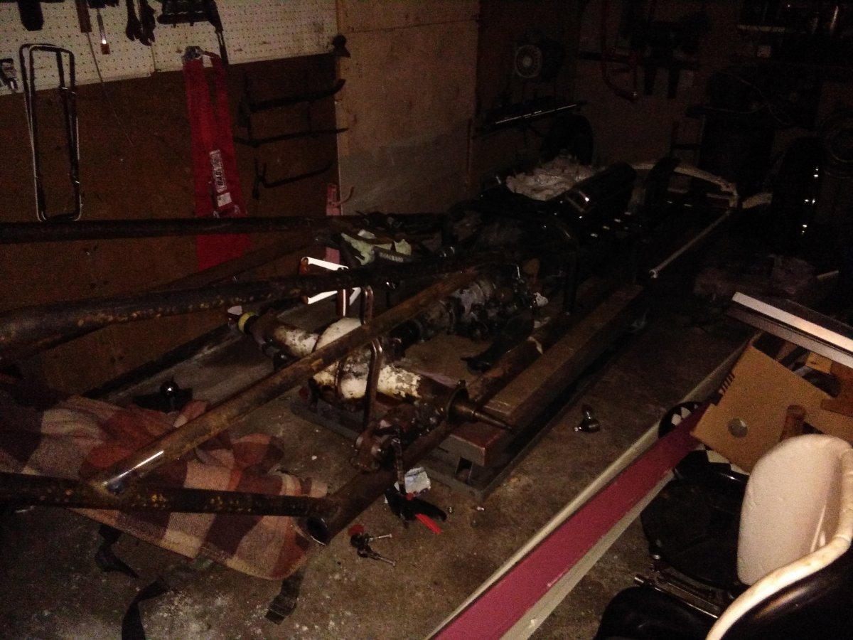

    Im going out to the workshop tonight and check them out on the build. But some pics for now IMG_20181001_120028.jpg IMG_20181001_120037.jpg IMG_20181001_120141.jpg

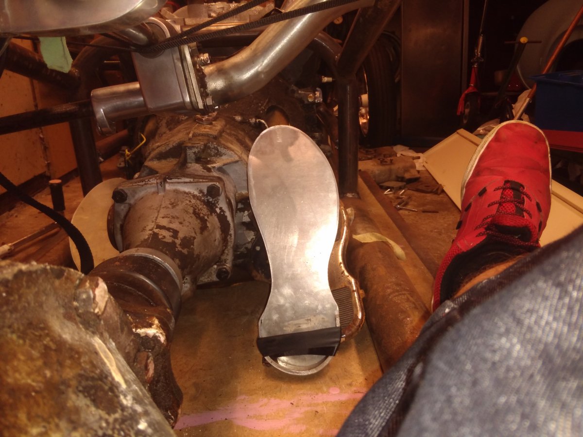

    Oh yeah, now I have been testing the pedals IMG_20181001_201149.jpg just gonna fit that tube between main rail IMG_20181001_200203.jpg hey, finaly got a loudpedal for my slingshot ! Feels good IMG_20181001_200104.jpg
