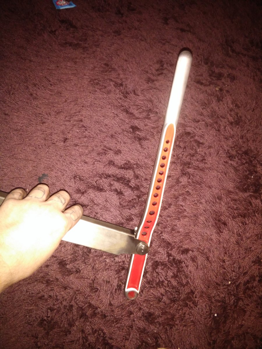

    Made two tubes today, to complete the ch***i, and the right tube, will I fit the chute handle. IMG_20181030_160818.jpg

    Okay, this morning I tried this out in the ****pit, but No, aint gonna work..
    I couldnt reach it easy. So , a new location is set, and new brackets are almost done. I Guess why other feds have that pull ring on shoulder, or near shoulder..

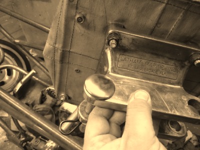

    IMG_20181022_090617.jpg I found this old bus stop ****on many years ago, I think its from the early 60's
    How ever, its cast aluminium, and shaped for mount on a tube. IMG_20181102_124659.jpg So this is now a start ****on instead! Of course I will polish it as chrome :) IMG_20181102_173718.jpg tomorow Ill check it out , see if the starter ****on will look good and if the new chute handle bracket does the work.
    EVL401, FinnishFireball and saltflats like this.

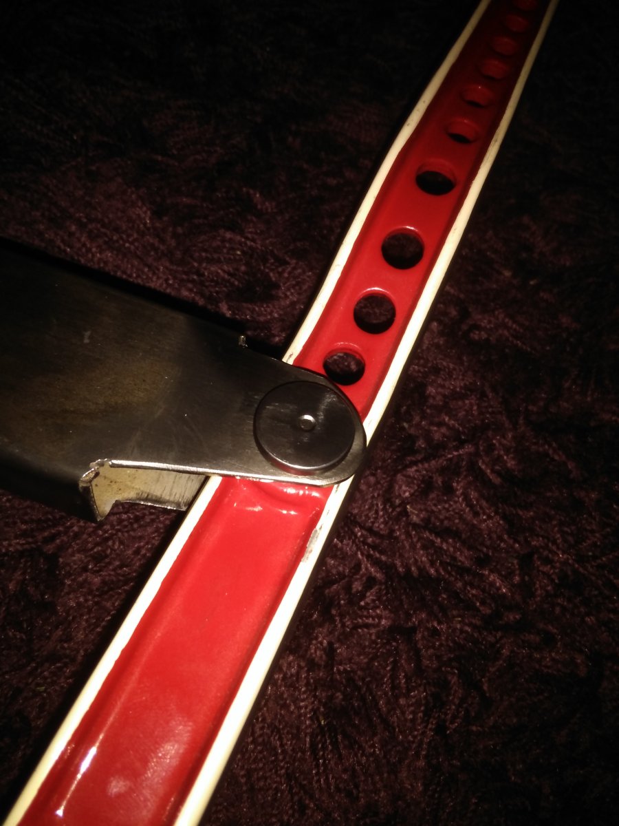

    IMG_20181103_162144.jpg Ill think this will work, the chute handle goes on the inside of the brakehandle. IMG_20181103_162121.jpg feels like it is easy to reach , and use. IMG_20181103_162511.jpg okey, so now the ****pit starting feel complete, with shifter to left, pedals and steering of course in the middle, then the brakehandles to right. Now I need to use the welder, to fit those brackets.
    saltflats likes this.
