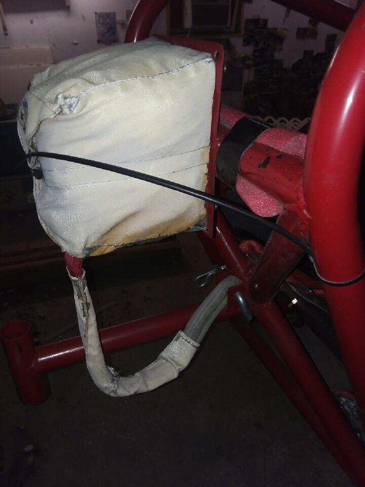

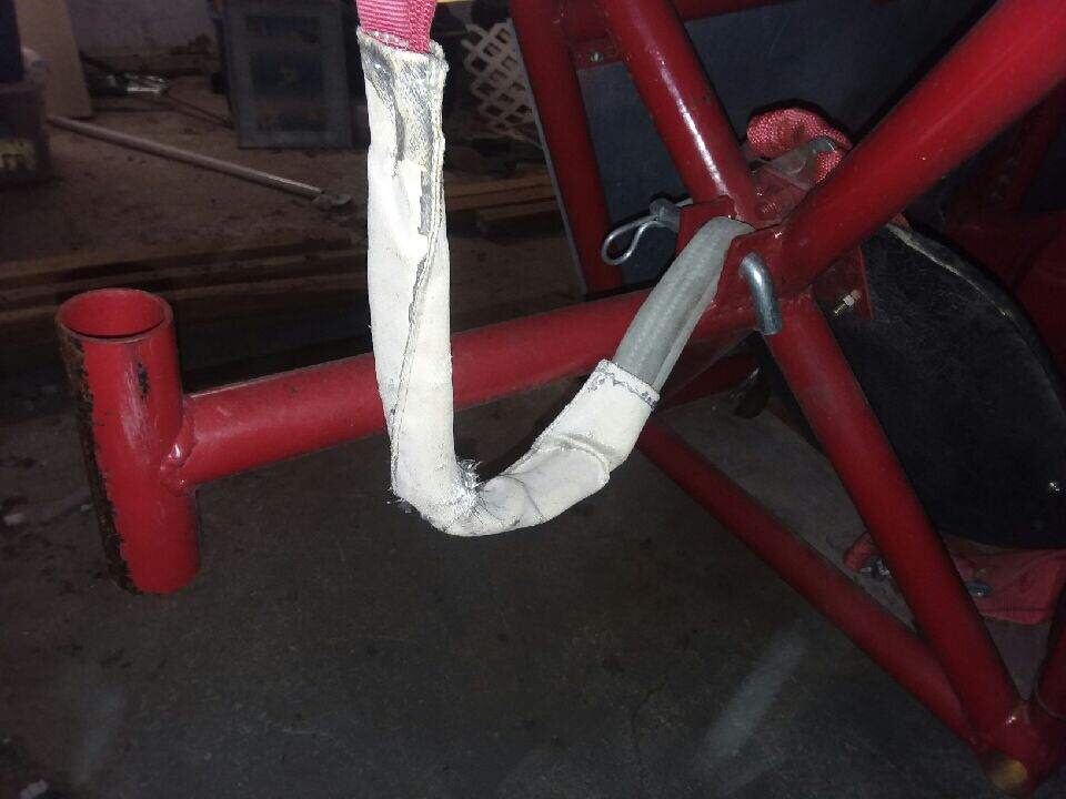

    IMG_20181204_064000.jpg the chute connecting needs to fit the rail. So I worked on a bracket
    IMG_20181205_165524.jpg the bracket goes round the tube, bolted with 4 bolts in tube. Then a M20 Bolt to hold the chute .
    IMG_20181205_213621.jpg I think this will work.

    Looks healthy enough.

    I just use a hitch pin instead of the big bolt as it is real easy to remove the chute but my brackets are also welded to my push bar

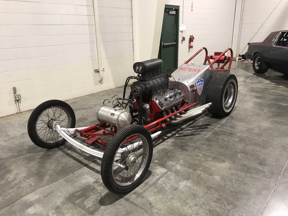

    Thanks I sometimes tend to over engineer things a bit but sometimes it pays off lol. It does ride a trailer but not at the dragstrip it is run hard here it is at a car show just before thanksgiving oh and it's a stick shift as well

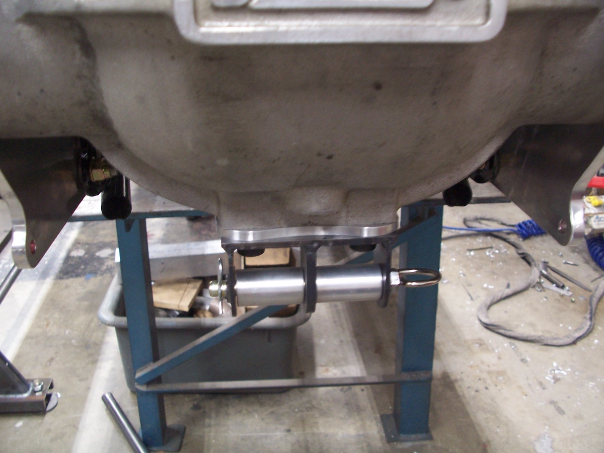

    Strange Engr 9" Top-loader installed in a F/C ch***is. The plate between the housing and Chute mount is also the lower anti rotation support that ties to frame. This insures that the frame picks up the load of the chute hit and not just the housing 100_2786.JPG
