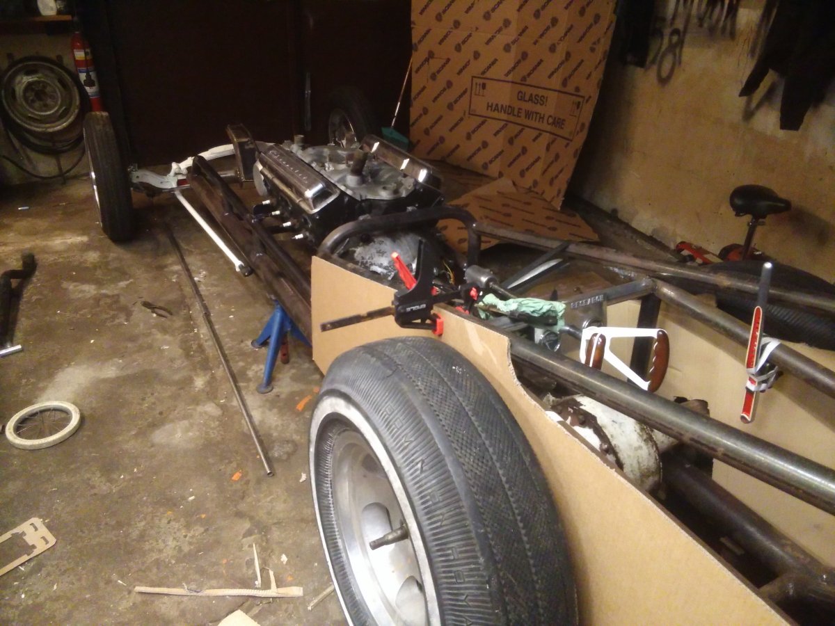

    Did take a look at the body issue, so I made a side with cardboard. I will do all the pieces, then copy in alunalumi IMG_20190109_112841.jpg

    Okay, a New model is made, so this is going to be two , in aluminium .
    Just cowl/hood needs to be made. IMG_20190115_062710.jpg any ideas for mounting the aluminium Body?
