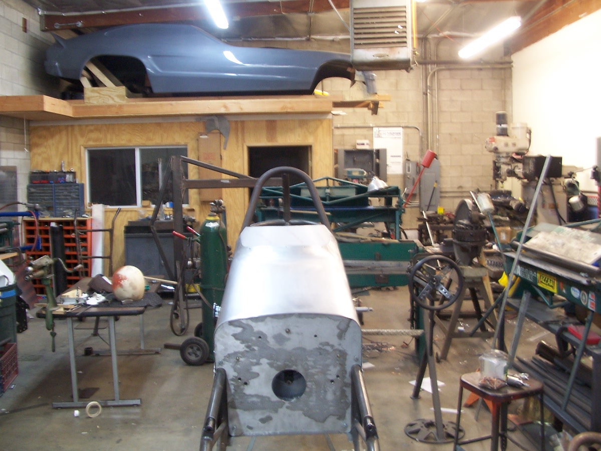

    Would it be better to mount the rear end with double shear brackets?
  7. dreracecar
    Joined: Aug 27, 2009
    Posts: 3,476
    dreracecar
    from so-cal
    NHRA/SFI spec's call for either double 1/8" plates sandwiching the 1/4" rear end plate or a single 3/16" 100_2825.JPG

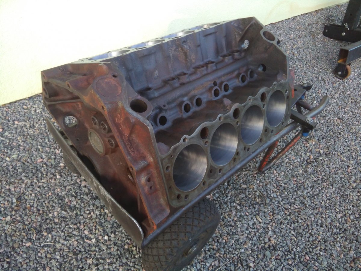

    Att least I have picked up my 1955 265 block, it has been bored out for 283 ,
    #7 cyl needen a liner (?) , So that is ready now to rock n roll! This is for some other build ;-) IMG_20190308_170304.jpg

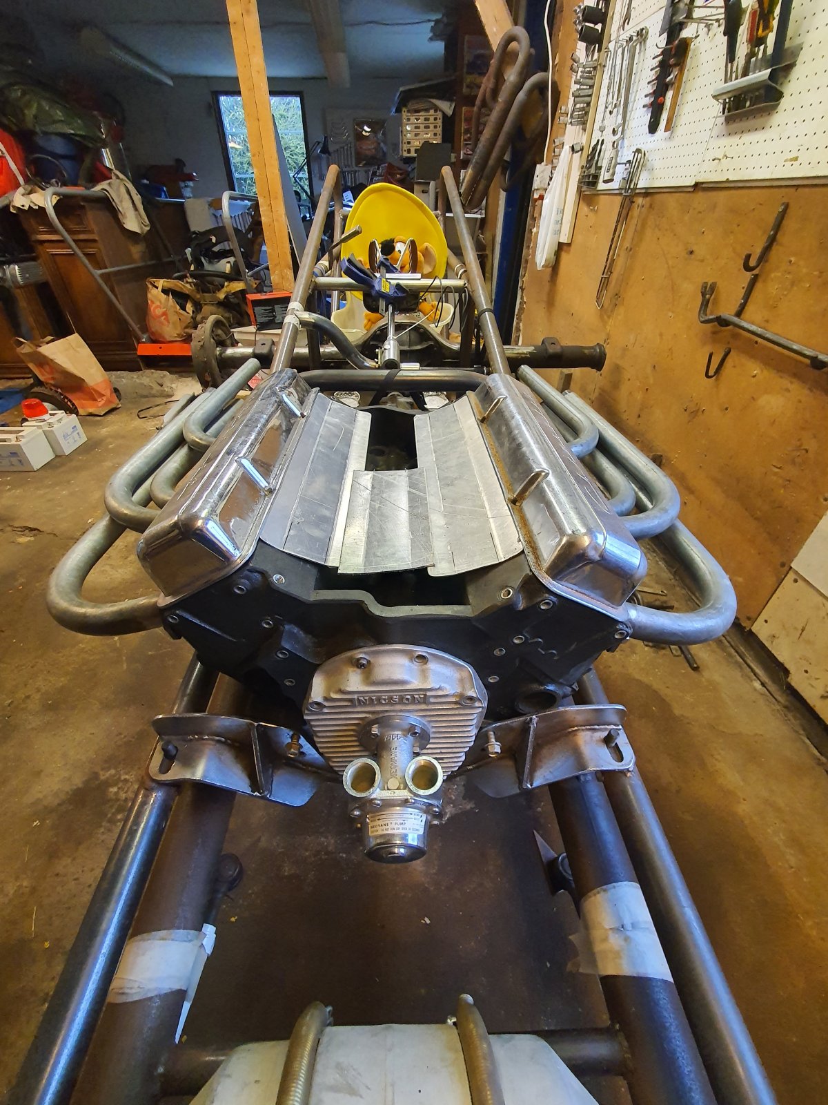

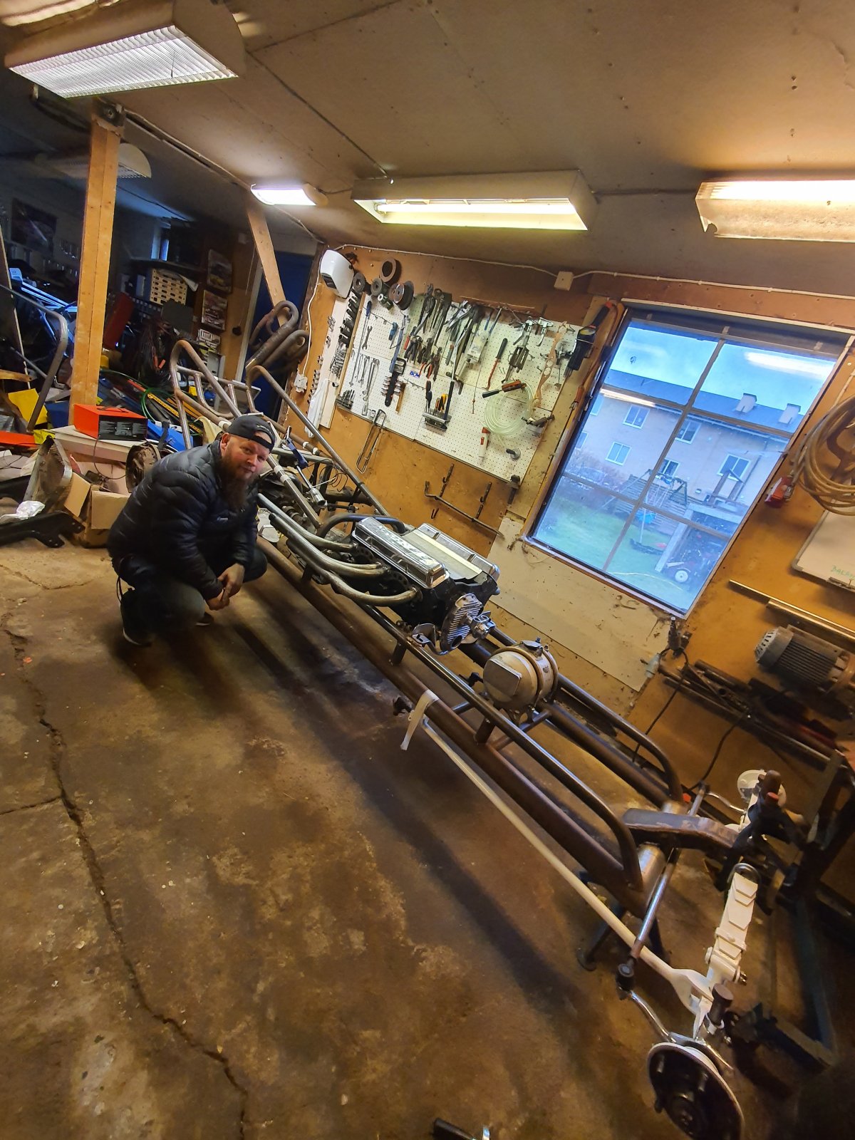

    Been a looooong time! I live much on Instagram now, since I had alot of trouble with this site..
    @mr_m0t0r
    IMG_20200425_185056_478.jpg IMG_20200501_155057_945.jpg IMG_20200503_153557_717.jpg

    Workin on the exhaust , one side ready, one to go IMG_20210920_184216_008.jpg And alot of hotroding of course IMG_20210918_193036_711.jpg
