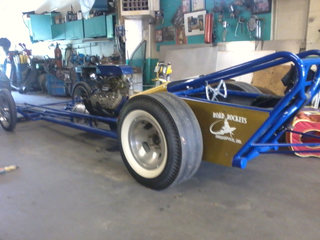

    The learning curve is steep. I had my Dragmaster out on the track again last night and am addressing the issues found. Hope to be ready to make a real p*** or two the HAMB drags.

    Drove the 4 hours down to MoKan for last night's "fun runs". Finally resolved an issue with the shifter cable adjustment. Still having trouble throwing blower belts. Going to replace my homemade idler pulley with a store bought one. Then there is the issue of her puking oil. I'm afraid I have a hurt cylinder. I'll know later tonight when I do a leakdown. :-/

    Kerry, by looking at the pics you are running a breather in front on the VC. My opinion is that is the worst place (second only to on the back) for it. Early Chry. heads are very very bad at oil return and when you decelerate and hit the Chutes a good quart and a half is still in the heads slaming forward and out the breathers. Get another set of covers and install either 2 breathers on top each side or a burndown breather on top and run a hose to a puke tank.

    New valve covers aren't in the budget but I am going to have a different configuration on the breathers for the HAMB drags. I like the look of the breathers but the puke tank makes more sense. Still waffling on that decision, or at least how to implement it. I did find a cylinder that had a lot more leakdown than it should have. Read about it here.
