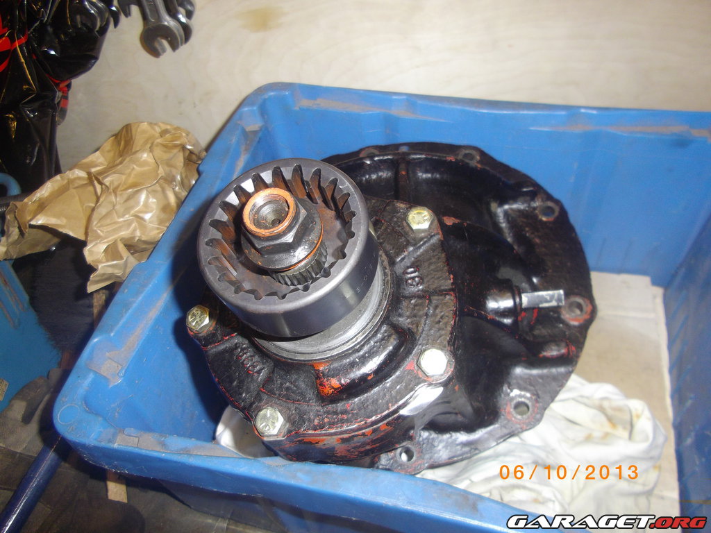

    Ordered 3 couplers today on MW!
    One for powerglide, one for 9" , and one for the old banjo axle.
    hope they show up next week.

    To the left; Ford 9" 28spline
    Middle; Quick Change 10Spline
    To the right; Powerglide 27Spline

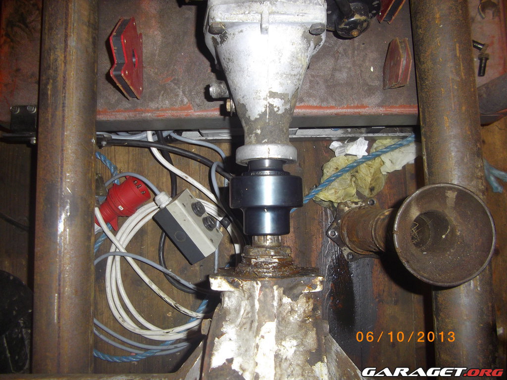

    Here is Powerglide and old narrowed banjo connected! The couplings fits perfect!! And also ford the 9"![​IMG]

  13. you're going to have to shim the coupler in the 9" to get the proper preload on the pinion
  14. TheTumbleweeds
    Joined: Jul 29, 2010
    Posts: 539
    TheTumbleweeds
    from Sweden
    Yeah, I need to shims it correctly torque.
    I think there is a Breakshim to tighten it, and it has the right preload on the pinion?

  16. Kenneth S
    Joined: Dec 15, 2007
    Posts: 1,526
    Kenneth S
    For racing it's better to shim the preload than using a crush sleeve (breakshim), it will take a few tries to get the preload right, but it will stay right.
  17. dreracecar
    Joined: Aug 27, 2009
    Posts: 3,476
    dreracecar
    from so-cal
    If that is a stock third member case you may want to consider changing it to an aftermarket nodular iron one, this is a frequent occurence with the stockers.

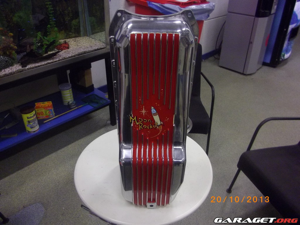

    New updates, my oilpan is ready, and also my cal custom valvecovers.
    Like it?
    Nice and clean stuff ;)

  25. 61cad
    Joined: Oct 28, 2005
    Posts: 4,180
    61cad
    You might consider adding an anti-rotation bracket. Have one in our dragster made of old well casing that covers the coupler and rear tailshaft of the powerglide.
  26. Kerry
    Joined: May 16, 2001
    Posts: 5,155
    Kerry
    X2 on the anti rotation plate. Here's the one in my Dragmaster.
  27. saltflats
    Joined: Aug 14, 2007
    Posts: 13,639
    saltflats
    from Missouri
    Kerry do you think a full circle one would be better ?
  28. Kerry
    Posts: 5,155
    Kerry
    Not really. It would take something fierce to shear the three bolts.
  29. saltflats
    Posts: 13,639
    saltflats
    from Missouri
    I guess thats true. I think I have a tendeny to over build stuff not sure why I guess trying to use up all the s**** laying around.
  30. 61cad
    Posts: 4,180
    61cad
    Our a half circle and cover up the coupler.... Having that coupler spinning open at 6,000 RPM, right between the legs...
