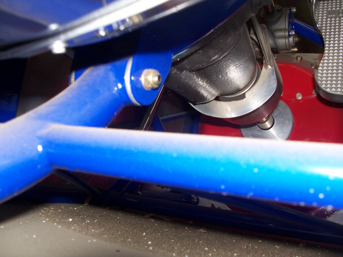

    I am going with a mopar 8 3/4 rear. Does the it haft to fasten to the 3rd member?
  2. 61cad
    Joined: Oct 28, 2005
    Posts: 4,179
    61cad
    Yep... We are running an 8 3/4... Used the two bolt holes in top of the 3rd member to attach the plate and ran a bar like Kerry to tie down the plate the ch***is on the bottom.. I can't take pictures with the belly pan on... Hard to see the detail.

  4. dreracecar
    Joined: Aug 27, 2009
    Posts: 3,476
    dreracecar
    from so-cal
    No, Couple of tabs welded to the bottom of the housing to a mount welded to the tube/tubes under the housing.

  7. 61cad
    Posts: 4,179
    61cad
    If you look at my profile, go to my albums, Ch***is Research and lot at photo 36 on page two, you can see a far shot of what we have.
    Works as the anti-rotation and a drive shaft hoop, around the coupler.

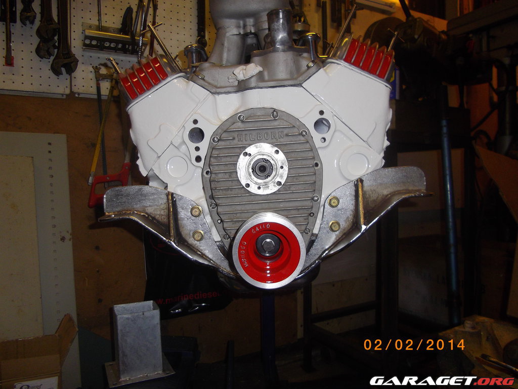

    The Hilborn timing cover is mounted, just need to find a fuelpump for that...[​IMG]
    Here is the oilpickup measured in, fitted against the pan.
    Some new fresh gaskets;
    And the results coming here ;) Looks good I think

    Heads mounted , and bottom of the intake ;)[​IMG]
    And here is the cal custom test mounted.
    I need to mount the pushrods first ;)

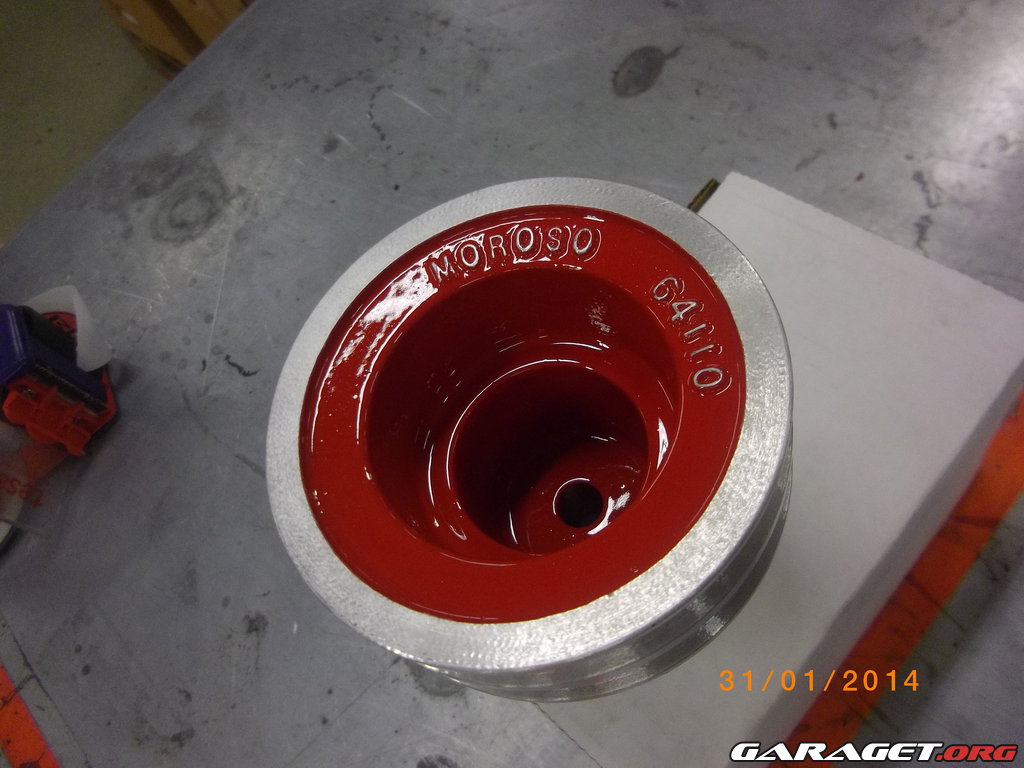

    Then we have new painted Moroso solid wheel :) (Paintjobs on dragster, done by a near friend Per Mattsson)
    Installed with new bolt and washers.
    And how it looks now! A little update, but its alive, and coming more soon!
