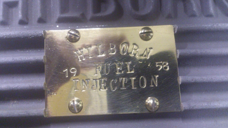

    DSC_1789.jpg I covered the holes in the intake and the milled surface with a br*** plate.

    See it better this way :rolleyes:

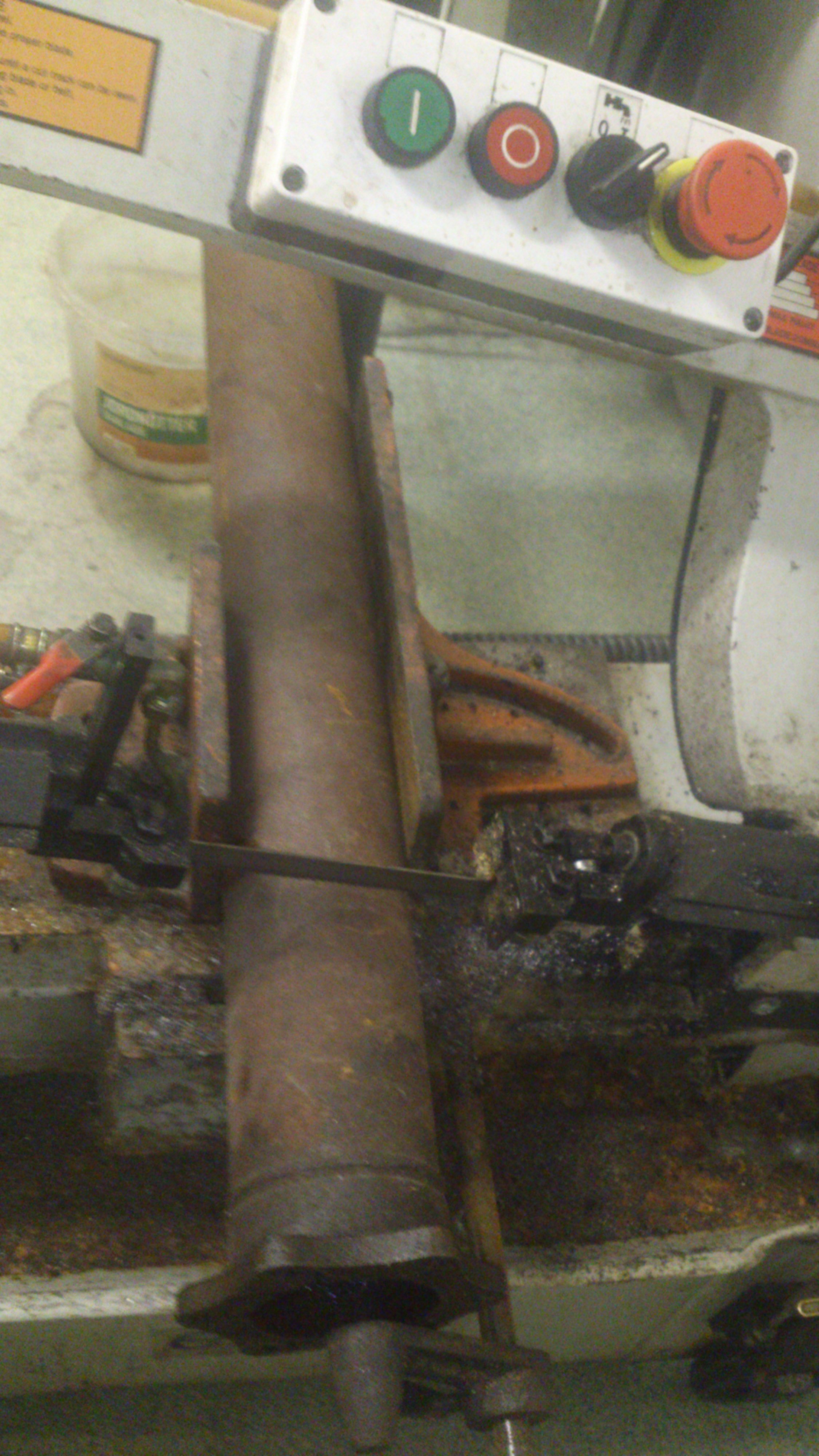

    DSC_2455.jpg needed to build a sealing and a cover for the rotating couplers. Found a torquetube in the garage , a donater .
    DSC_2458.jpg I saw one HAMBers thread, building a opendrive shaft kit, going for same idea,
    So here we go

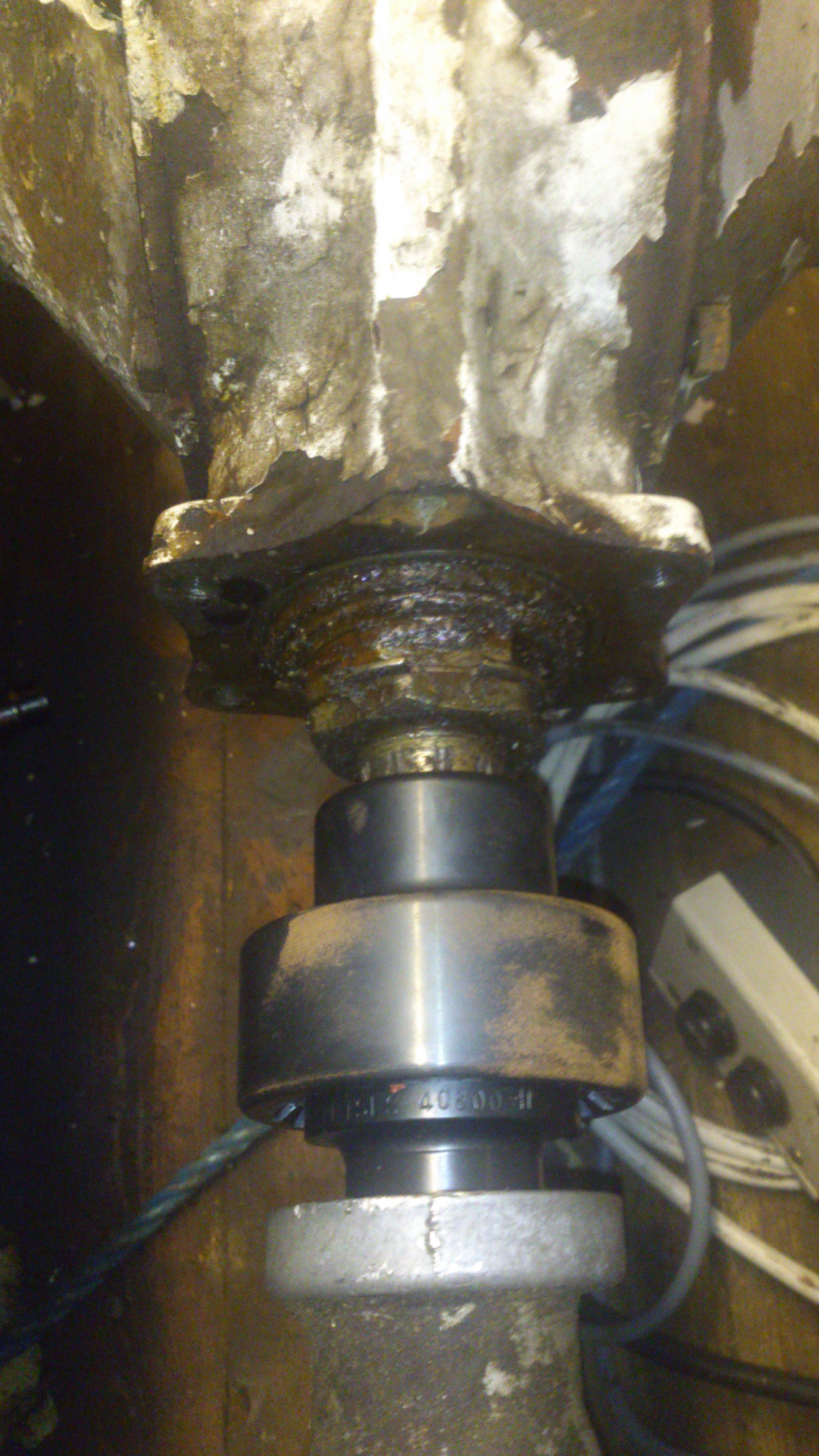

    DSC_2514.jpg now I need some Tech advice... The coupler witch goes Into powerglide is "floating" , but on the pinion for Old Ford banjo axle, there is a hole thrue axle.

    Not nes***ary, only reason other couples are locked onto the shaft is because they are part of the pinion retention. Just make a collor to fit between the jam nuts and the coupler so that the coupler does not ride on the spline ramp. Also possistion the coupler so that it covers the thru hole in the middle/front of the coupler and not towards the rear
  25. TheTumbleweeds
    Joined: Jul 29, 2010
    Posts: 539
    TheTumbleweeds
    from Sweden
    This is good, beacuse, I dont realy want to drill in the coupler. But I need to make that collor you mentioned, so it can't travel the spline ramp. Thanks for those inputs dreracecar ,

    Should I apply some grease in between the couplers? So its not "dry" between splines in coupler?
  27. saltflats
    Joined: Aug 14, 2007
    Posts: 13,586
    saltflats
    from Missouri
    Yes unless it teflon coated.
  28. dreracecar
    Joined: Aug 27, 2009
    Posts: 3,476
    dreracecar
    from so-cal
    Since there is load/presure involved --I would use Anti-seize instead of grease
