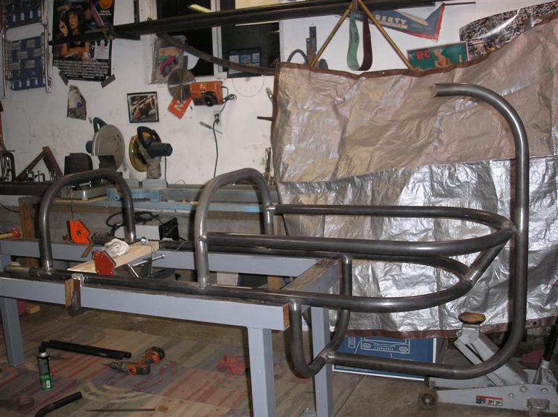

  3. I am looking and building . This is #3 car from "pipe"
    Don

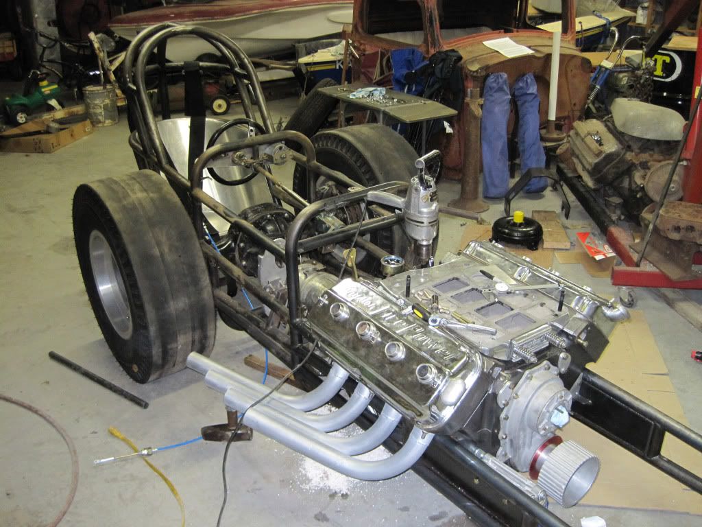

  6. I see an engine being primed^^^^^^^^^^^^^!

  9. So as long as you don't E.T. 9.99, you are golden? Hell, I bet you could run tens with a stock small block with a healthy cam added.

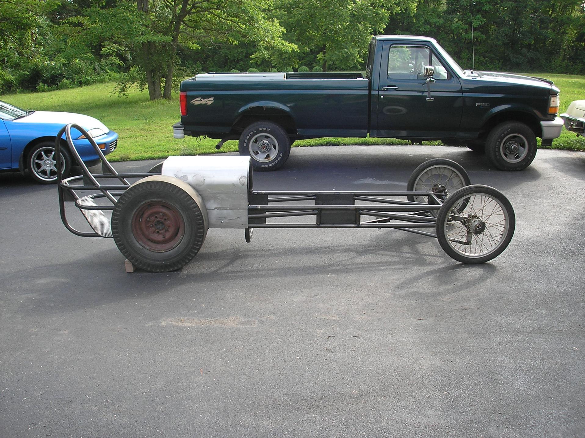

    What do you use for a ride height in the driver/rear axle area?
    Is there any kind of scrub line consideration?
  16. KING CHASSIS
    Joined: Aug 28, 2005
    Posts: 1,864
    KING CHASSIS
    Under the rear axle is about 6". The bar under the seat is about 4 1/2" off the ground. As to scrub line. The oil pan is under the frame rail. So a wheel comes off the pan is on the ground. All the steering is way out of the way of the ground.
