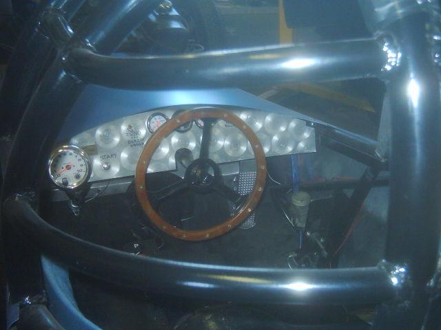

    Yeah Lippy, I'm back on the straight and narrow and making progress. :) I thought I'd work toword firing the hemi on a 4bbl today but instead made some significant changes to the ****pit. I'm a lot happier with it now. No guages in the ****pit, steering wheel moved, shifter in place, and all is fine.

    Tank, good on ya! Robert, You old dog, I thought you were joking about building another car!:D Kerry, remember it's a dragster. You need ONE guage and thats oil pressure. You don't have time to read a tach or worry about silly temp guages and stuff. Trust me, you'll see. Run it dry on alky. These cars need one wire, thats the kill for the mag.:p Did you get your cables? Lippy

  24. Kerry
    Joined: May 16, 2001
    Posts: 5,155
    Kerry
    I'm doing my best to keep my car low tech. I keep wanting to add sysetms and make it more complicated than it has to be.
