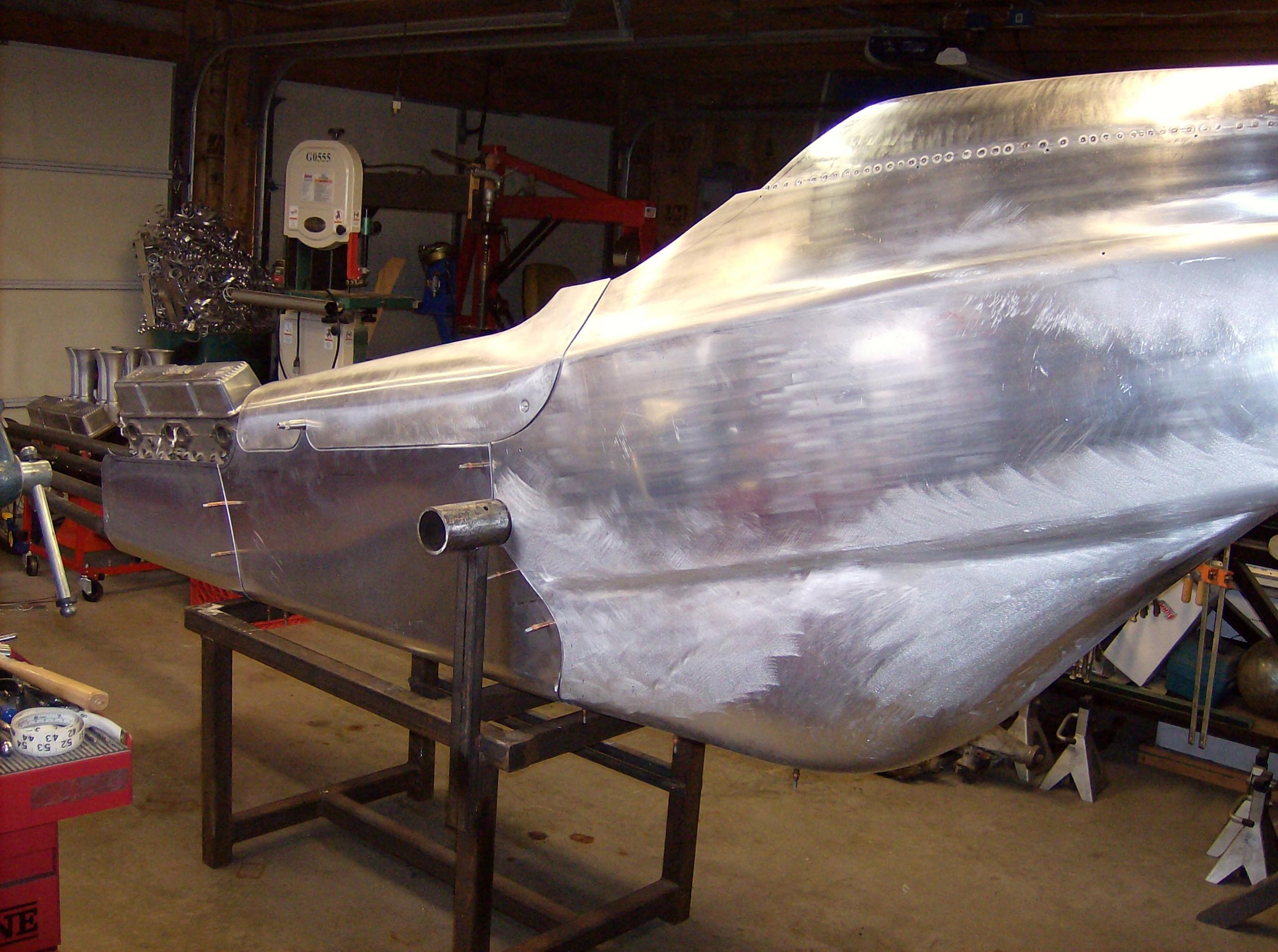

    Thanks for coming over and checking out the Brissette Grenade. It was good to see you again, it was like old Nitro war buddies meeting again. I forgot to tell you that the first body is made from .062 and the second body was .040 which is on the Fueler now. The .062 will hold it's shape better and both are 3003-H14 material. Now that you have your cookie, get to work ! Mad Max is a good kid.....teach him well.

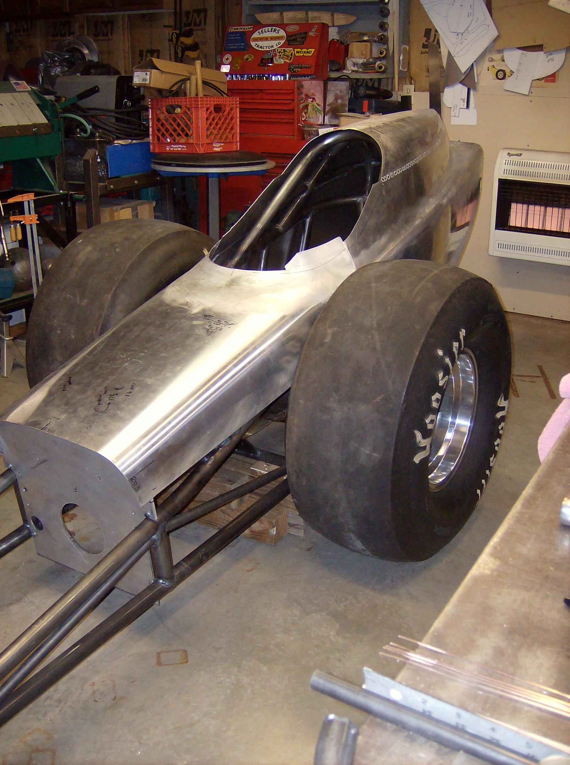

    I feel you can have the look of the 60's combined with the safety standards of today. I had my ch***is certified to NHRA 7.50 last week, and will have a old style body to hide the cage, fire bottles, etc. I feel for the best results you have to build a ch***is around a body style. Brian Fox did a great job in working with me on building what I needed...Randy

    I like the lines on the tail section, like Creitz & Goleman. Like Pat Foster said " If it looks right, it is right ". Very nice work Brian. A nice home for a Blown Nitro 392

    Thanks Roger, but the part I did you cant see. Thrillbilly did the aluminum body himself.

    He did a good forming job, but has to form over a good starting point, the ch***is. I haven't seen Dean's car you built yet up close and is very happy with it.

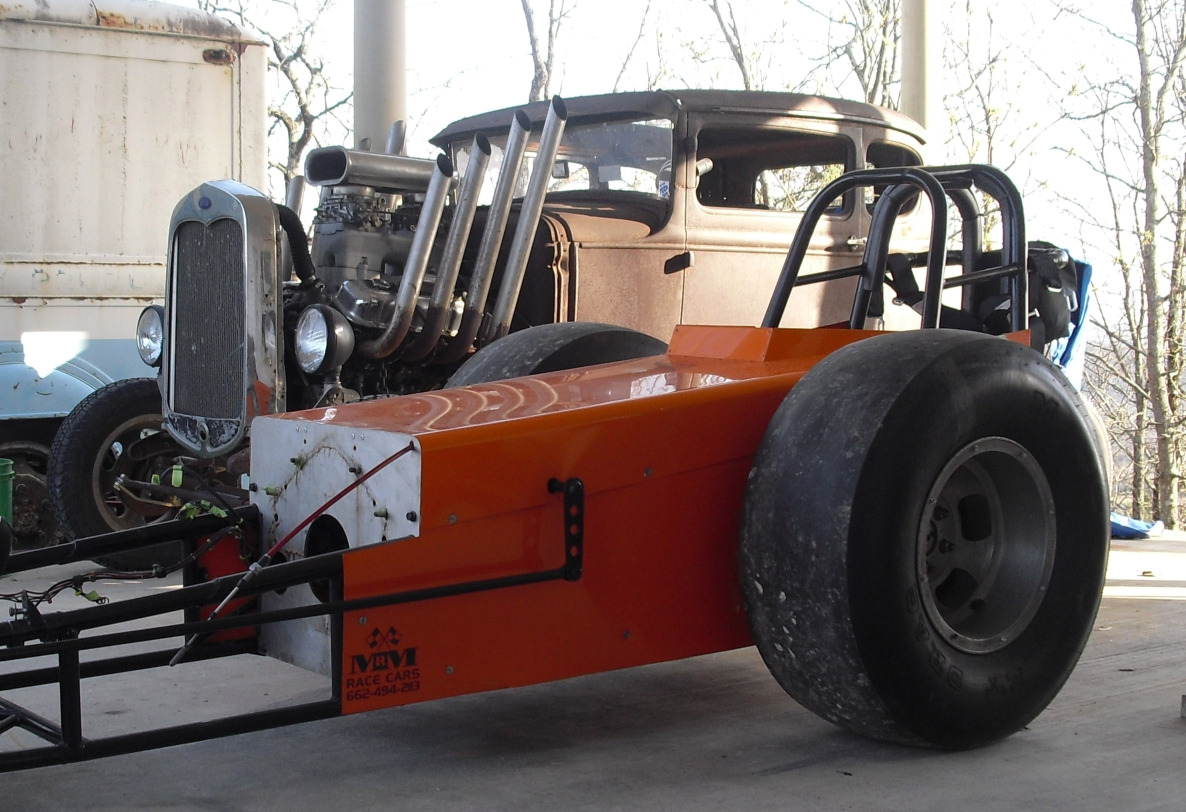

    ORGANGRINDER
    ok...i've been waitin' to say this for 40 yrs....i have a front engine dragster! i just bought this from a fellow hamber last week. i can't even tell you how much i felt like a kid again as i was picking it up. i was 50 miles from gettin to where it was...my gps said 30 something miles and turn right and go 26 miles. from that point on i would have been very embarr***ed if anyone had been with me and seen the way i was acting. man i was sooo pumped! i felt like the day i did when i was 16 and my dad was taking me across town to pick up my '67 ss chevelle. i can't believe i didn't pee all over myself....but i didn't. anyway i'm very excited about this car. wasn't really sure if i'd ever be able to get one. it's gonna need some adjustments as far as pedals and levers but other than that it needs nothing (except a BIG BLOCK CHEVROLET!!). i don't care for the squareness of the top and front of the sheet metal but that's fixable. i will have a ton of questions for you guys and hope you will help with the answers. my time is very limited for the next couple of months, so it will set till i get some things out of the way. i started another new business last yr about this time and it has really taken off. i'm at least a yr ahead of where i thought it would be. our very first big show will be in a couple of weeks so i'm really buried trying to be ready for that, but after that i've got to close in the carport and then begin going thru one of the bbc's i have to drop in the f.e.d. i think i'm just gonna build something mild to start with till i get a few trips under my belt. i've been drivng the coupe down the track for a few yrs and i'm looking forward to something nice easy to drive now....lol.
    well i didn't mean to ramble on...just really excited! here's a couple of pics.
    oh ya...did i mention i was pumped!!!
    reggie- organgrinder

    Congrats and welcome to the club. Nothing wrong with starting out mild, I am still there and having a blast. I do not break anything and do not have much money in mine (compared to?). I am with you on the square body, build a new one with a little more curve and make it your own.
