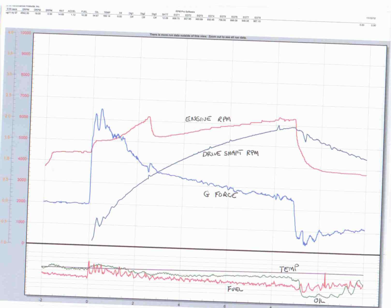

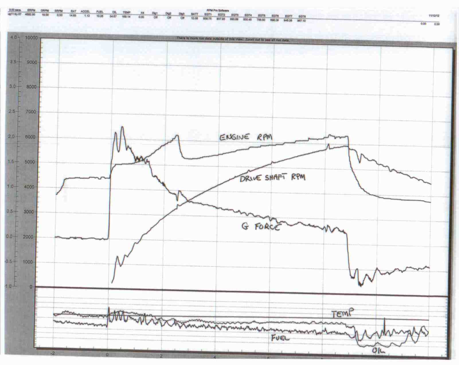

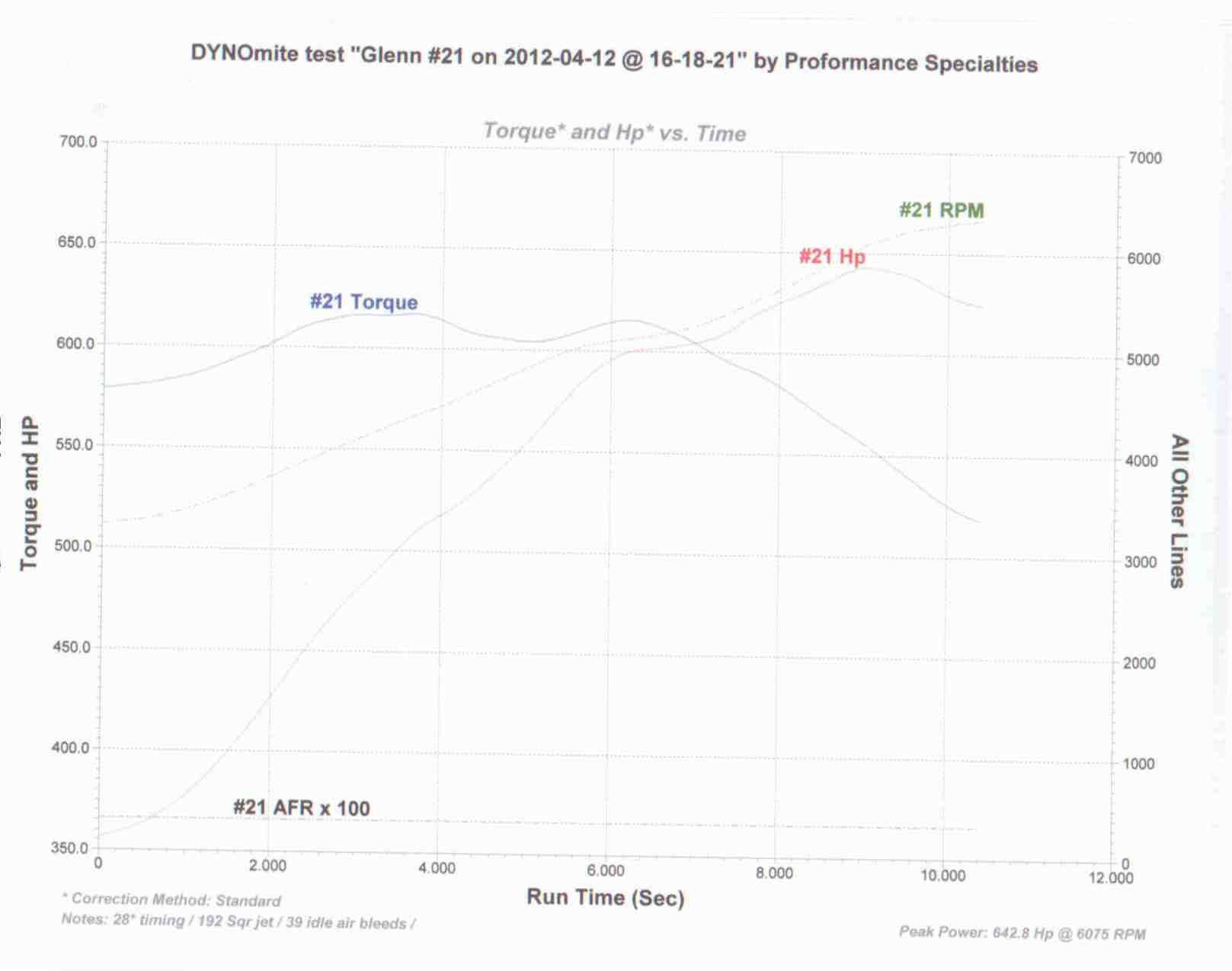

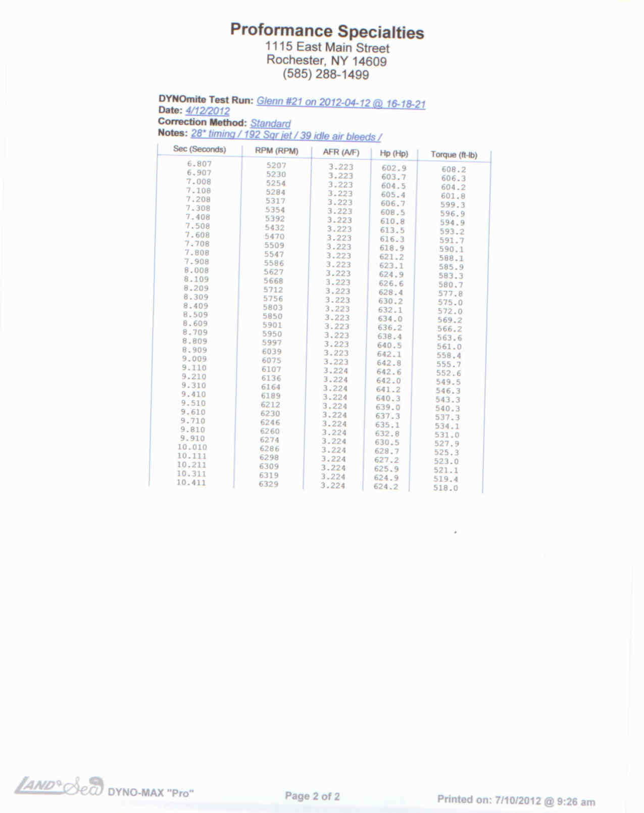

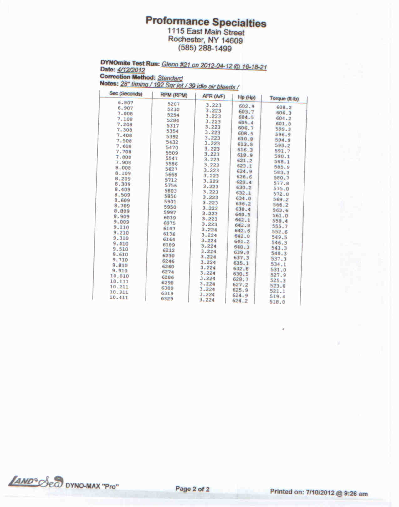

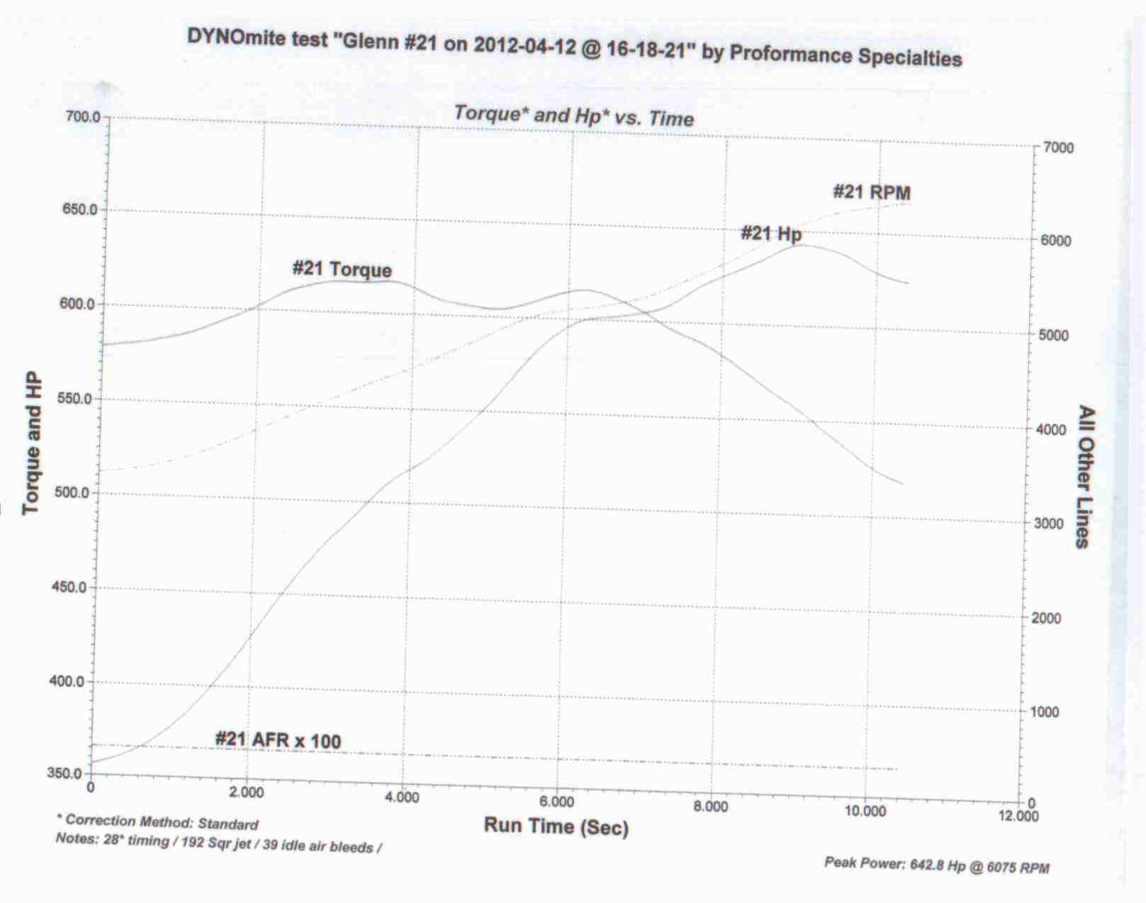

    Current engine is 640 HP, dragster weight is 1690 with me in it.
    Best run 8.59
    Attached is data logger fo that run where I hit the shift point exactly and launch was perfect.
    Also attached it Dyno run and HP Table data
