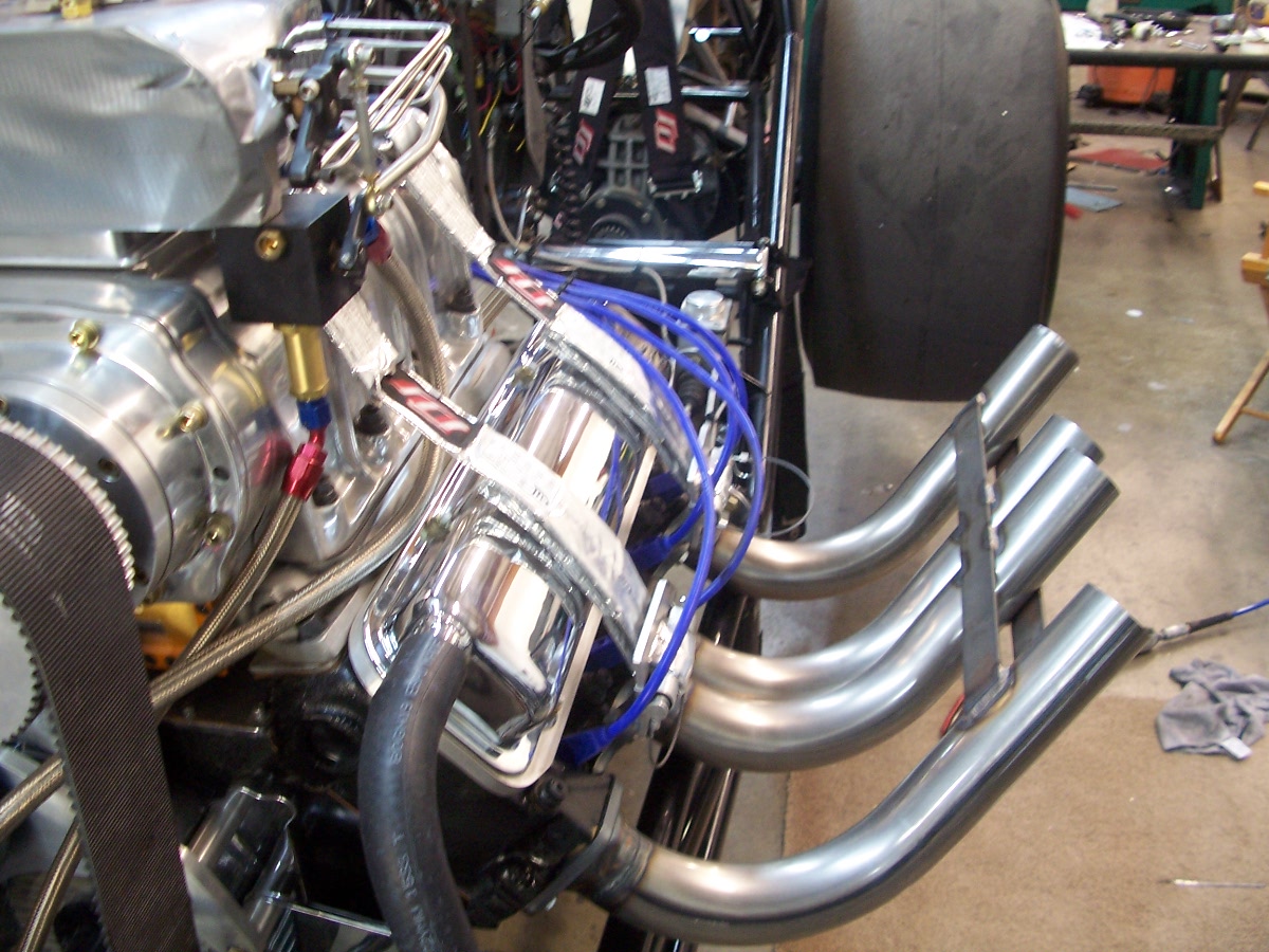

    Personal preference here, But I would put a bend in your restraint brackets and shorten up the straps and try and get a more direct pull. Right now "IF" the blower were to lift, it would rize high enough to possably pull some fuel lines or fittings apart. The pic shows a customer car with them bent and measuring to get the straps shortened so that the blower will seperate, but will hold it posistion.
  2. carshopowner
    Joined: May 2, 2010
    Posts: 406
    carshopowner
    I thought of doing that, but with Pontiac heads, if I bend the brackets up I will not be able to get the spark plugs out for reading. I will put a loop in the feed and retuen line to allow slack should the blower get a lift from a backfire.
    Thanks for watching my back.

  3. dreracecar
    Joined: Aug 27, 2009
    Posts: 3,476
    dreracecar
    from so-cal
    Just snug the bolt down enough to be able to swing the bracket out of the way. Again this is just the way I do things, But for grins I put a new set of plugs in every year (NGK B9ES @ $1.85) and that is the last time I look at them till the next year. My time slip and water temp tells me more than trying to read an alc plug. If I have to read , I just count the threads and as long as the cad is burned no more than 4, I am still safe. Mine have never been more than 3.

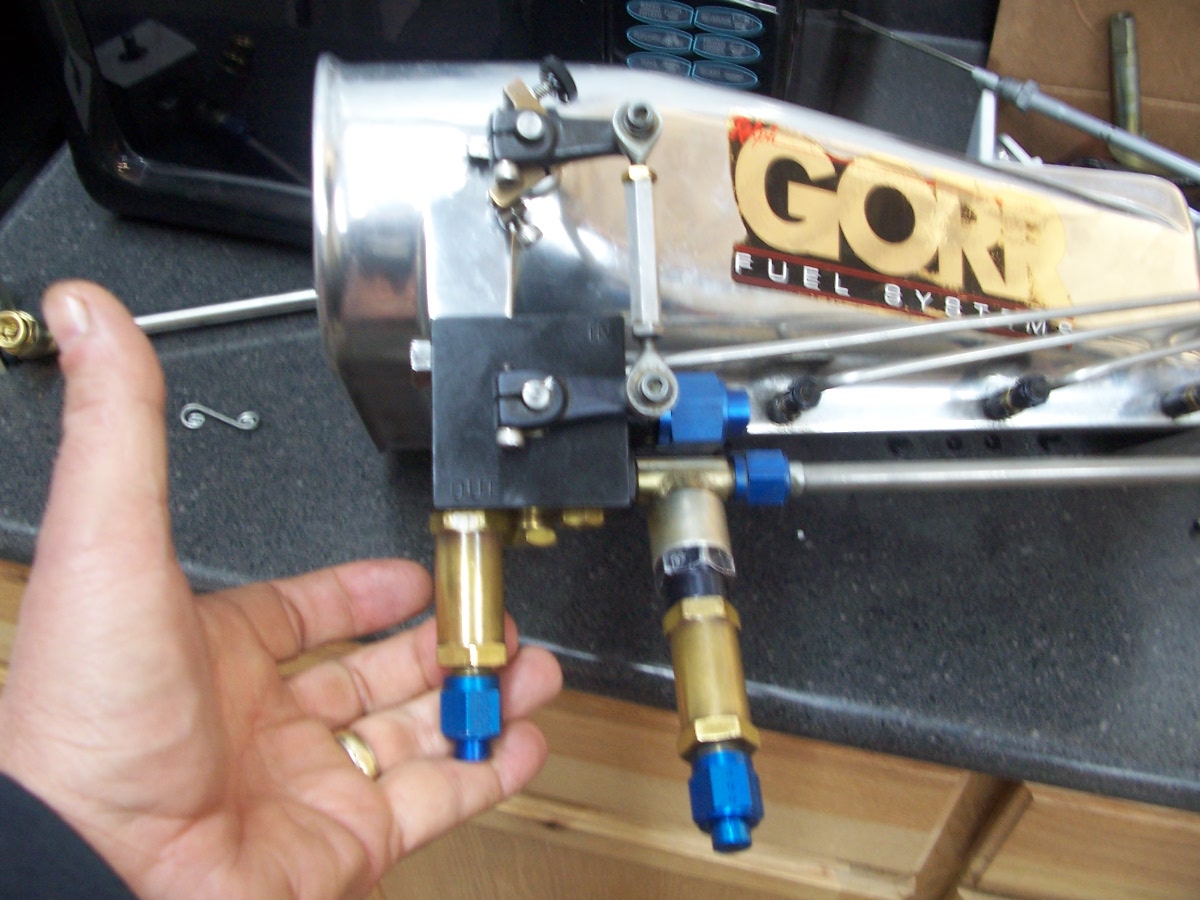

  7. Most guys set up their BV linkage like this.
    Is that T fitting on the outlet in the way?
    It *will* work the way you have it---------:)
  8. carshopowner
    Joined: May 2, 2010
    Posts: 406
    carshopowner
    I just put the linkage on the arms of the barrle valve and butterflie shafts so that they would work. I believe I can mout them either way (there is enough room).
  9. dreracecar
    Posts: 3,476
    dreracecar
    from so-cal
    Glenn,
    You know its your car and for that you can do anything anyway you want to, But in my opinion you have taken something so simple that has been figured out for years to keep it simple and made a jumbled mess out of it. I am not saying that the way it is plumbed will not work, its just all the extra lines and fittings going everywere instead of using a more simple version of the barrel valve, proven on thousands of engines over the years, and get all the plumbing simple and tight and away from the blower belt.
    Second (and this is where I put my ASSHAT on),
    You spend all this money (and wasted money to boot) and you are going to cheapen out and buy aluminum threaded stock for blower studs instead of buying a real blower stud kit? Honestly I dont understand, must be a NY kind of thing.
  10. carshopowner
    Joined: May 2, 2010
    Posts: 406
    carshopowner
    Last thing first as it is the easiest. I had to use a five inch spacer under the blower and intake to solve a number of problems (Pontiac engine, burst panel facing forward away from the driver, room for the distrubutor, leave the BDS water jacket on the front of their intake manifold). Because of the spacer no one makes a blower break away stud kit that will work, I would have gladly gone that way!
    Ok, barrle valve, for this engine I could have used the square barrle valve, but I already see in the near future that I will be building a much bigger blower engine (this one at best is a compromise) and on the bigger engine I will be running both hat and port injection. I have been told that the "K" valve is a much better valve for that purpose. In fact on this valve I am blocking of the port, port, as it is not needed. I am just setting my self up for the next engine.
