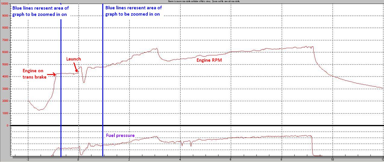

    Well did some test and tune today to work on .400 Pro Tree and 8.50 index racing. Been working off and on on this for awhile now with not too much success. The vehicle has been too fast and I have been too slow.
    The plan is to go to the NDRL race at Edgewater Sports Park Cleves, Ohio in two weeks. I have never run a pro tree and an index so this will all be new to me.
    First run, Saturday 1:33 PM August 10
    Air Density 2317
    Top Pulley 63
    Bottom Pulley 42
    Pill 110
    Top end Fuel Pressure 53.82
    Top end Boost 6.74
    Reaction time a perfect .400 !!!!!!!!!!!!!!!!!!!!!!!!
    60 foot 1.275
    ¼ mile 8.467 / 159.23 MPH
    A/F ratio 4.048

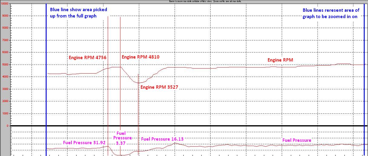

    Comments, Seem dead off the launch, engine RPM graph was flat after launch, two peaks in g-force after launch, short shifted by 300 RPM to second gear

    We went and did some test and tune today.
    The symptom we have is the engine comes up to RPM on the trans brake, I release the trans brake and the dragster launches, and then falls on its face. It then picks’s itself up and has a pretty normal run. I hit my shift point at 6300 RPM, RPMs drop off as you would expect and then climbs again.
    What is pictured below and in the attached files (not sure which is easiest for you to view) is a graph produced in the data logger.
    It appears to show a drastic drop in fuel pressure before the slump in engine RPM. The first graph shows the complete run. The second graph is just the area between the blue vertical lines to zoom in on the troubled area.
    This is the zoom in on the trouble area.
    When the engine RPM reaches 4756 the fuel pressure is at 31.92 pounds.
    When the engine RPM reaches 4810 the fuel pressure has dropped to 3.37 pounds.
    When the engine RPM drops to 3527 the fuel pressure recovered to 16.13 pounds and continues to climb.
    The red vertical lines are for reference between the two graphs of fuel pressure and engine RPM.
    If we lean the engine out (not changing the fuel main byp***, but add air by decreasing the top pulley the problem is not as pronounced. We are blowing fuel out the number 8 cylinder.
    This graph represents an 8.904 ET run in the ¼ mile
    We lean it out and ran an 8.409
    We have check compression, valve lash, put in a new MSD box, New coil, removed the primmer, check timing, increased timing to 30 degrees, check the inside of the distributor cap, remove and cut open the torque converter (no problems found)

  24. carshopowner
    Joined: May 2, 2010
    Posts: 406
    carshopowner
    Not sure why they did not show up, they are there when I look at the post.
    I have attached them as pictures below

    On your close up graph when you let off the trans brake the motor starts to go up to the converter flash, and the pump pressure go up with the RPM, but as it is going up all of a sudden the fuel pressure drops off like a poppet is opening. If it is not a poppet valve then the pump is running out of fuel. Those are the only things that can make the pump lose pressure because it is RPM driven. It is a cam drive pump correct? JC
  28. carshopowner
    Joined: May 2, 2010
    Posts: 406
    carshopowner
    It is a belt driven pump.
    I think we solved 80 percent of the problem. There is a flapper on the rear baffel in the tank. I believe the after the burn out and when I got on the brakes the flapper was slamming shut and getting stuck.
    I would back up, stage and launch and the dragster would burn through the fuel in the last compartment and the pump would starve. The g-force on the fuel in front of the baffle with the flapper would force the flapper open, I would then have fuel and the rest of the run would go fine.
    I wired the flapper up in the tank and it is much better. There is still a dip in the RPM after the launch (fuel pressure does not drop before RPM), but I believe the tires are dead hooking.
    I will post detail on this problem shortly (with graph)
