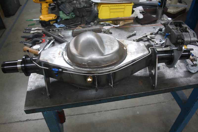

    A few more shots

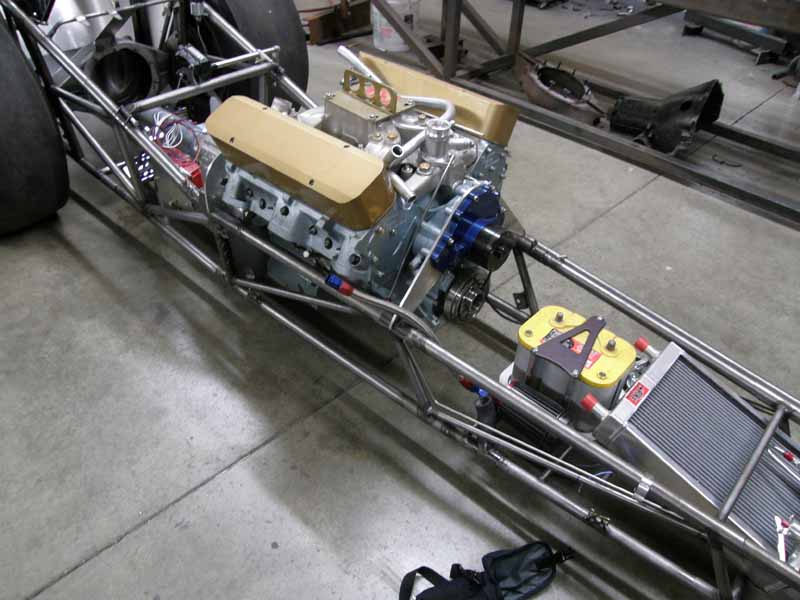

    Some new pictures.
    I will be travelling to Indiana on Monday. I should have a full update on Wednesday.

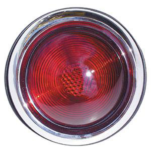

    With the Pontiac power, I might have gone with a round '50 Pontiac tail light, but that's just me.
    Pinocchio has a '37 Topolino tail light I found in Italy.

    I could not find any pictures of Pinocchio on the web. I had not thought of the 50 Pontiac tail light.

    The master cylinder has been installed with a remote reservoir. This makes checking the level easier and eliminates the need for residual valves in the bake lines
    The chute mount is coming along. The frame work that will hold the chute in place is removable by pulling pins.

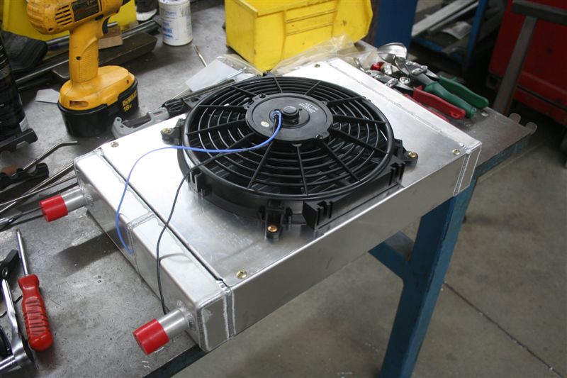

    The coolant system is coming along; yes this dragster will have a radiator. I will be either ET racing or Index racing. The key to either of those cl***es is reaction time and consistency of elapsed time. If, in the future I decide that speed is the most important thing, weight can be removed, and HP can be added. In fact a blower engine is already in the planning stages.
    The over flow tube is routed to the puke tank, the filler neck is in place, but the out flow tube has not yet been welded in place.
    The radiator is custom built by Spike Products, 464 Johnson Lane, Brownsburg, In.
    http://www.spikeradiators.com/
    It is a double core and should be able to keep the engine cool on the return road. The shroud was built by Roo Man. This should eliminate the need for a tow vehicle, and simplify racing.
    No hoses for this coolant system there will be hard tube coolant lines. The one to the filler neck has been remade since this update to give more clearance near the battery and is more upright in the vertical plane to the filler neck.
    The fire bottles are in, and the first fire nozzle is pumped.
    The fuel system is in.
    To start with I will be running the engine that came out of the Firebird. It will be gas, carbureted. The plan is to build a second engine that is blown. It is still up in the air as to whether it will start its life as gas or alcohol injection. I would like to start with gas, but there is considerable pressure to go right to alcohol injection (on the new engine).
    The jack pad on the bottom of the ch***is is in place and the tabs for the jack stands are welded on.

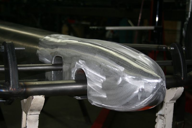

    A great deal of time and effort has gone into making the nose of the dragster just right.
    The remote oil filter has been installed. You can see another angle of the filter in the shots of the coolant system.
    This dragster is being built to look as nostalgic as possible. It will there for have a push bar at the rear, not that it will ever be used, but it will have the use of serving as an anchor spot for the chute. As with any dragster, space is at a premium, the puke tank will be mounted inside of the frame work for the push bar.
    The first version of the anti-rotation device was fabricated from the rear of the ch***is to the differential. It was found that this made removal of the differential difficult so it was redone from the tube under the driver’s feet. A drain plug has been installed in the differential case. The third member has been ordered in aluminum and the axles will be Gun drilled for strength and weight.
    The shield for the coupler has been started
    The electrical shut down switch is in place. There will be a stupid switch in the ****pit. What is a stupid switch? It is used when you have climbed into the car, strapped in, and tried to start the car only to find that you did not turn the master switch on on the rear of the car. The stupid switch can be used to turn the master on.
    The steering "wheel" has had two ****ons installed, one for the transmission brake and the second one for the shift function. Also a center console has been added to contain switches for main power on, start, fan, fuel and fuel pump.
    The engine has been pulled and the ch***is flipped to complete welding on the ch***is.

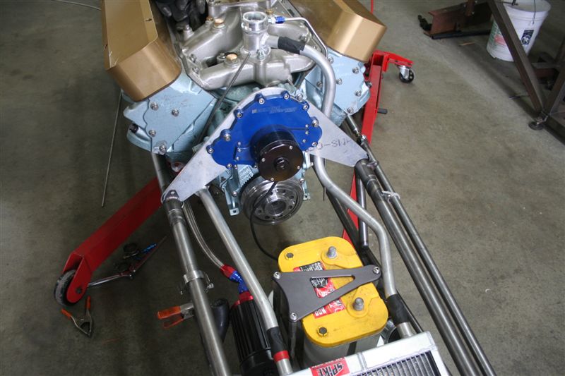

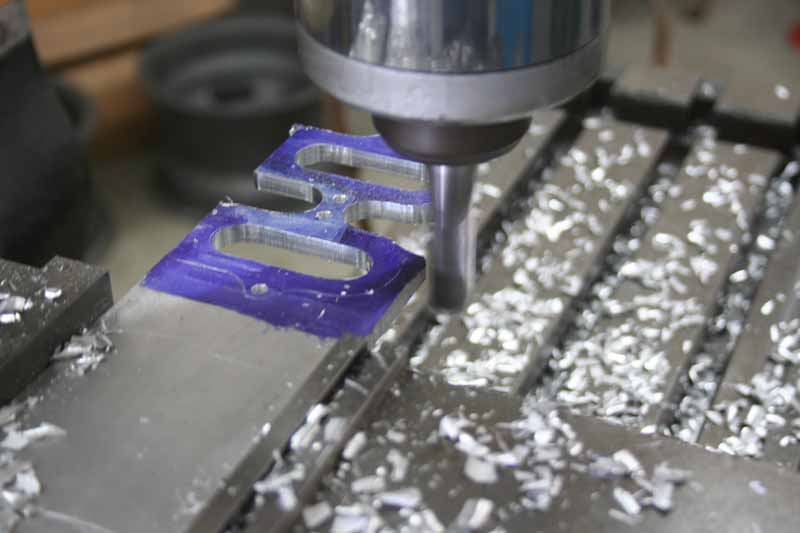

    Shims have been made to space out the ******s of the water pump, why, the engine plate bolts between the water pump and the timing cover. This moves the water pump out so shims had to be made so that the ******s of the water pump engage the timing cover.

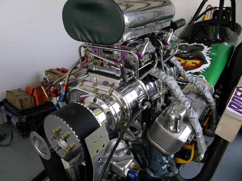

    On the last trip out to Indiana the engine was brought back to Rochester for detailing. The valve covers need to be stripped and redone, and breathers installed.

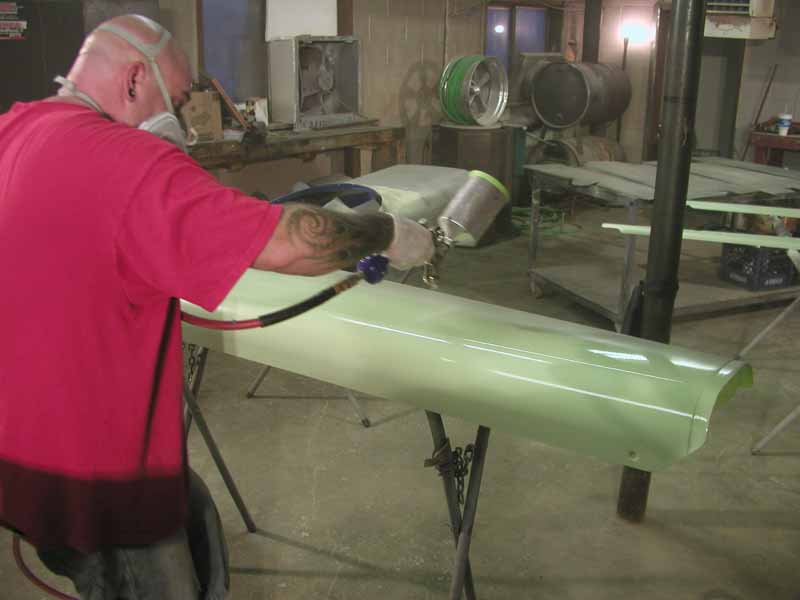

    The Body and ch***is has been shipped off to Bewley's Garage, 220 Park Drive, Plainfield, Indiana, Carey Bewley is doing the paint work and his e-mail is careybewley@yahoo.com and phone number is (317) 372-2244.
    The entire body was sanded, then smoothed, guide coat applied and then block sanded. <O:p></O:p>
    Now it is time for the House of Kolor Epoxy Primer/Surfacer.
    There have been several attempts at laying out graphics and we are getting close.
    I hope to see the finial layout this weekend.

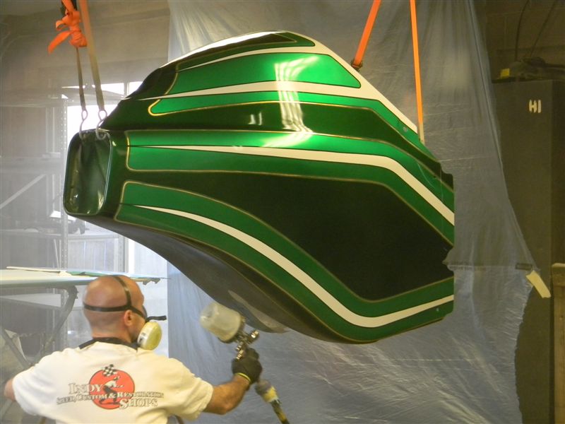

    It has been awhile since I posted an update on the progress of the dragster build.
    Paint has taken longer then I expected.

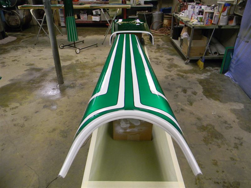

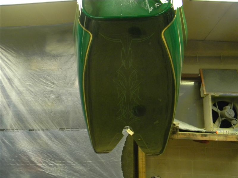

    First one shows base coats before candy green.
    Second one shows three coats of candy
    Last one is five with some of the tape pulled off showing some of the white strips.
    Gold leaf and pin stripping yet to go.
    The dragster should be coming home early November.
    Interesting note is the check written as a deposit to start the build was dated 10/30/2009.
    It is just possible I might pick it up 10/30/2010
    Thanks

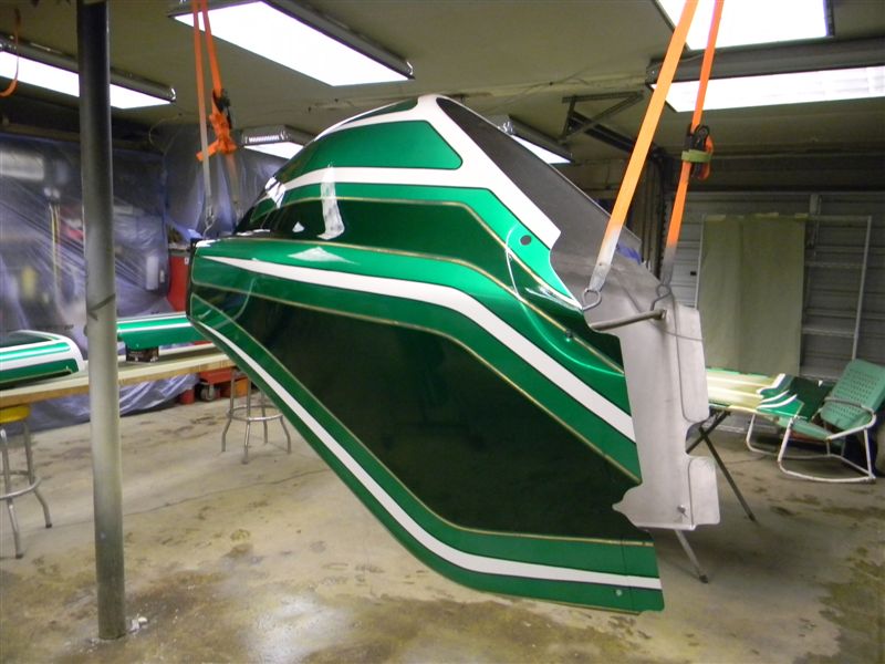

  27. carshopowner
    Joined: May 2, 2010
    Posts: 406
    carshopowner

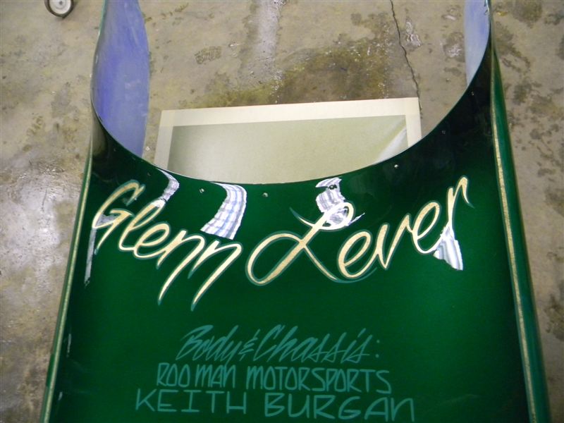

    I'm hoping to drive out to Indiana this weekend and pick the car up.
    Finial clear coats. Still needs finial wet sand and buff out.
