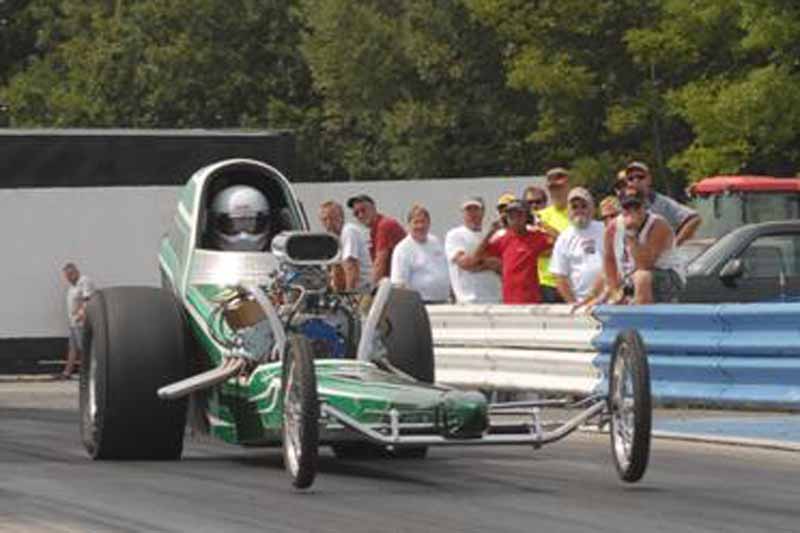

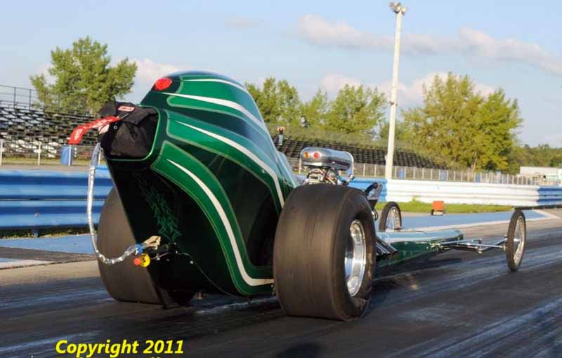

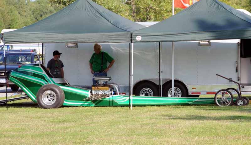

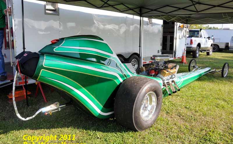

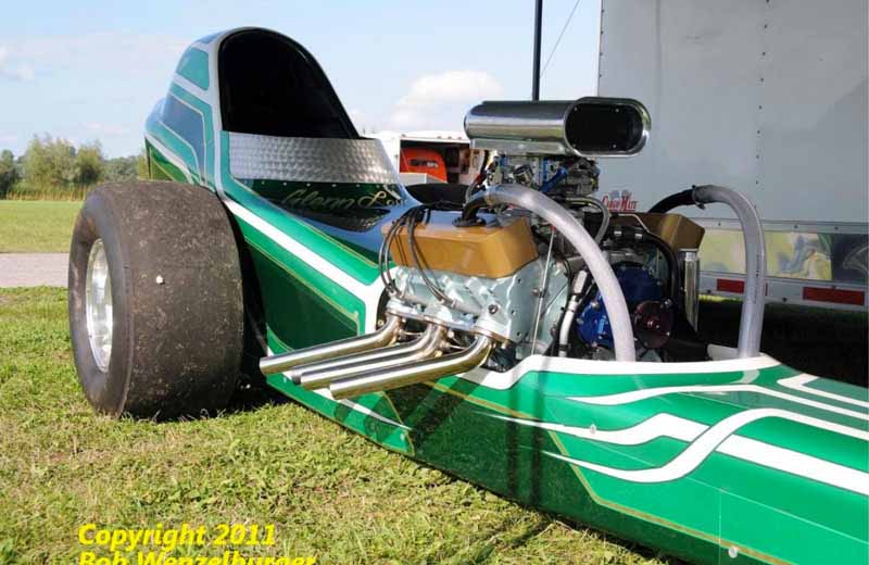

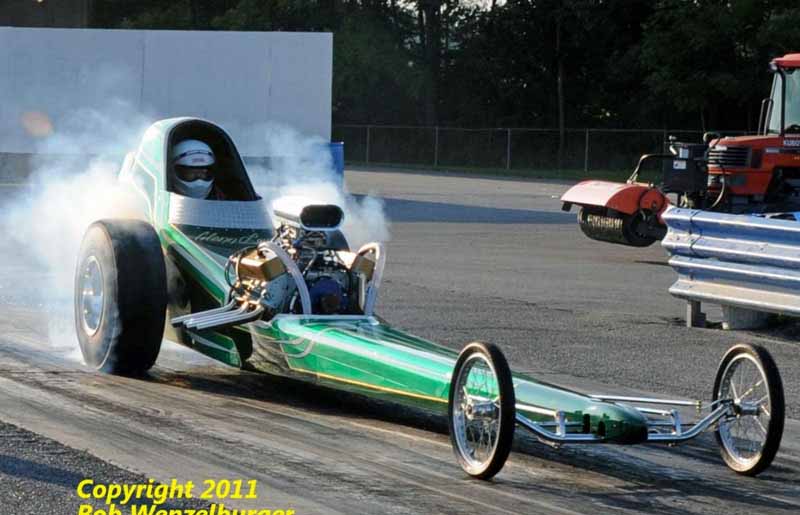

    A couple more pictures, another outing.
