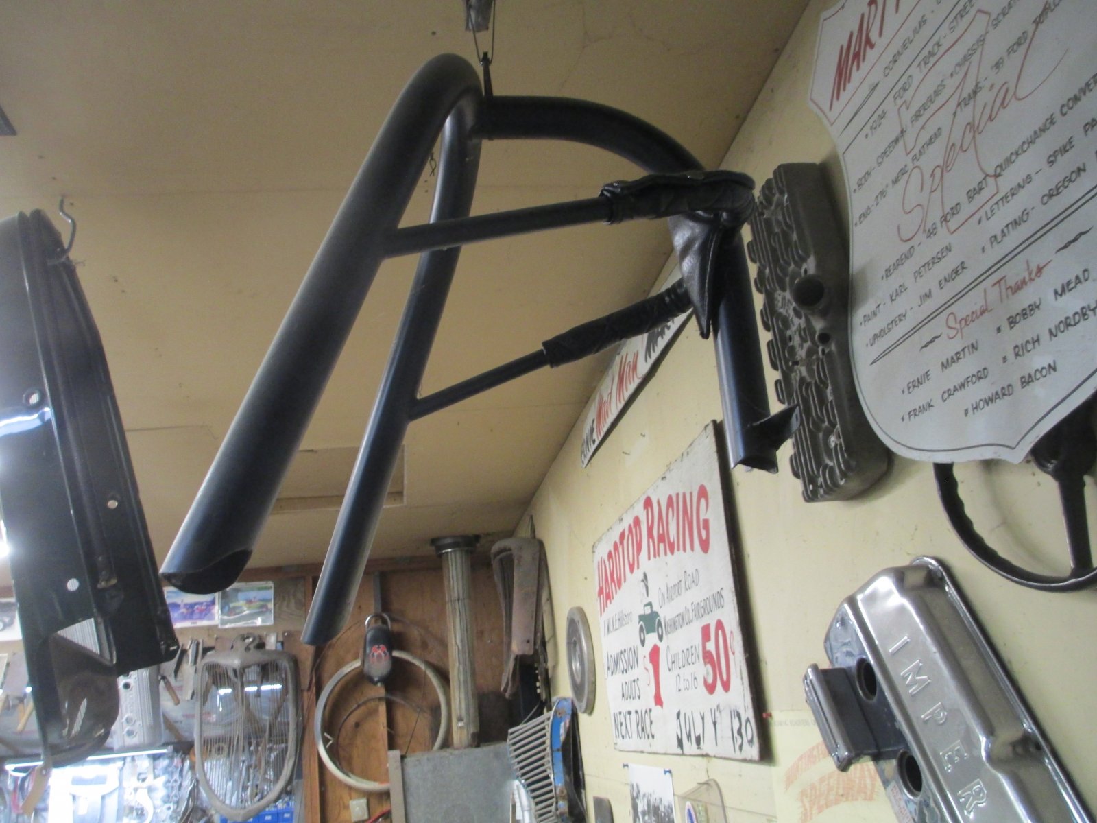

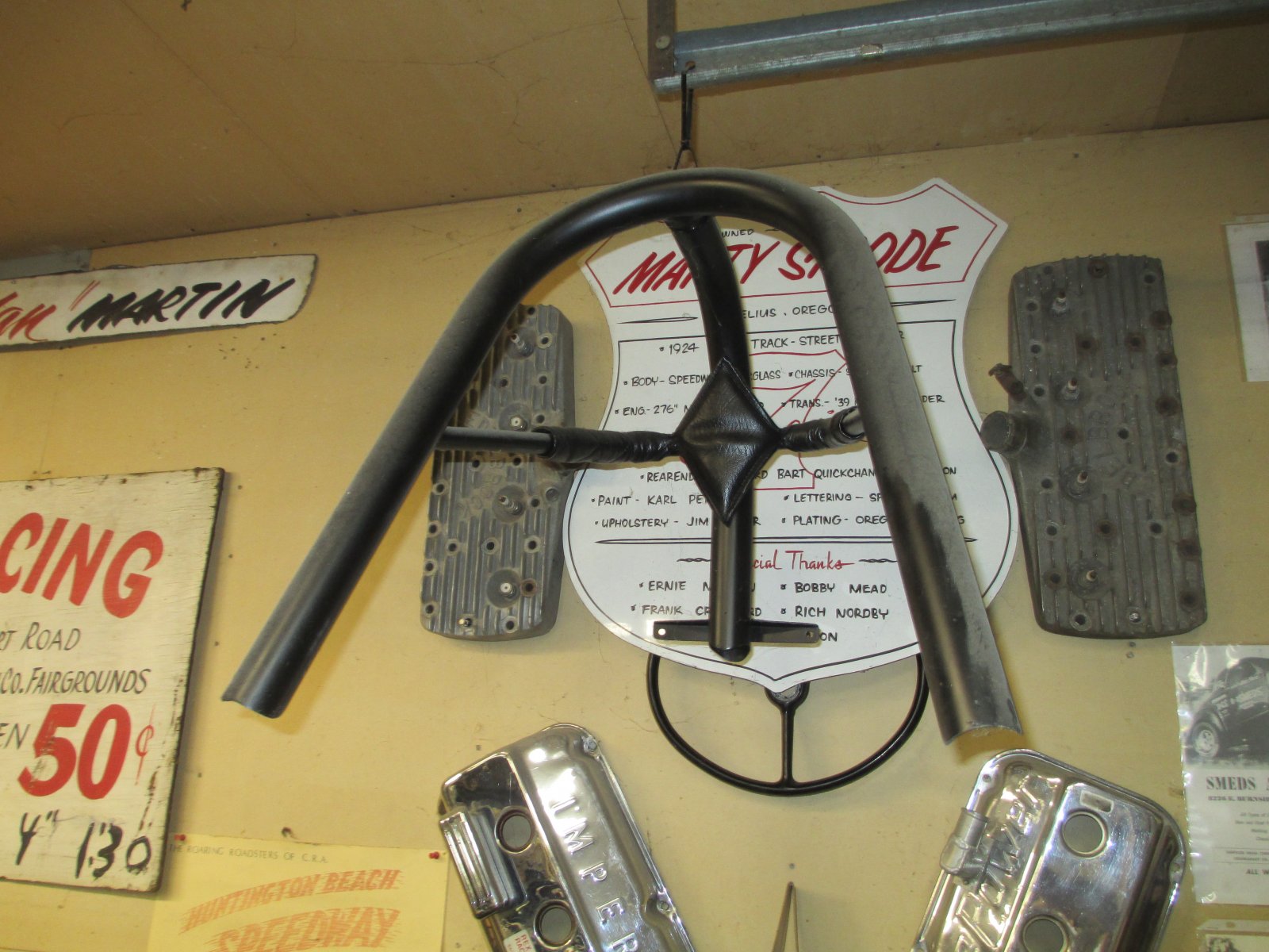

    One of the best, Kent Fuller, heated and bent 4130 tube around a car wheel, this is one of his from '68. IMG_9569.JPG IMG_9570.JPG

    How did he keep it from collapsing? Was it packed with dry sand? And finally, how did he weld his ch***is?
    My friend and mentor and erstwhile driver, Jim was a fabricator. I know he built one dirt car ch***is out of 4130, and gas welded every joint, as recommended by the FAA for small aircraft. He said the heat affected zone was quite a ways from the actual weld, which helps prevent fracture at the joints.

    I am sure he gas welded his ch***is until 64 or 5, then switched to tig. I will ask Marlo Treit if he used sand, as he was dealing with Fuller back in those days.
