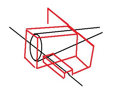

  3. i think that would be cool. my concern is the chain. my kid ran jrs. and i have seen some break. how would you protect the kid.
  4. Heavy wall steel ****ter shield that encloses the whole ****pit. It would cover the axle and brakes also.
    sorry for the ****py paint picture but something like this..

    Back when we first started racing all we had was the puny #35 chain that were prone to breakage, now with the #415 chain we now run on the quick, high powered cars chain failures are praticaly non-existant. You can run the brakes outside of the ch***is just like a normal FED. For a chain cover you could use some 1/8" thick chrome molly plate, or 1/4" aluminum plate to make a chain box that bolts to the ch***is so you could access the chain, and rear sprocket.

  7. That what I was thinking using the #415 chain. And yes I was going to make the cover(s) removeable so I could have acccess to it.
    As far as the brake go. I am not sure if they will go inside or outside. I thinking more on the outside just incase of a chain failure. less likely to cause damage to the brake lines. What do you think?
