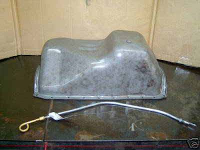

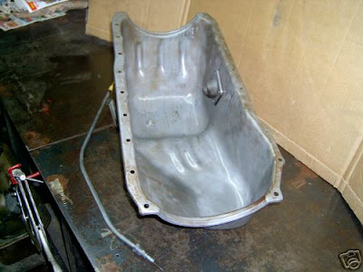

I got mine off ebay for about $40...I usually see them go for around 80-130. 4x4 rear sump from a 400 or 351m. Make sure you get the rear sump pick up and main cap bolt as well. Mine is a little different than most that you will see...I think it may have been for a unique application as it is shaped different than most 4x4 pans?? (This one has an angled side, drain plug is on bottom instead of angled rear) I was told it may have been for a fox body application (OT...anyone recognize it?)...it should still work for what I need though. Here is a pic of what most 4x4 pans for 400's and 351m's look like just for reference: Go to junkyards and look for the older bronco's (78-79 ish?)
