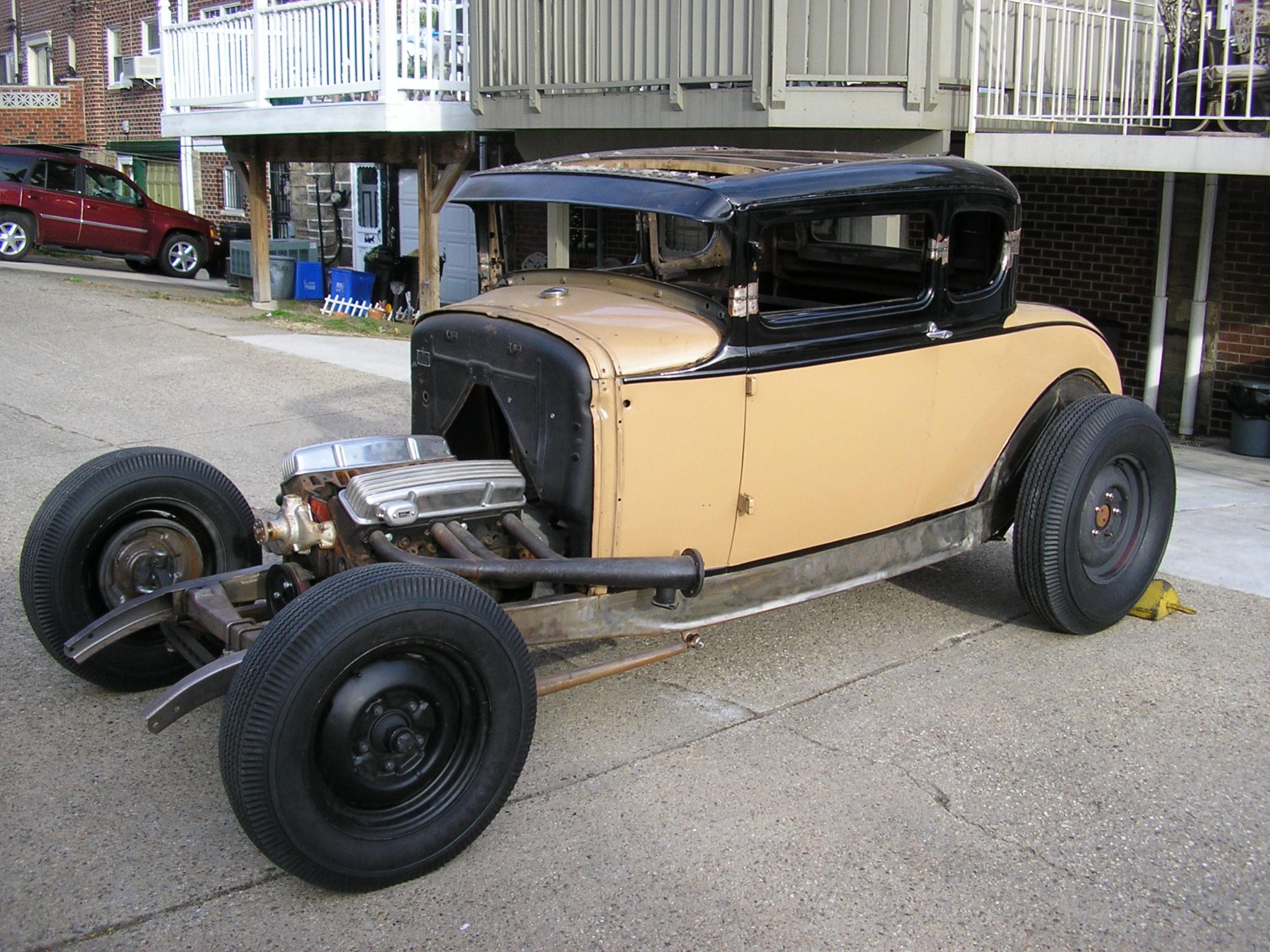

    i've seen some model A hiboys using the front panhard bar and some without.. how necessary are they.. will i regret it if i don't put it in now.. i posted a thread a while back regarding a panhard bar in the rear and most of the H.A.M.B.ers thought it was not necessary with the rear setup i have.. so i didn't install one

    forgot to add the pictures of the build

    i am running cross steer.. i'd like to add pictures but sometimes i can and sometimes it fails
