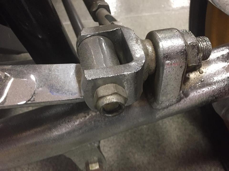

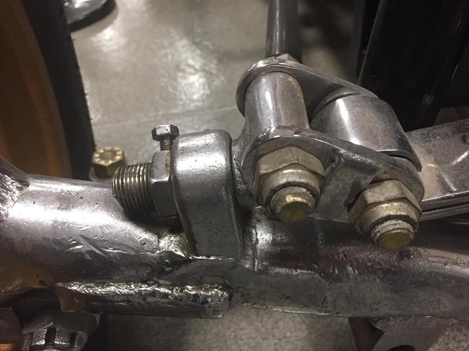

    Dead perch setup on a 1964 sprint car. Will always force the axle to scrub one direction, not such a big deal on a dirt track, not the best answer on the street in my opinion.
    My '32 frame has a panhard bar. Right batwing to left side of frame.
