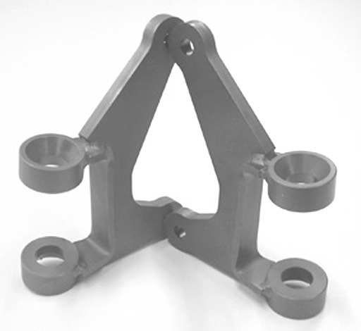

    I am not talking about welding the shackles to the perch. I am talkng about welding the perch to the batwings and installing the shackle to the perch. The batwings I am using do not bolt to the perch boss. They are welded on at the perch boss. It is left to the imagination of where to mount the spring perch to the wing.

    Do your set up as in the photo by 31 Vicky,,,NO ****IN WELDING...I had,repeat HAD a friend that welded his and it broke off,dropping car to ground then pole vaulted him to his death

    Are those wings homemade or if not, do you mind saying where you got them? I get it.... no welding.

    On some tube axle the batwings are welded on, on the better tube axles they have a perch boss fabricated in.
    m&s rodz likes this.
  8. Try looking at the pics on a computer, a bigger screen.
    They are fabricated-
    Every hot rod shop sells them.
    If they are fabricated in a shop, they are fabricated. What the shop attaches to where the shop is located doesn't much matter. It's all about what and who's in the shop that makes the difference.

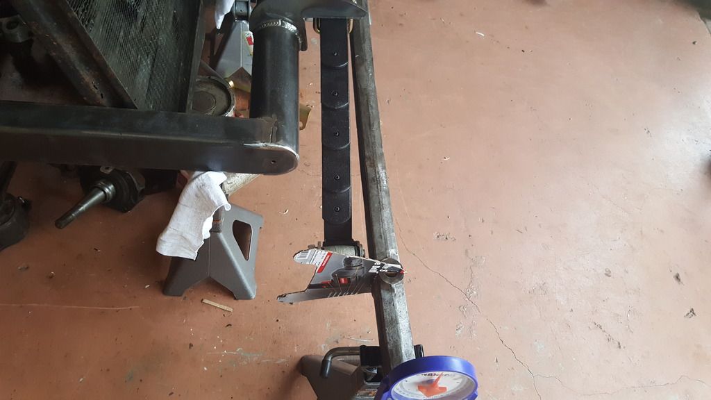

    This is the only pic I have at the moment. Won't be home until Monday..... I used Speedways method of measuring for the correct spring. Measure spring perch eye to eye and subtract 5"

  13. Both of these are set up correctly and ride exceptionally well.
    it requires significant force to mount the springs.
    Check the arch height vs length loaded. Compare to yours about 10" high.

    Hey there Lakes,
    Judging from the looks of your batwing templates, are you using Chester Greenhalgh's plans?
    I would suggest using a bolt on spring perch as others have mentioned here. But welding the batwing to the axle is perfectly fine, as long as your welding skills are up to snuff.
    Is the question you are asking about where exactly to weld the batwings to the axle? The components in your picture will work fine, including the 31 inch spring.

    The Speedway catalog has pictures and tech hints so you can set this up- if you use batwings, you attach them to the axle with flat top perch bolts ( nothing gets welded) Then the spring bolts to the batwings. You can make anything ( almost) work- it's hot rodding. This is a Dago axle ( model A heated and dropped ) IMG_3159.JPG
