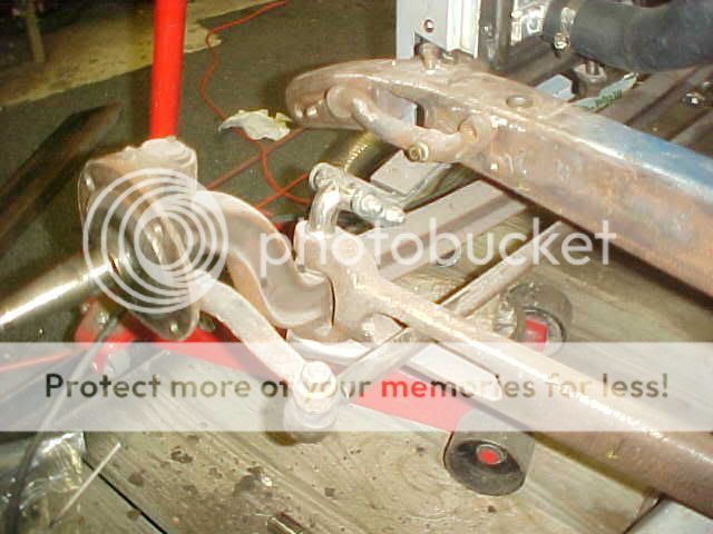

Top of the morning to you Brian, If you recall, we spoke on the phone last week about this same problem I was having with my steering set up. I went with your suggestion on the deep drop steering arms and it solved the problem two fold. Not only did it allow my linkage to clear the bones but also will allow me to drop the front end a little more, I've atached a few pictures for you so you can see what we were talking about. Thanks again Brian for the phone call and the information. Gary
