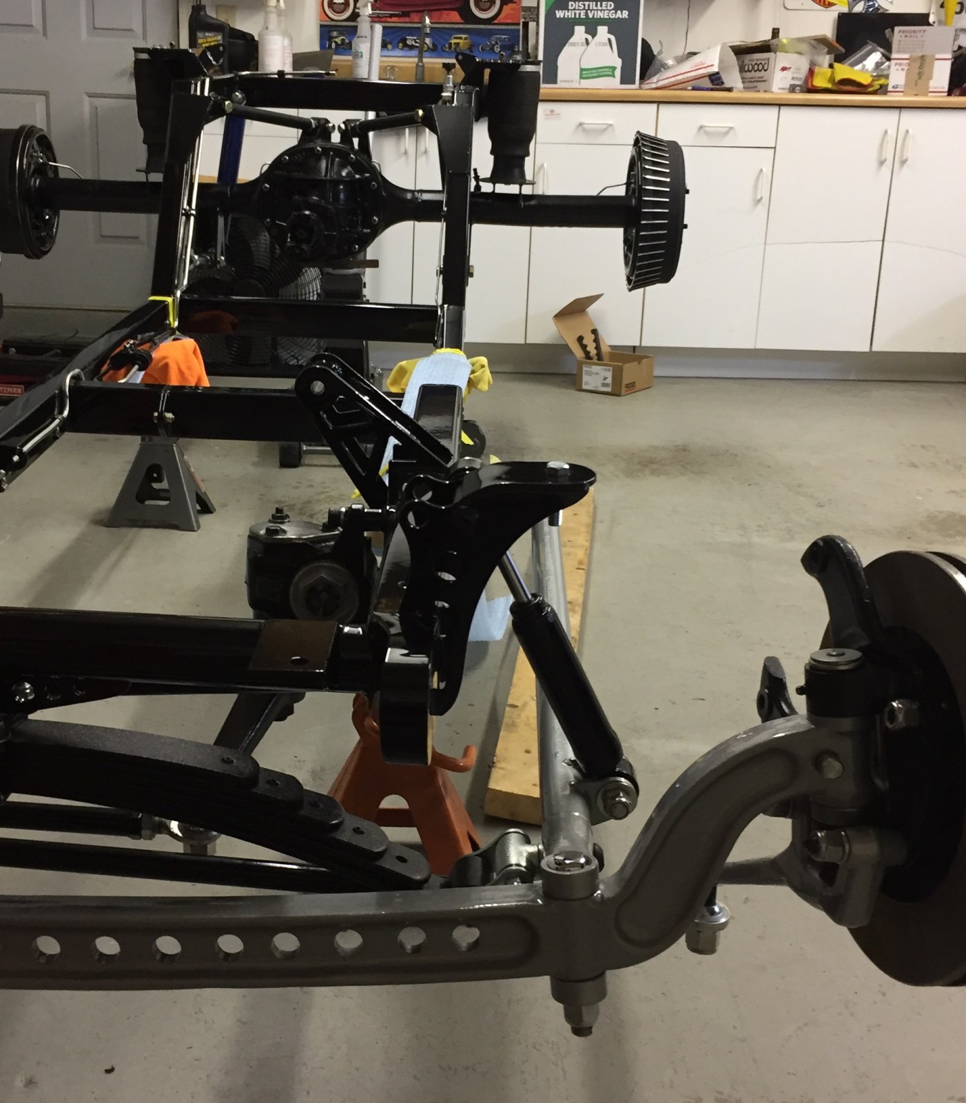

  10. BJR
    Joined: Mar 11, 2005
    Posts: 11,204
    BJR

    That ^^ one will fight the spring.

    The shock is intended to control the wheel & tire movement , installed as shown it will do exactly that , I don't understand your concern .

    The spring will widen as it compresses, changing the shackle angle, which the shock is attached to the other end of. So as the axle bumps up, the bottom of the shock will swing inward as well as upward. Who knows, maybe this is a benefit? Twice the shock travel for half the axle bounce.

    I have driven this car over bumps and it drives great.

    Yeah I don't know either, the shock is actually playing teeter-totter with the spring.
    Not saying it won't or doesn't work but I wouldn't run it.....

    Wouldn't that give the shock a "progressive" capability?
    The farther the axle moves up, the closer to vertical the shocks get, and the stiffer the system becomes.....

    YES
