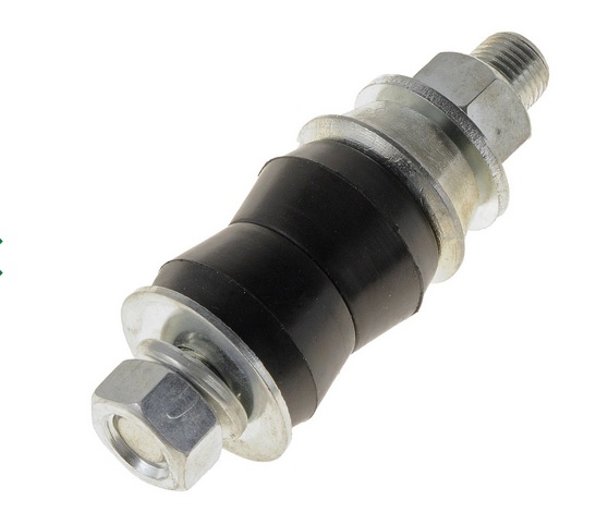

  10. RICH B
    Joined: Feb 7, 2007
    Posts: 6,038
    RICH B
    Almostdone and Jerry A Smith like this.
  11. Jerry A Smith
    Joined: Feb 11, 2017
    Posts: 68
    Jerry A Smith
    from Tulsa
    Thanks RichB. those are exactly what I'm looking to buy!
