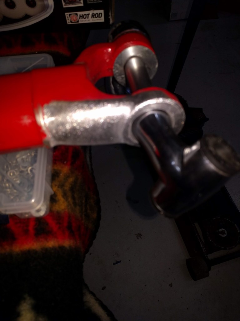

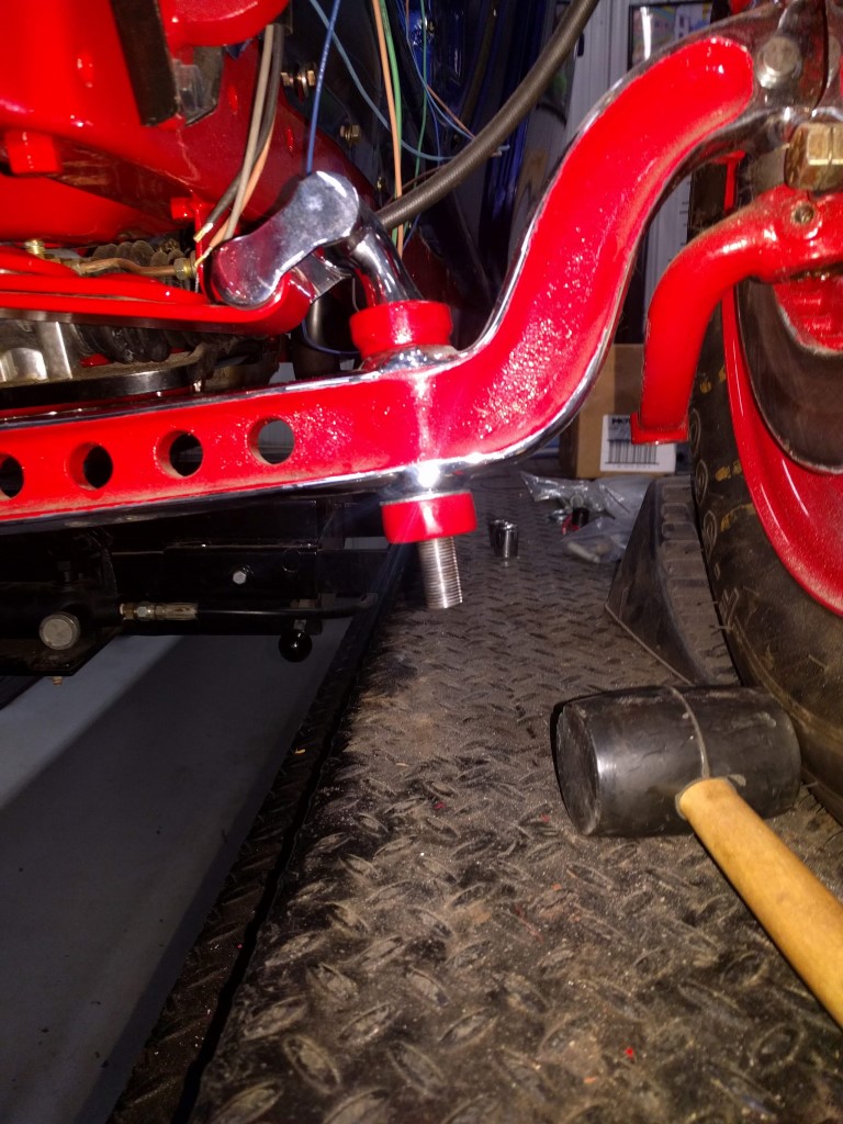

  10. Here are a couple pictures of how the yoke was reworked on the '40 wishbones we used on my friend's '33. While we did this to fit street rod lower shock mounts; the same method will work to fit the short '32-'34 perch bolts.
    First a rough cut was made with a cut off grinder to remove the bulk of the excess material.
    The wishbone was then set up in a Bridgeport and the top was cut square and to the final height. The tapered seat for the perch pin was then cut.
    (I didn't go over to my kid's house so I didn't get any pictures of the machine work.)
    The new cut was then sanded to blend into the rest of the yoke.
    If you don't have access to a mill; the same result could be obtained with a grinder and some "precision" die grinder work for the taper.
    In the last red axle picture, you can see the shim washer between the yoke and the bottom of the axle; this makes up the difference between the 2-1/4" axle and the 2-1/4"+ '40 yoke.
    The picture of the black axle shows the thicker spacer needed with a '32-'36 2" boss axle. I usually make those out of 1-3/8" round stock cut to the correct thickness and then drilled to 11/16".
    40 yoke 1 med.jpg 40 yoke 2 med.jpg 40 yoke 3 med.jpg 40 yoke 4 med.jpg axle spacer - Copy.JPG

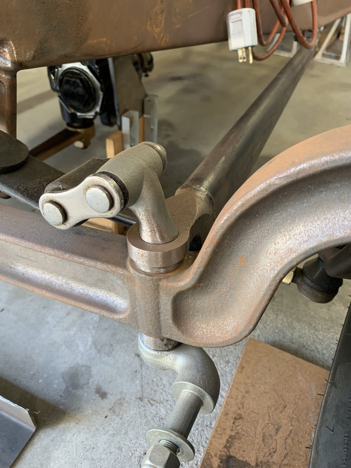

  13. Johnny Gee
    Joined: Dec 3, 2009
    Posts: 14,046
    Johnny Gee
    from Downey, Ca
    oliver westlund likes this.

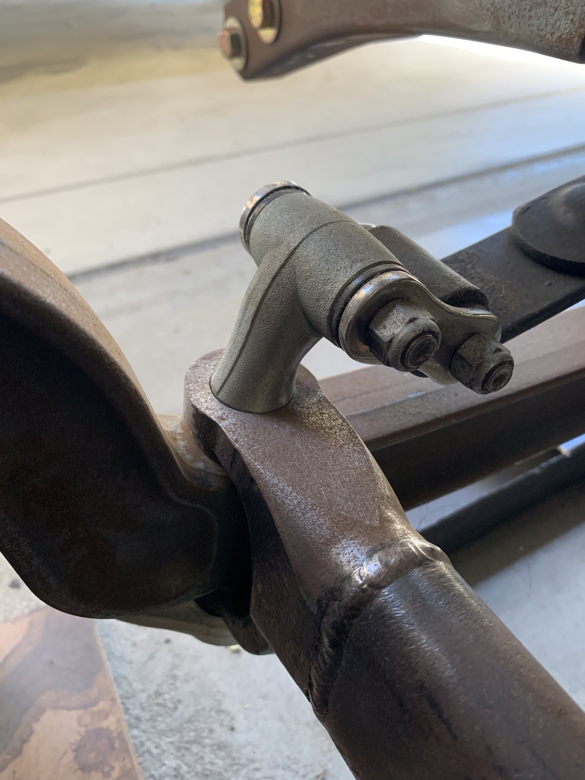

  14. @Johnny Gee Looks good; did you flip your wishbone tubes or re-weld and grind the original top seam?

  18. Johnny Gee
    Joined: Dec 3, 2009
    Posts: 14,046
    Johnny Gee
    from Downey, Ca
    No, I came into this after it began being built by other’s. All I did was machine the thicker portion down so the perch bolt’s would work with lower shock mounts.
