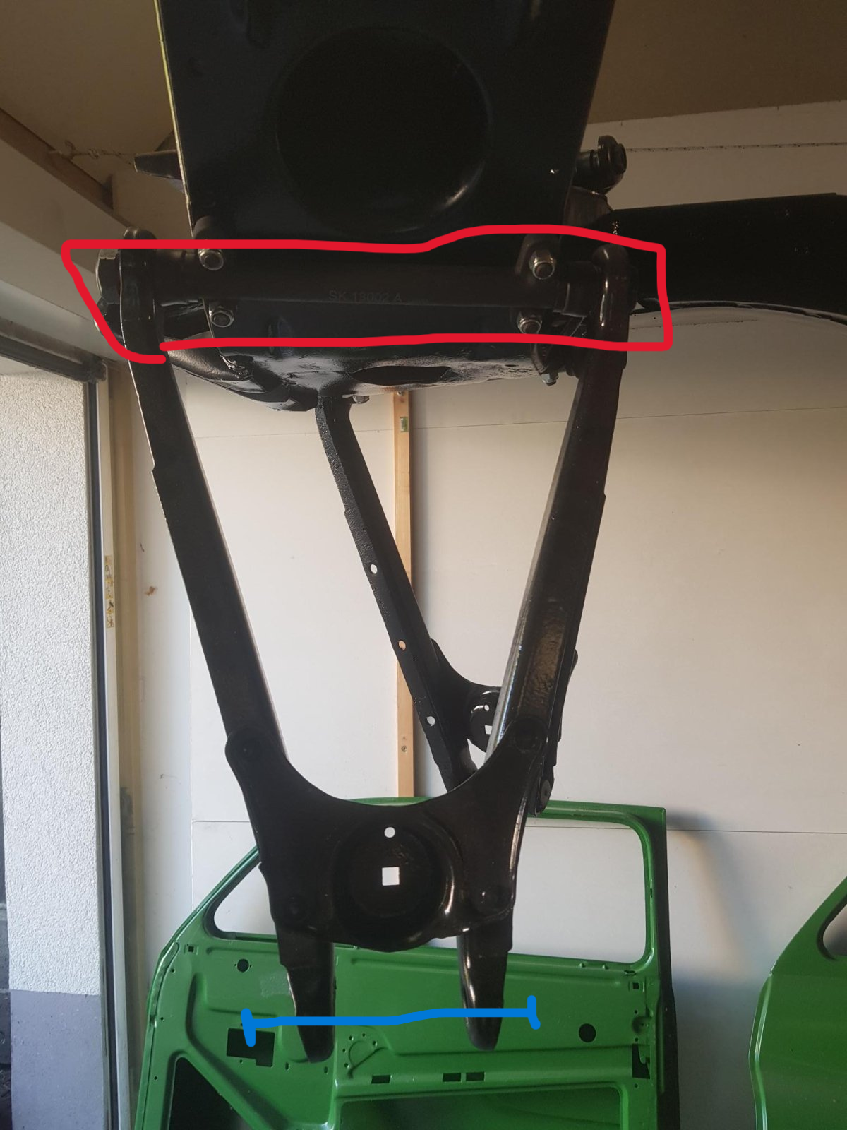

    has anyone ever overhauled broken thread in the control arm on mercury 1949 -1951.
    the upper and lower spindle I found at jamco... but is there any possibility for the control arm
    51 mercules likes this.

  5. Good`Rockin Daddy
    Joined: Jul 15, 2011
    Posts: 33
    Good`Rockin Daddy
    from Germany
    sorry guys ... may be due to my bad english..
    here some pics

    GRD, by threads, I ***ume you mean the places where the nuts (below, circled in red) for the control arm pivots screw into the control arms.
    From the pictures you have shown, there seems to be plenty of thread left on your control arms. The nuts only have to be snug, they do not have to be torqued very hard. If there is metal missing where the threads are supposed to be, then you can build it back up with a thin layer solder or br***.

    the spindles marked in blue are,
    respectively outside above and below of the A control arm

    Have you had these ***embled, or are you just doing it now? Those "threads" are not like what you'de see in a regular nut = fine and sharp. Try to ***emble one side and see what happens. The cross shafts have good threads.

    The (GM Holden) I worked on, had the same joints back in the 50s - 60s.
    Those ''threads'' you're worrying about are normal, the inner thread of the trunion bush pulls up on the inner thread, (this is the operating surface) and the outer (worn) thread locates in the A arm.
    ***emble the joint by hand, ensuring all the components are even both sides of the arm, then tighten the trunion bushes until they both snug up against the A arm, and it'll be good.
    Hope that makes sense to you..
