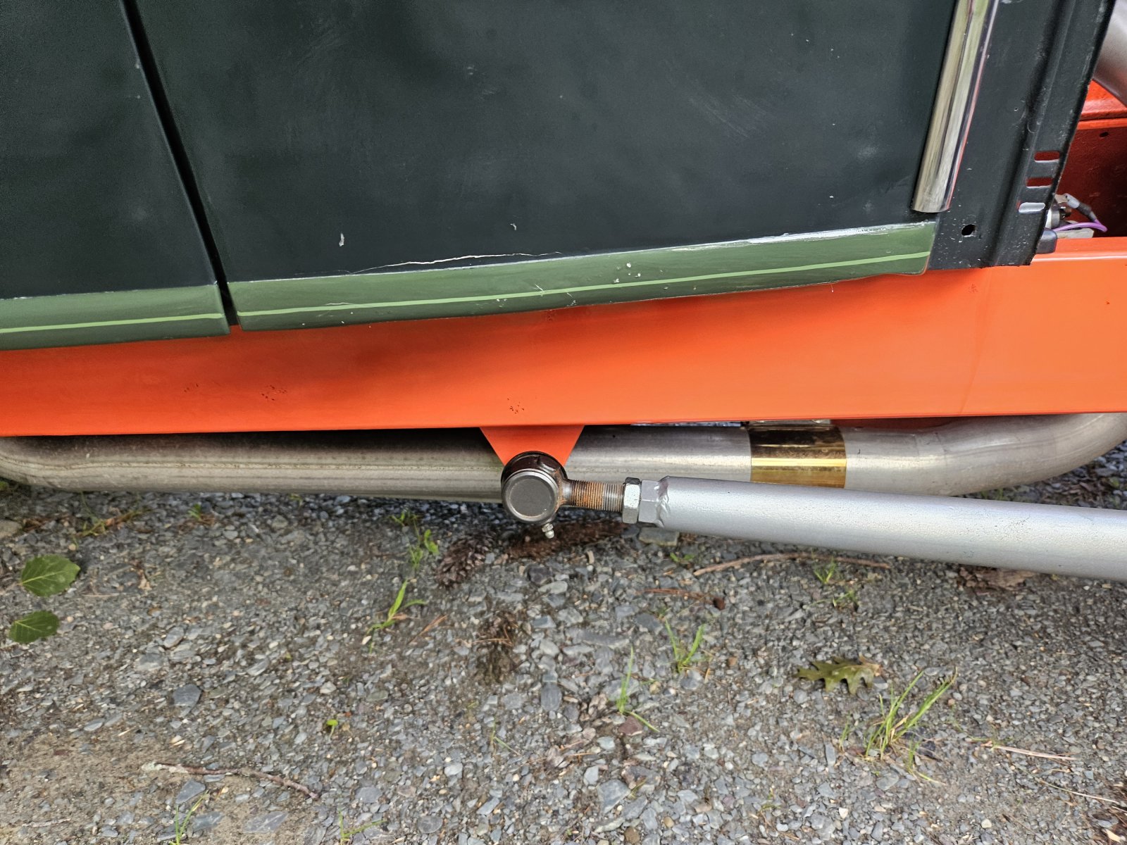

    Here are some pics. When I tried to install the new spring, the driver side spring eye was in line with the spring perch, so I just bolted it up. The rear of the eye sat at about center of the spring perch. I adjusted the bone to align it rather than push it into place. You can see the adjusted amount by the lack of corrosion on the threads. 20240813_181036.jpg

    These pics show the lack of adjustment on the tie rod. I think I either need to cut the tiered shorter or order a shorter, thoughts? 20240813_181057.jpg 20240813_183838.jpg 20240813_183838.jpg

    Three things, how much thread is there still in the radius rods, yes cut some off the tie rod to achieve toe alignment and the spring is too long, the shackles are too vertical. That's from a quick look. JW

    Noticed the bones have been pie cut to give clearance for tie rod etc, how much caster has the axle got?
    It can all be fixed and made right, you just need to find all that's at fault and make it all work together happily. JW
    edit; the tie rod needs to be shortened not lengthen it.

    With as much thread as the tierods generally have you can easily remove the tierod and take the ends off. Then trim both ends 1/8" and clean up the cut. Then re***emble the tierod and you'll have gained plenty of adjustment to be able to remove excessive toe in.
    All that said, excessive toe in will not cause death wobble. Not enough toe in will certainly cause it, so I'd guess your issue will not be too much toe in.

    Yes, Tie Rod is too long. Cut off a little, clean up the thread, and try again.
    Check the bottom of the frame to see if the front spring is bottoming out.
    That would hurt the ride. Some people will notch the frame for clearance.
