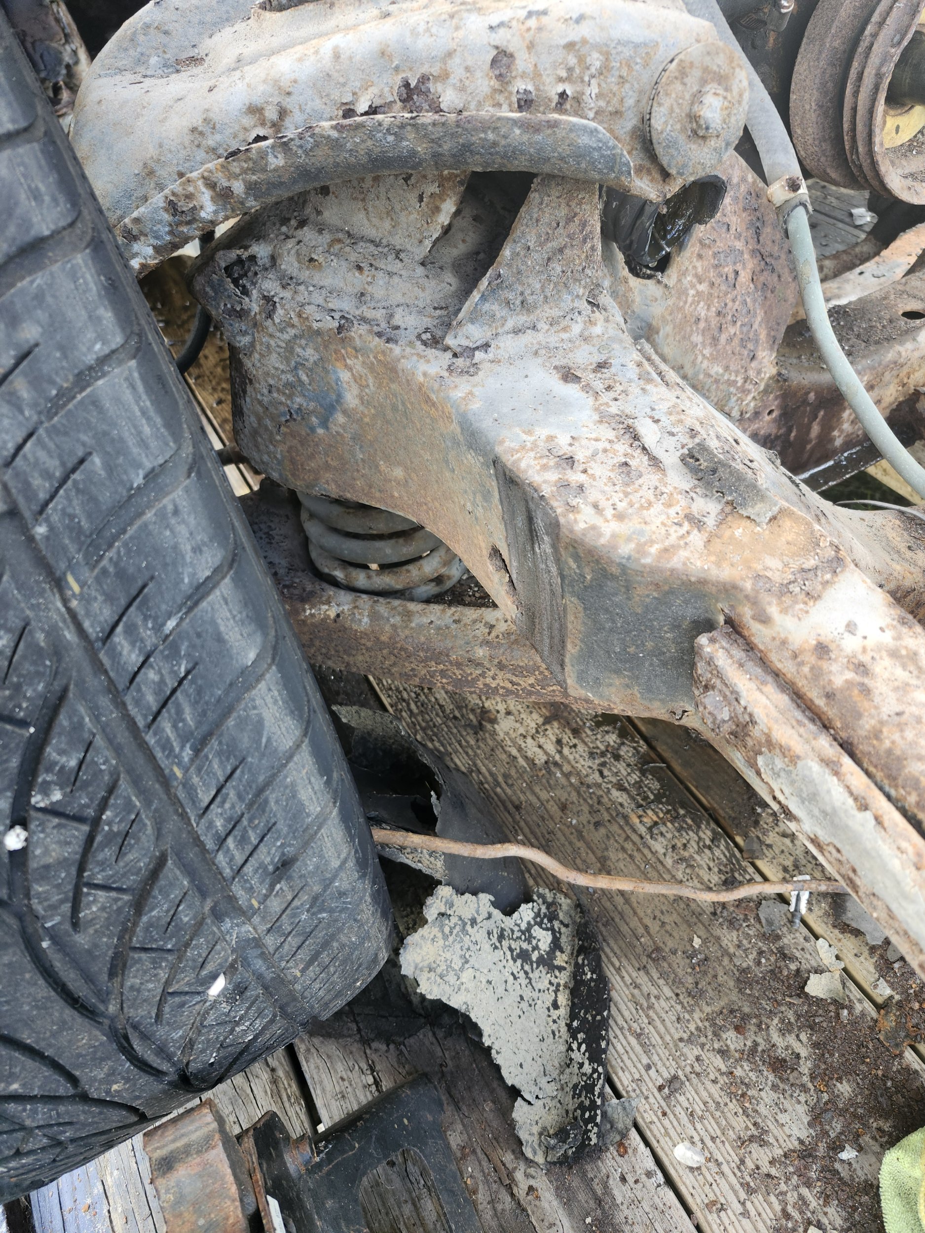

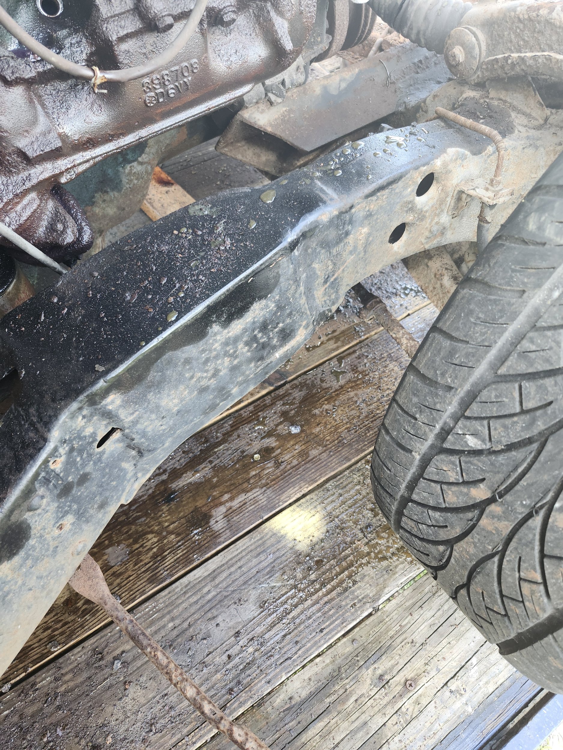

    This doesn't look like a s10 . What did this come from?

    The HAMB doesn’t do independent suspensions but I can tell you that there is a late ‘60’s Olds engine in there.

  5. Rear steer box, so likely early Camaro/Nova.

    Yeah I’d say nova.

    67-69 Camaro and 68-74 Nova (and their corporate clones) used that subframe.
