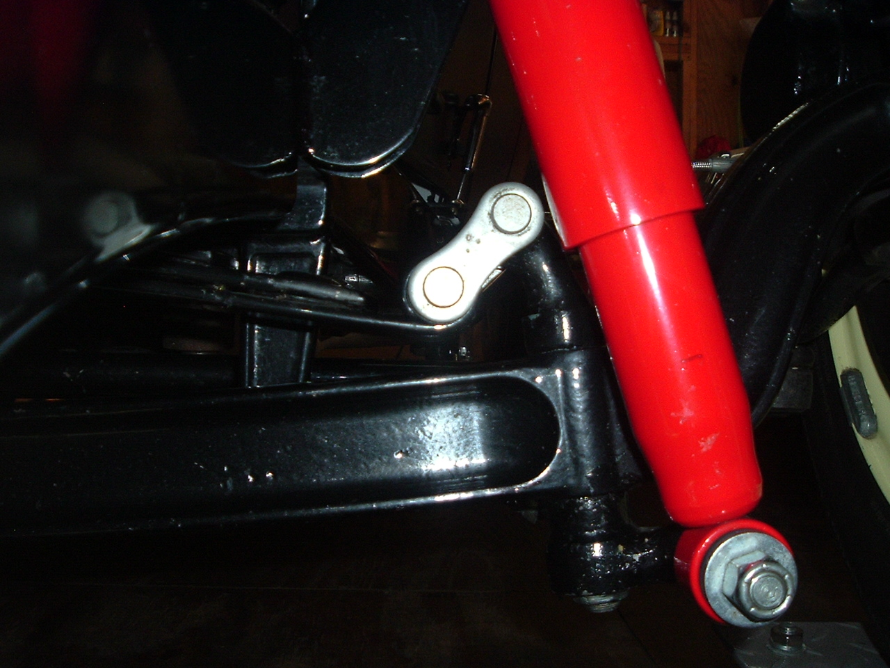

    Just curious. What is the shackle angle with the car on the ground? They should be at a 45 degree angle toward the perch. If that angle is not close to correct it can affect the ride quality. Check to see if the spring leaves are rubbing on the sides of the crossmember. That can make it stiff and is/was a fairly common problem. There is enough wiggle room in the crossmember to pry the spring over to center of the channel. Just a guess. Don't hit me. :(

  9. NJ Don
    Joined: Dec 25, 2019
    Posts: 274
    NJ Don
    Here you go:
    Timothy Murphy likes this.
