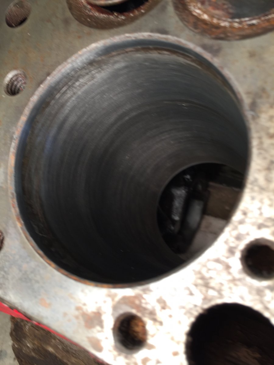

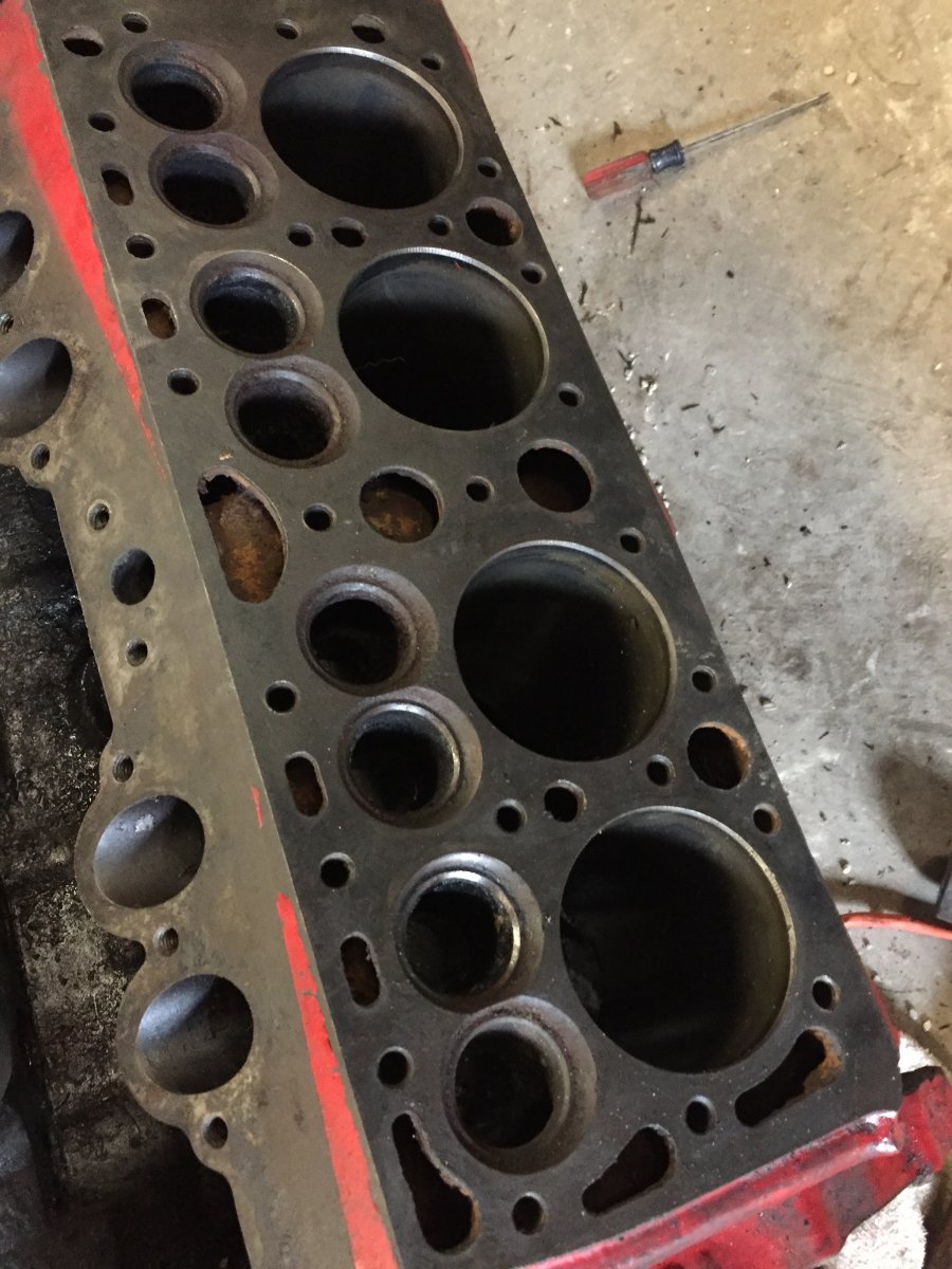

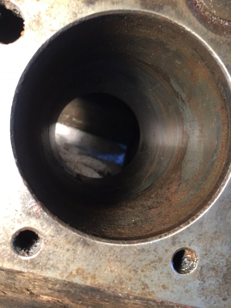

    Going to try a little cylinder honing today or tomorrow to see if the bores will clean up. If it looks promising I'll take the ridge reamer to them. I'll be checking the dimensions to see if I need a rebore or perhaps just a simple overhaul.

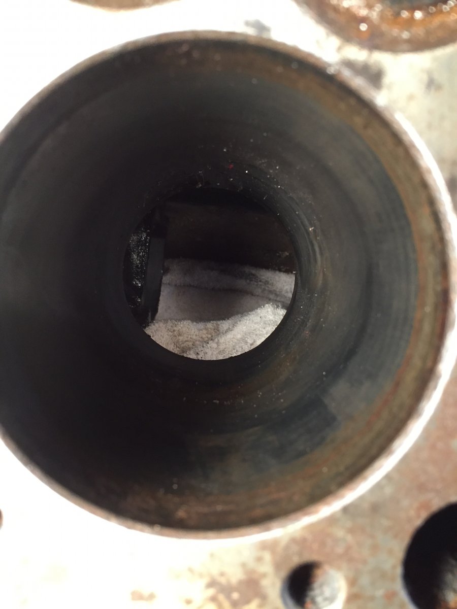

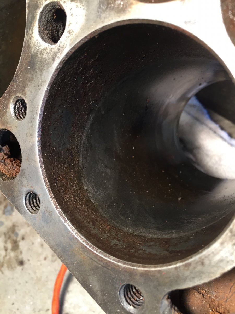

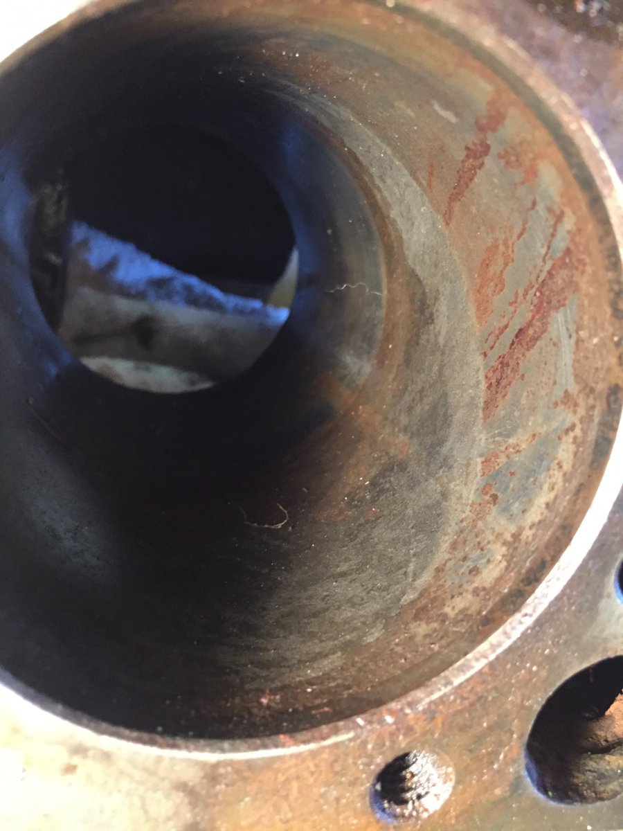

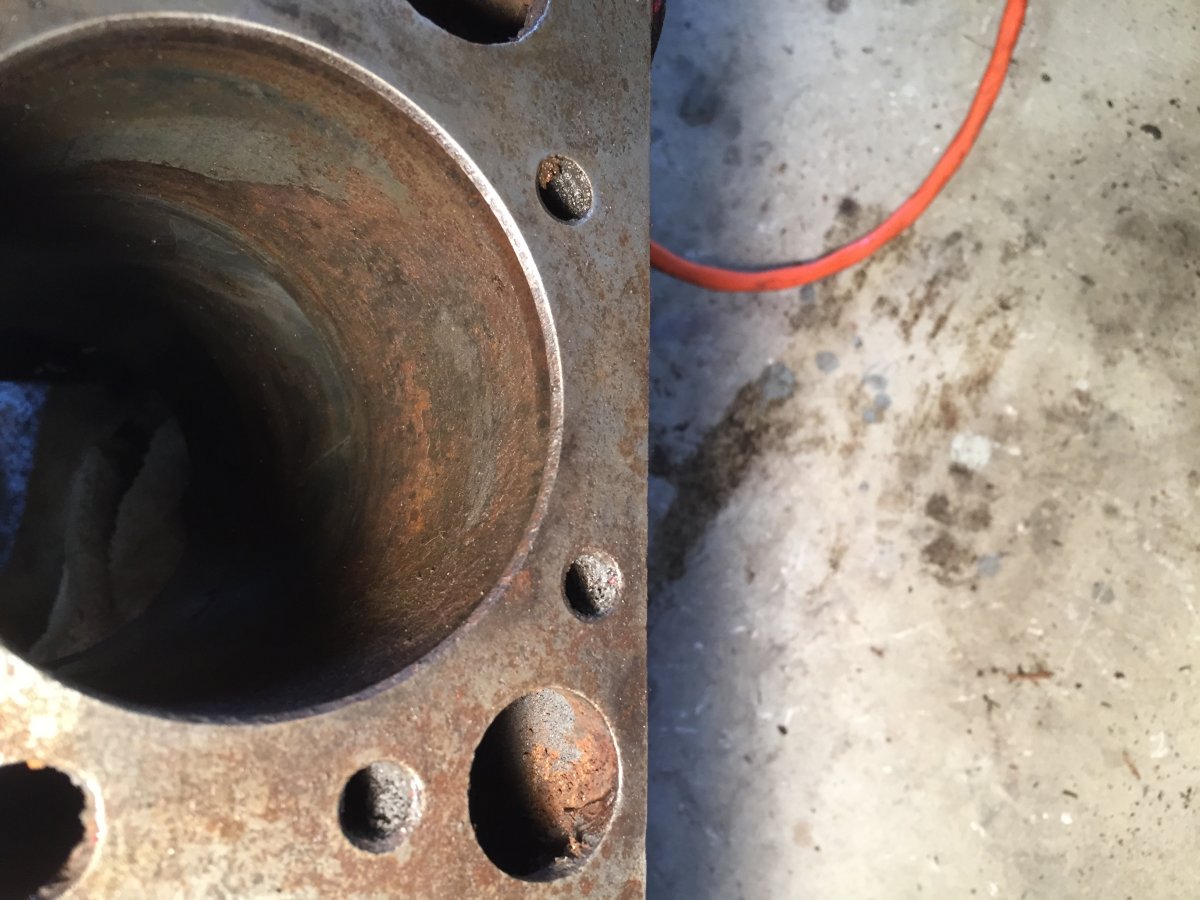

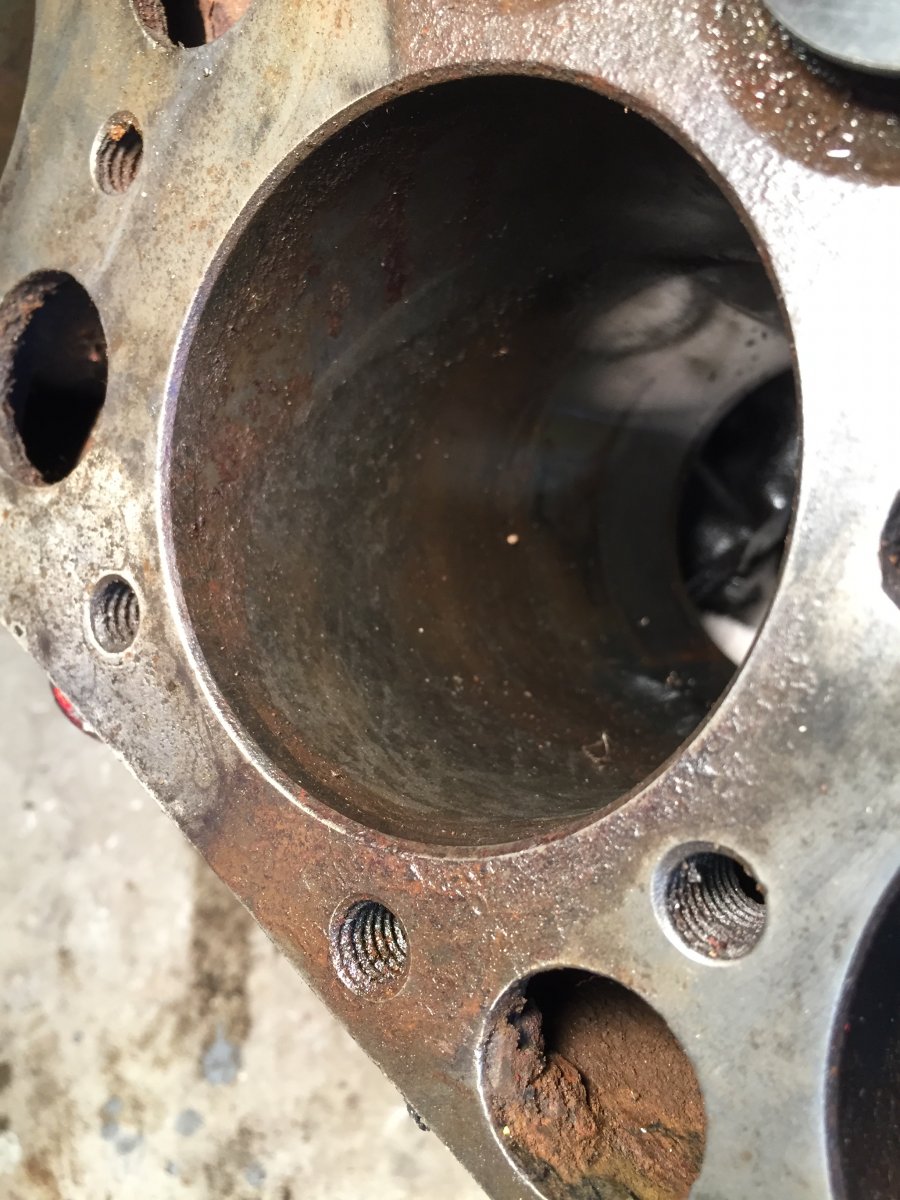

    Some before pics....

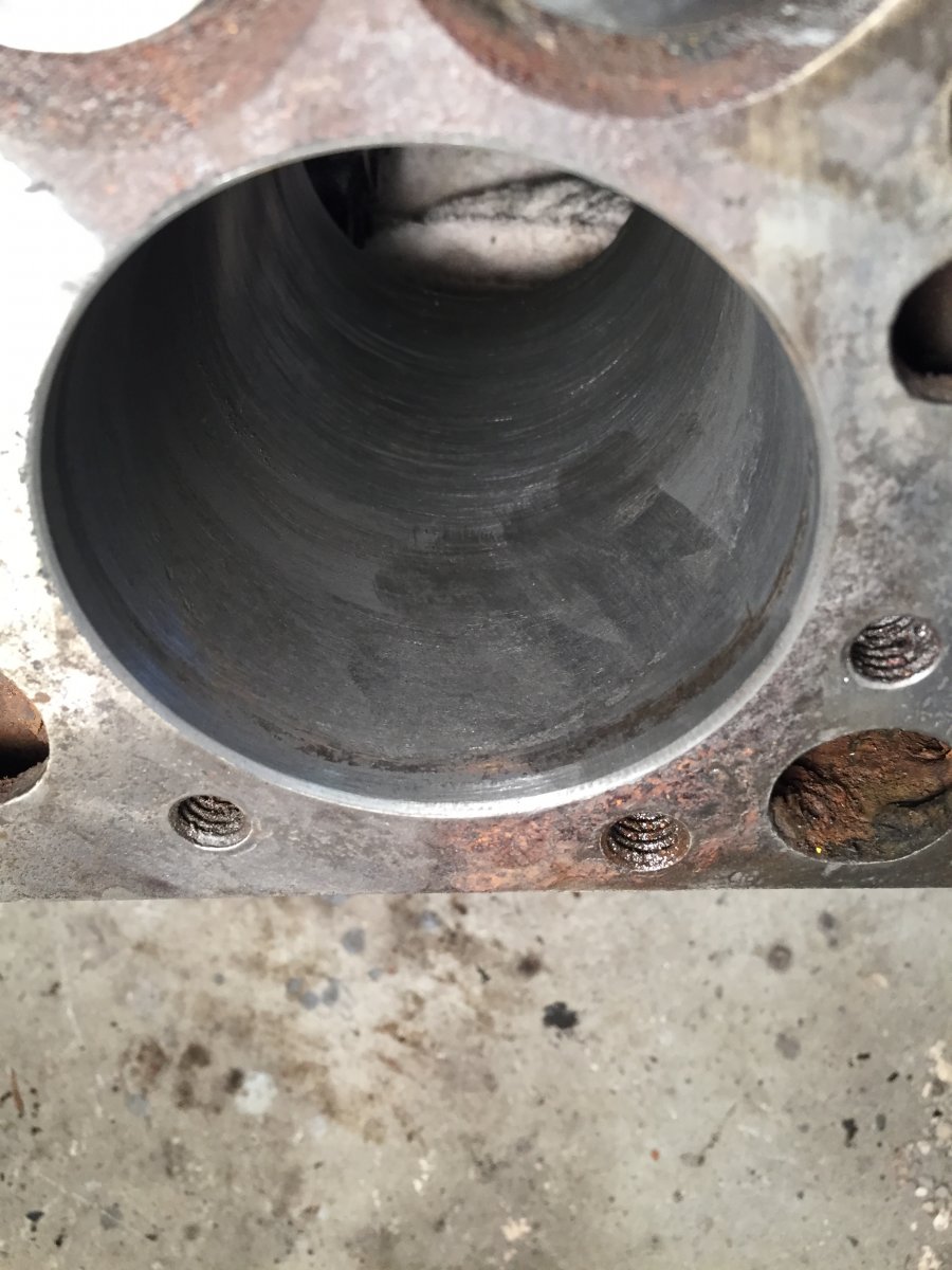

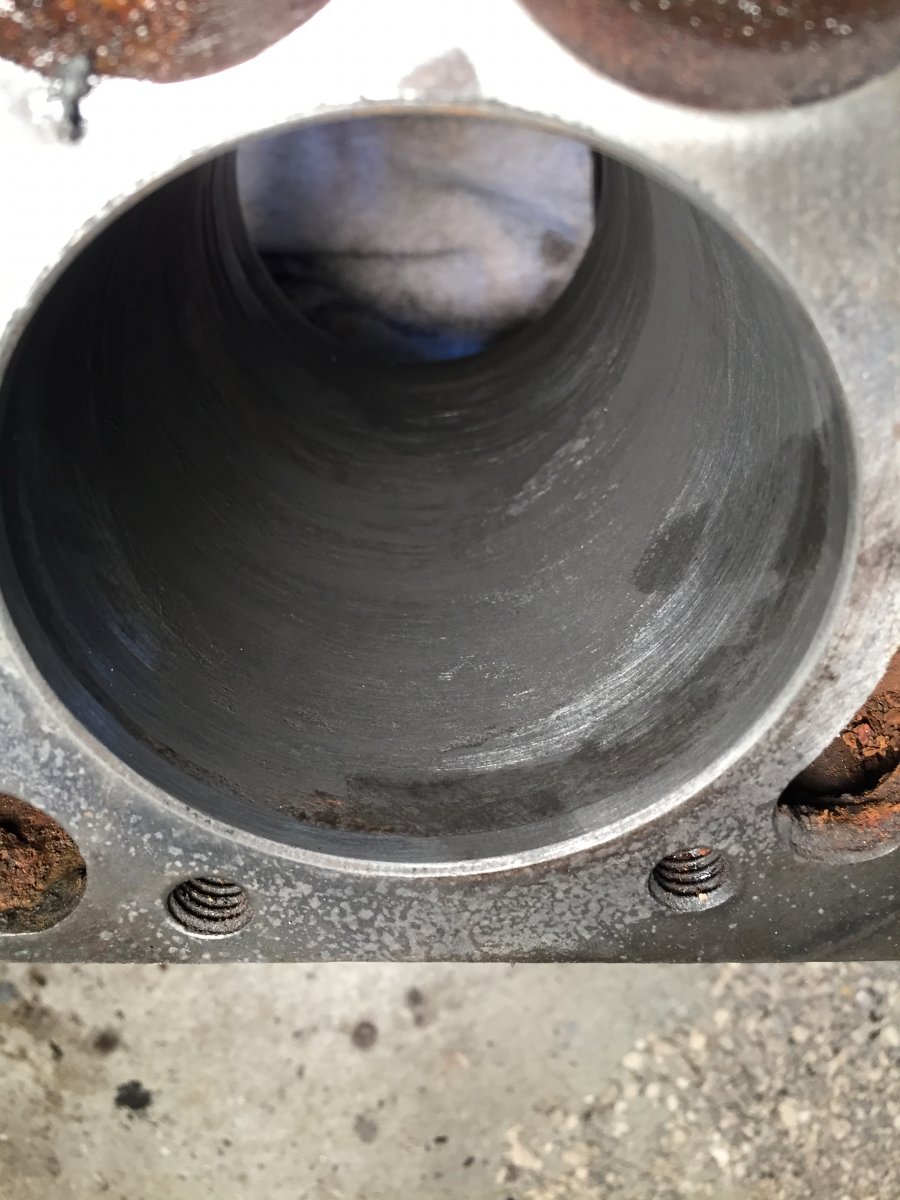

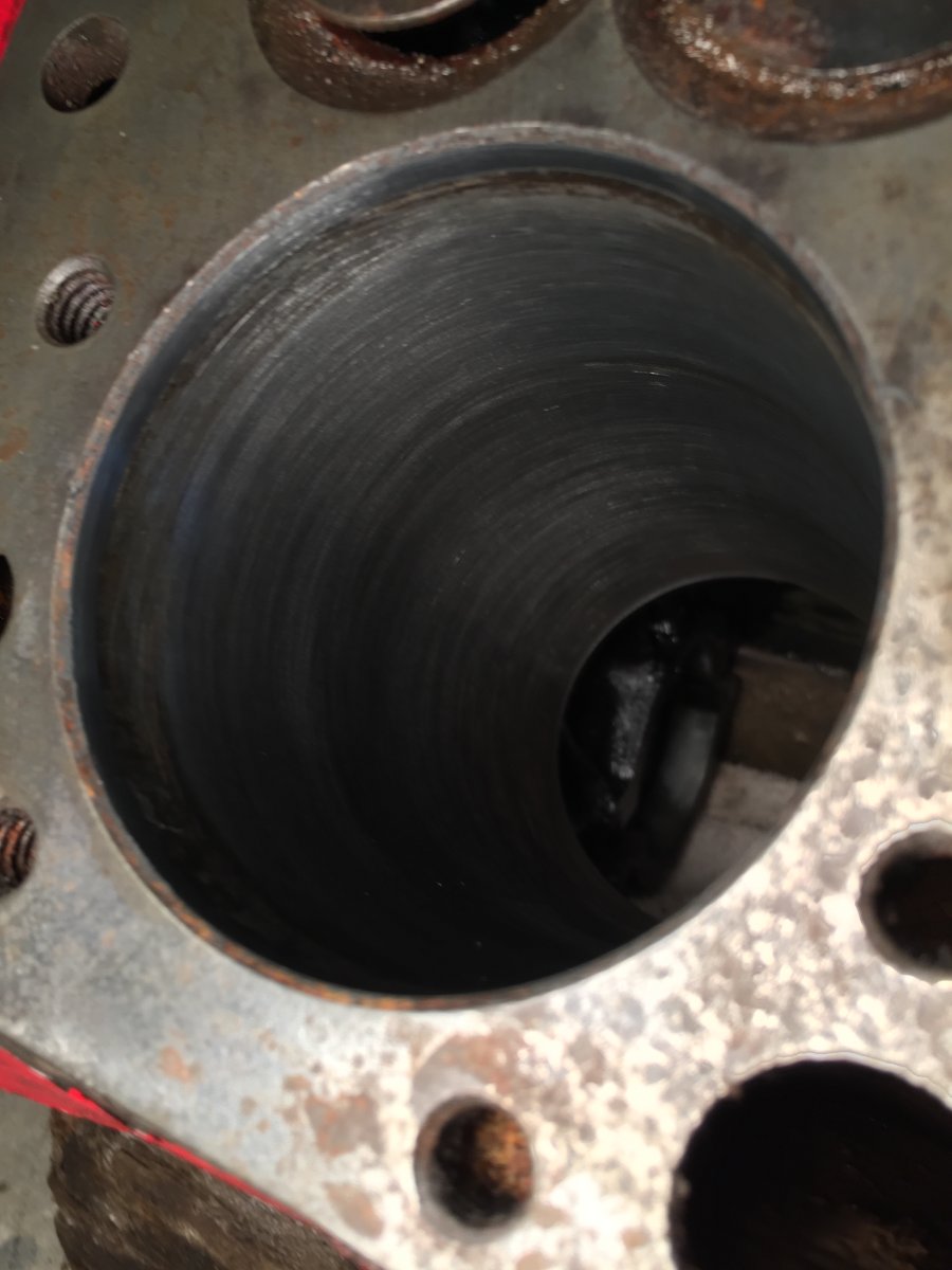

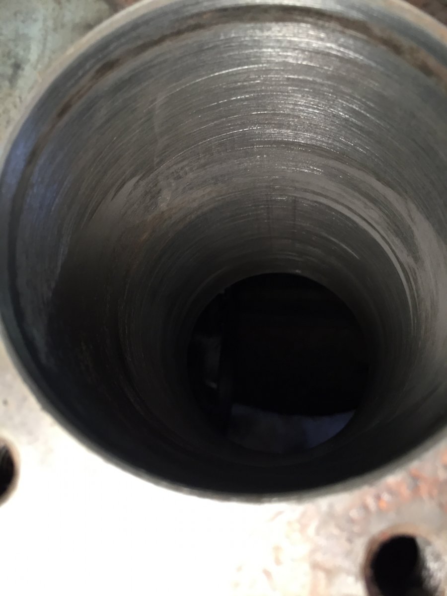

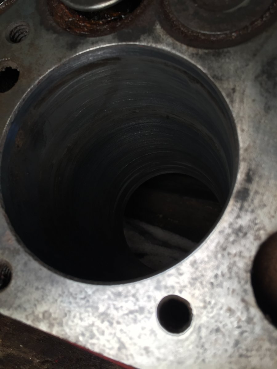

    Now some after but not done yet...

    We measured the bores with a telescoping Guage and found a variance of 3.190-3.192". We measured each cylinder twice 90* between measurements. Since the original bore size is 3.1875" we have a wear of between .0035-.0045". Do the cylinders need re-boring or are they close with enough so that a simple overhaul would do?

    I need to have my machine shop do an accurate measurement of the bore in three locations as well as get the taper information. If there still is enough wall thickness to use the original bore calculating in potential wear then I'll probably just do that. But I do want to know there is enough meat left and not close enough... New main, rod, and cam bearings regardless. I'll have them evaluate the cam as it may have been changed in the past. If it is stock I'll either purchase a new one or may just have a local old time cam grinding shop re-profile it.

    It will be necessary to rebore any cylinders that have a taper of more than .006, out of round by more than .003, or if wear exceeds .005
    Truck64 and flatford39 like this.
  12. The wear doesn’t bother me as bad as the pitting,,,,,the tops of some o& them look pretty rough.
    I am not opposed to using bores with a little too much wear,,,,,but,,,you might want to consider a rebore with that much pitting.
    Check it very closely to be certain,,,let the machine shop inspect it closely.

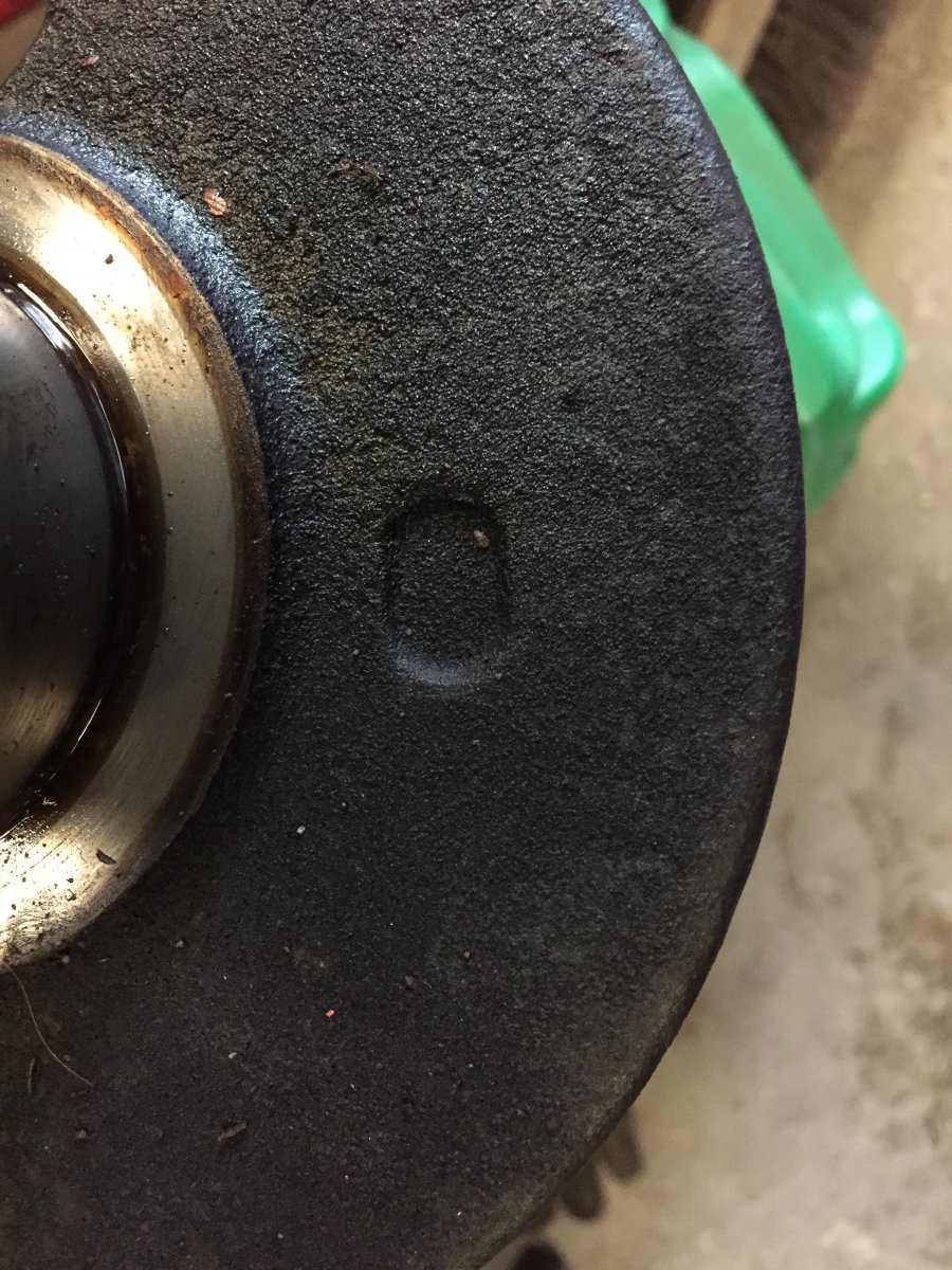

    Just checked the crankshaft and somebody installed a Merc crank!!! Has the well known Merc dimple...

  16. Are you sure it isn’t a Merc engine to start with ?
    My 49 Mercury looks just like it,,,,and it also has 8BA cast into all the castings,,,block,,oil pump,,,,it is still an 8BA,,,,even though it was in a Mercury car ,,with a bigger crank .
    Tommy
  17. alchemy
    Joined: Sep 27, 2002
    Posts: 23,465
    alchemy
    Yeah, only the Merc specific parts got a Merc number. Crank, heads, maybe some water pumps, carb.

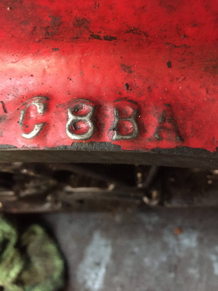

    Well the engine did have Merc heads on it but with the C8BA cast into the bellhousing I took that as the main clue. Easy to swap head, rather difficult to recast a block to fool someone. LOL. Any ideas on the cam? I'll dig out the old intake to investigate further.

    Isn't that just simply a Canadian 8ba ?
    flatford39 likes this.
  22. Looks like Canadian to me too.
    But didn’t they make Mercs in Canada as well.
    My Mercury has 8BA cast into it in several places .
    And my crank doesn’t have the dimple on it anywhere.
    Tommy
  23. quickchangeV8
    Joined: Dec 7, 2010
    Posts: 612
    quickchangeV8
    Yes indeed!! Definitely a Canadian block. The C in front of the 8BA signifies the block was made in Canada. The Canadian 8BA blocks were made up until and including 1954 and could still be ordered in Canadian 1955 cars. The 4 inch crankshaft would have been installed right from the factory. Try to save that block. It would have a higher nickel content in it.

    Well I know it’s a Canadian block. Somewhere I read that all blocks cast in Windsor wore the C8BA ID and if it was going to be installed in a Merc it got the Merc specific parts otherwise it got the Ford parts. Did the Merc have different cams? I believe the had different pistons and perhaps con rods...
    When the engine shop manager did a prelim measurement of the cylinders I believe he said that they were around 3.188; stock is 3.1875. However, due to the unfortunate rusting in some of the left bank cylinders it will have to be bored .020 or perhaps .030. So I’m still happy. They will hot tank and magma flux before anything definite transpires.
