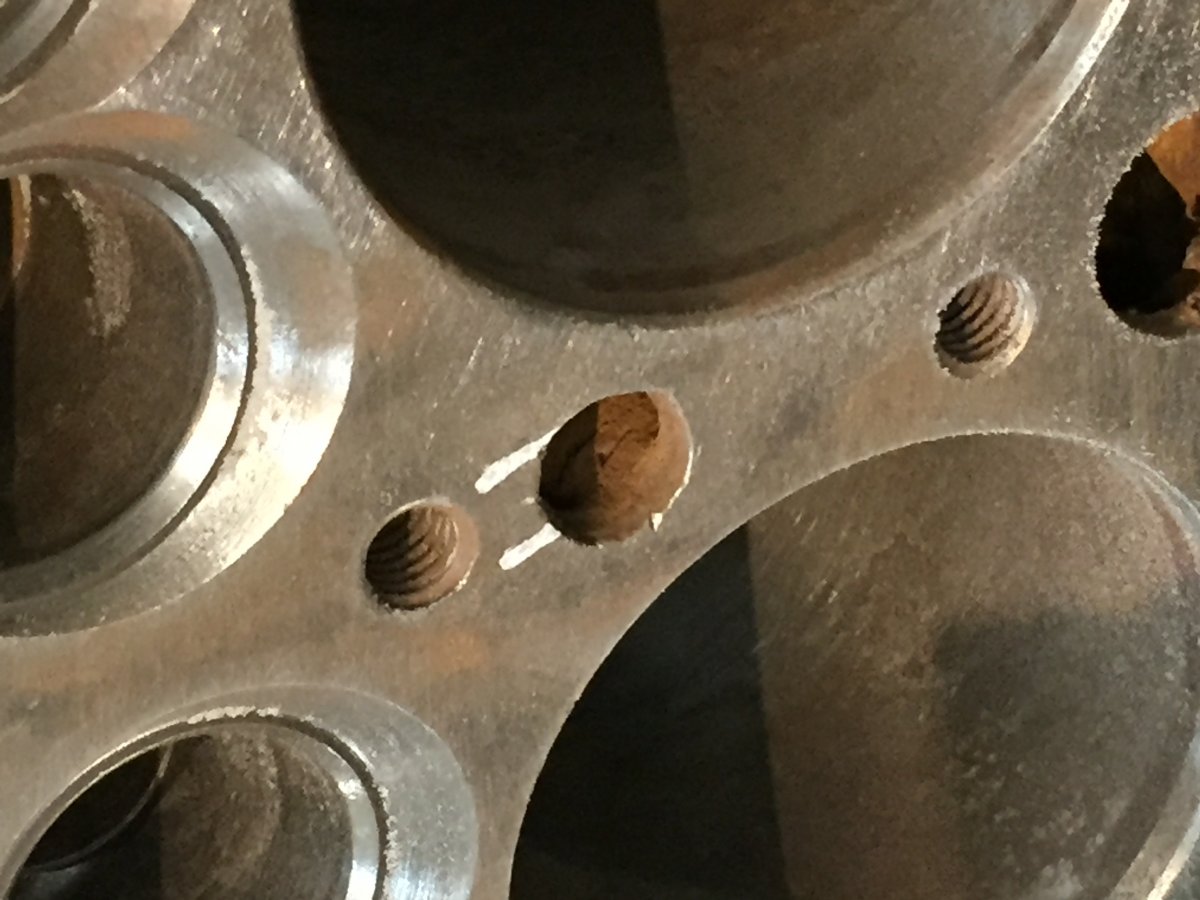

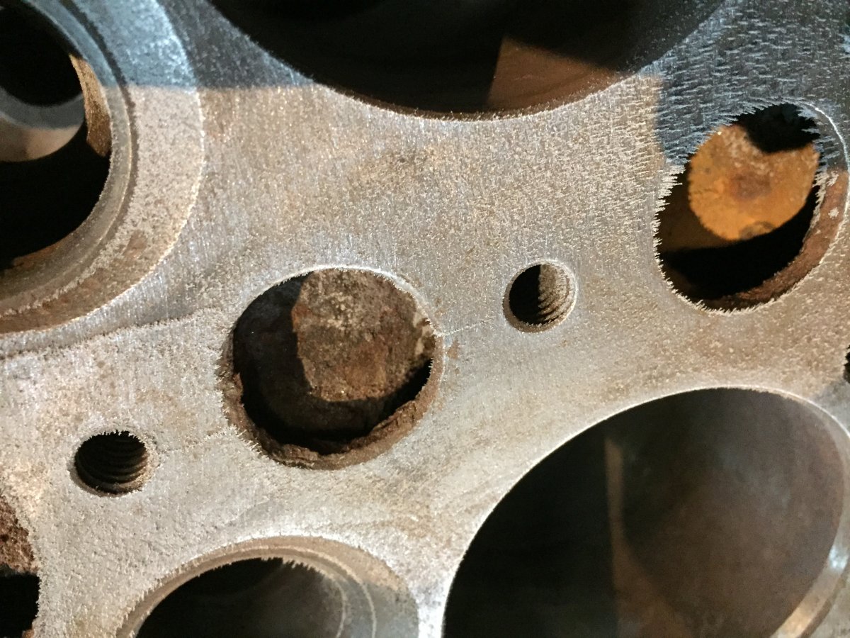

    FECC189A-BACB-4775-B595-E30197C091C6.jpeg FECC189A-BACB-4775-B595-E30197C091C6.jpeg BFBD6813-F09E-4F89-AE70-20DF0C590455.jpeg Oops... only one tiny crack and one medium despite the extra pics.
    The two shadowy area around the centre water outlet have cracks but no biggie. Just a teeny tiny disappointed, hey it came with a Merc crank! And they are not at all concerned with the valve seats. Got to pull the plugs and clean the crank and then magnaflux it...

  12. Sorry man,,,,I was out last night and just got home from work today .
    It will work great,,just a few smalll cracks .
    What about the one into the bore,,,I didn’t see a pic of that .
    Either way,,,a sleeve will save it !
    It should make an excellent engine !
    Tommy
    Ps,,,,I got lucky with mine,,,,,,it was crack free,,,I had heard from all the others about horror stories of buying several blocks to get a good one .
    I was prepared for the worst,,,the big Boss was smiling on me !
    I think you came out great .

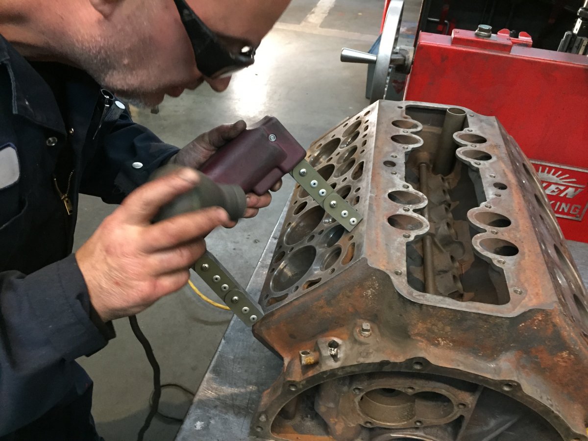

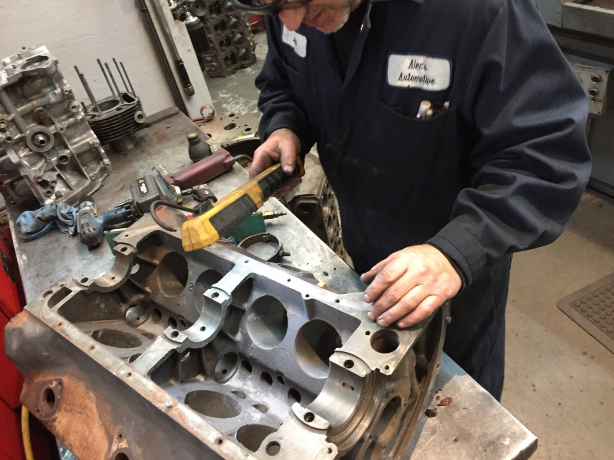

    By the way, I stopped by Alec's to chat about the block this afternoon. They'll send it out for a "heat and blast" next week. Monday I'll drop of conrods, oil pan, oil pump, etc for a bath. I'll have to see if the oil pump is in good enough shape to re-use. What should I look for?
    Rob at Alec's is not wanting me to spend a ton of money which is a nice change. As an example, he advised me to bring in the set of original Johnson (sp) adjustable lifters for an inspection and a re-surface if practical rather than buying a new set to save me some money. He's working with me rather working to increase his profit. Very nice in this day and age!

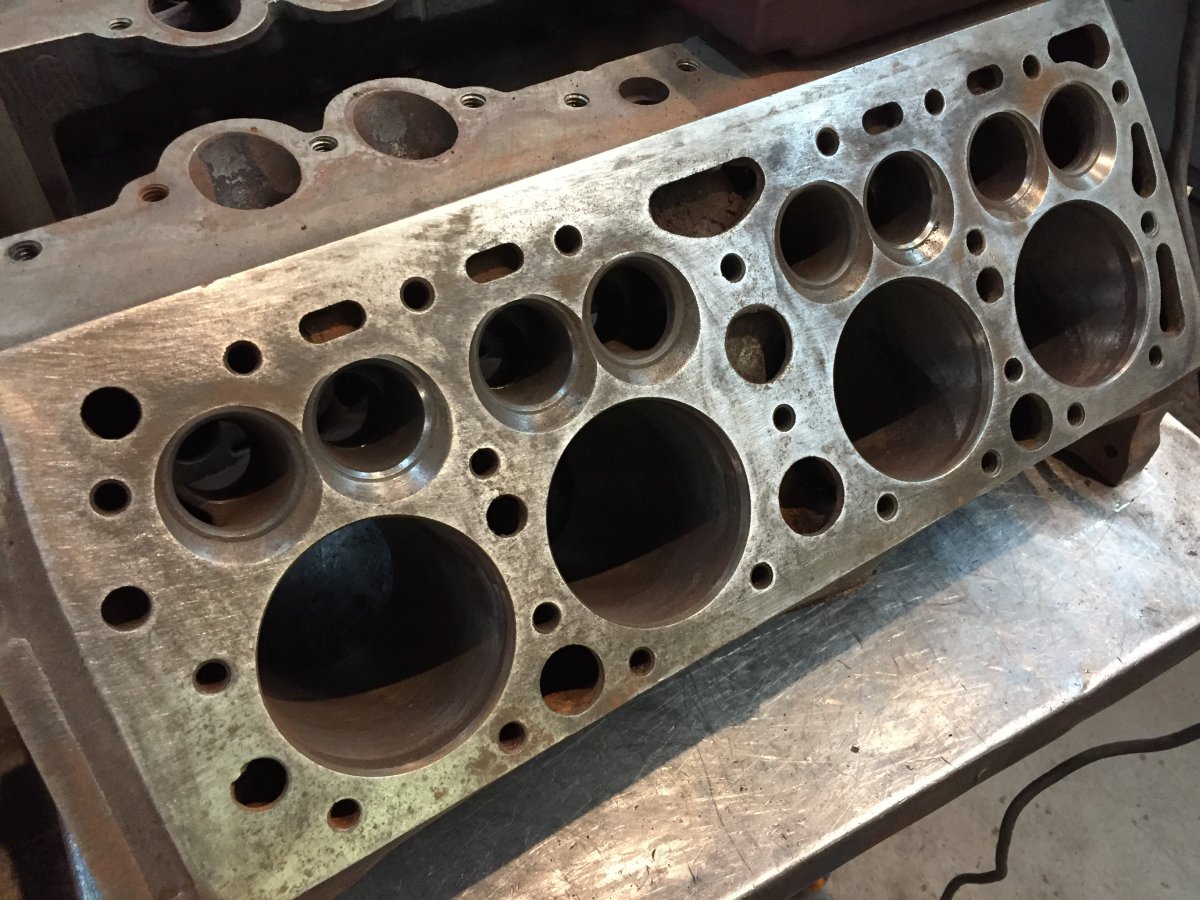

    I retook the pics from last week which I'll post. Three tiny "Ford part number) cracks, a tiny one that goes into a bore so a s***ch and a sleeve, and the two weird ones at the upper centre of the deck which will be s***ched.

    here's a couple more for ya lol;) ...I always appreciate detailed pics of this kind of stuff and seeing something saved instead of replaced
