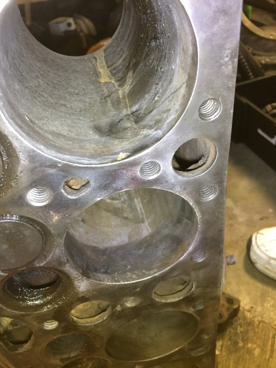

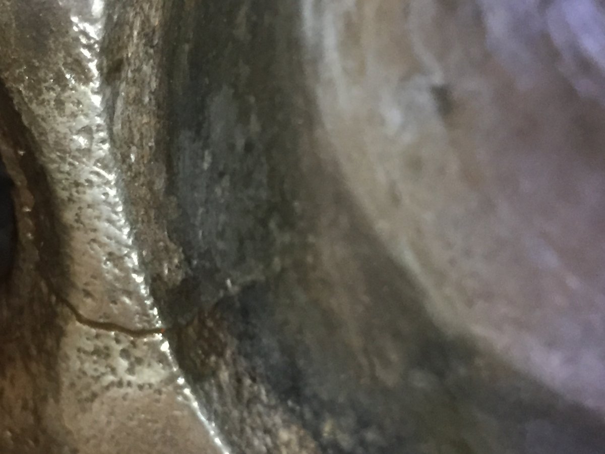

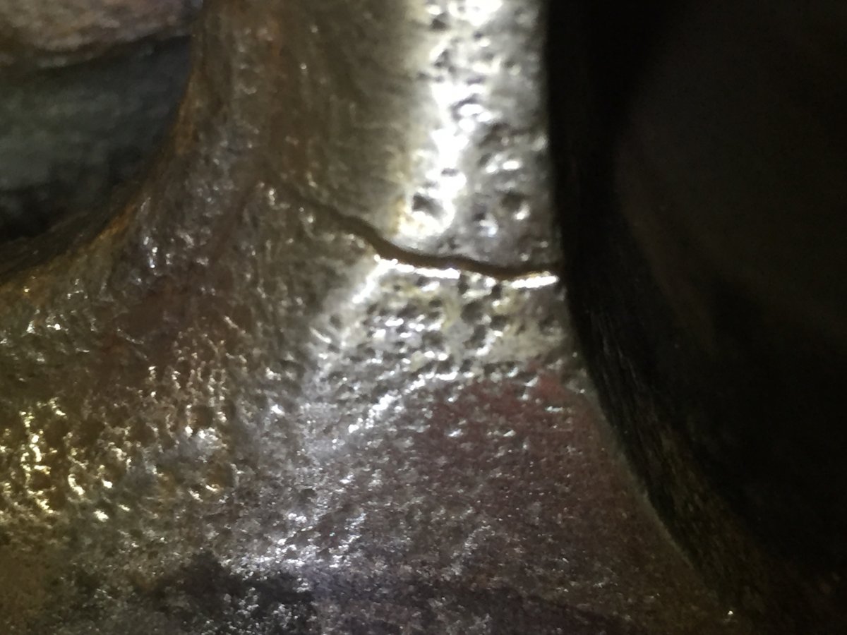

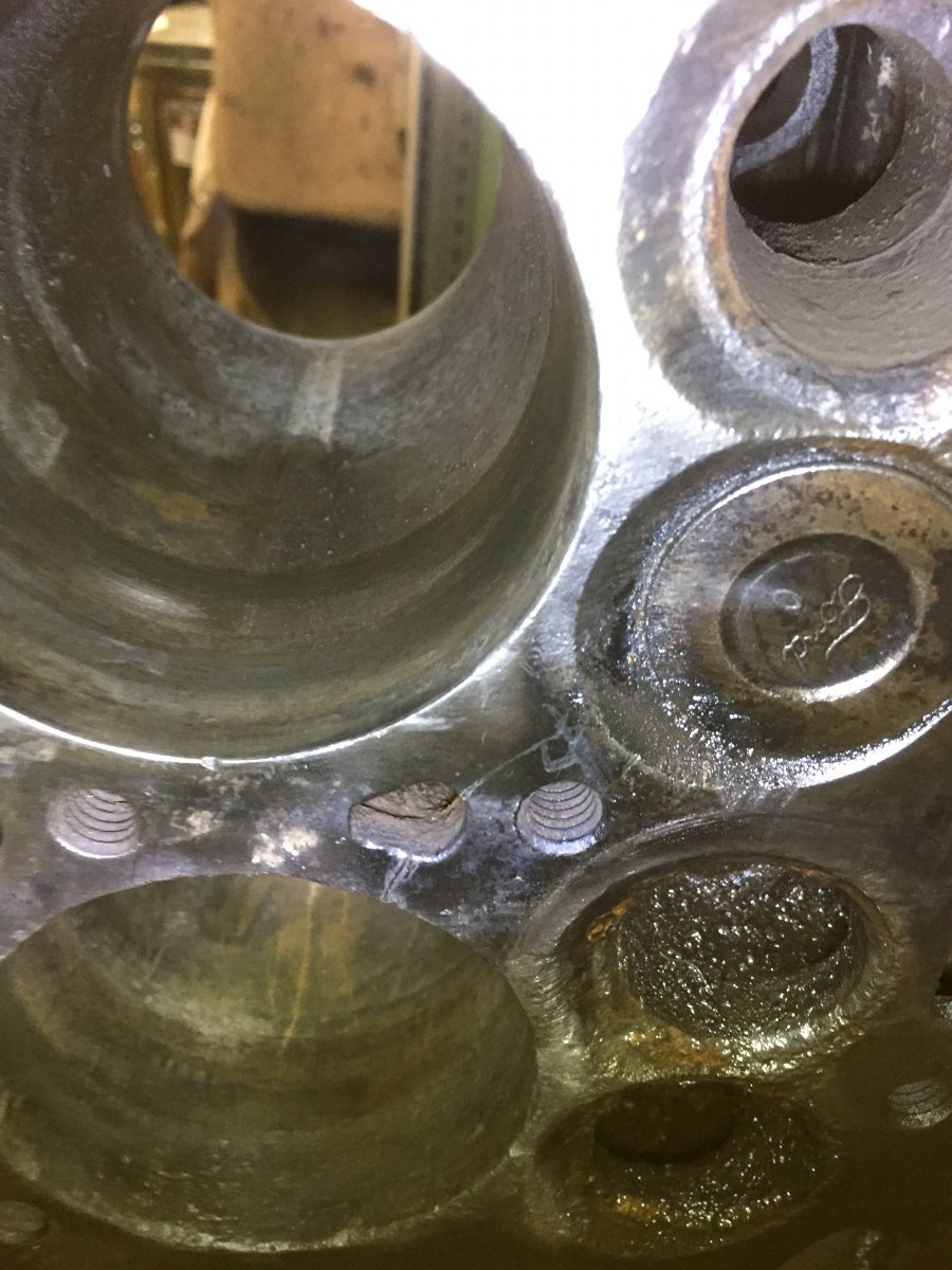

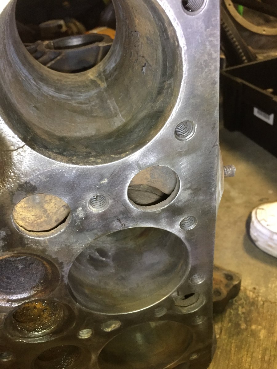

    So the first pic is where a teeny crack goes into the cylinder as well as a tiny one they are not concerned with and the second pic shows the weird double crack. The second pick also shows two tiny cracks they are not worried about.

    Ouch! That double crack looks fatal. Does the machinist think they can save that?
    If it is saved, make sure that you fully clean the water jackets with sand blasting down into them. I think the regular heat and blast in an automatic cabinet won't get down into the water jackets. Sand blasting by hand you can aim into the cavities and get all that original Ford casting sand loose.
    My flathead had this done at rebuild and it runs 170 all the time.

  5. You’re right Alchemy,,,that looks a little scary .
    That is in the center area,,,it might not not matter too much,,,I’m new to all this Flathead crack business and am still learning on all the flaws and where to look.
    I do know tha5 there are people with the talent to fix almost anything.
    Indy cylinder head can fix just about anything,,,and I have read where Hand H welds a lot of unfixable blocks. It all goes back to a talented craftsman and the right equipment and process..
    Hope it works out .
    Tommy

    I’m with them ^ I think I would look for a new block rather than risk that

    Well I was worried but they say they can handle it. I have complete confidence in them but we will see... I do have another block that may be a candidate if need be.

    Depending on how deep the two cracks going from the cylinder to the valve pocket are, maybe if you relieved the block it could possibly remove the cracked area.
  9. No problem,,,,I always try to listen to the pros,,,,they usually know more than I do .
    It might not be a crack,,,but where something marked it .
    Tommy

    One way to find out if the crack is deep is to do a liquid dye penetrant test on the crack. Apply the dye and let it creep in the cracks for a half hour as the dye will creep deep into the crack if it is deep. Wipe the surface with the recommend solvent then spray on the white developer. If it is a deep crack the penetrant will wick a heavy bleed out into the developer. A shallow crack or "indication" will leave a very light bleed in the developer. That may be an inexpensive way to test yourself. The thing is once the crack has been ground on the dye may not work on follow up as grinding can smear the crack over.
    If the person that did the testing is an experienced tester then he should know what he is looking at. Usually if there is a deep crack the particles pile up on both sides of the crack to highlight it. If it is a surface indication then there is not a break in the magnetic field as there would be with a crack but may have been noted just as an indication. In non destructive testing the marks are deemed "indications" the split into relevant and non-relevant. Relevant ones are the ones of concern. The tester should be able to tell the difference.

    This is a great idea! Re-looking at the pics I'm going to hold off on the heat and blast treatment and see if they can look a little closer at that weird double crack and perhaps start the pinning and see how it goes.
    I'll be trying to remove a set of original Johnson adjustable lifters this week in another flathead I have and may just dis***emble the whole engine and take that for evaluation instead.

    Went back to the machine shop today to discuss the dreaded "double crack" (no, not the toilet paper hoarders!). They are not concerned in the least as they say the cracks have no where to go and right below the area it is solid. They explained it as an island which they will connect to the mainland with s***ching. We will have a couple done before the bake and blast though to be sure.

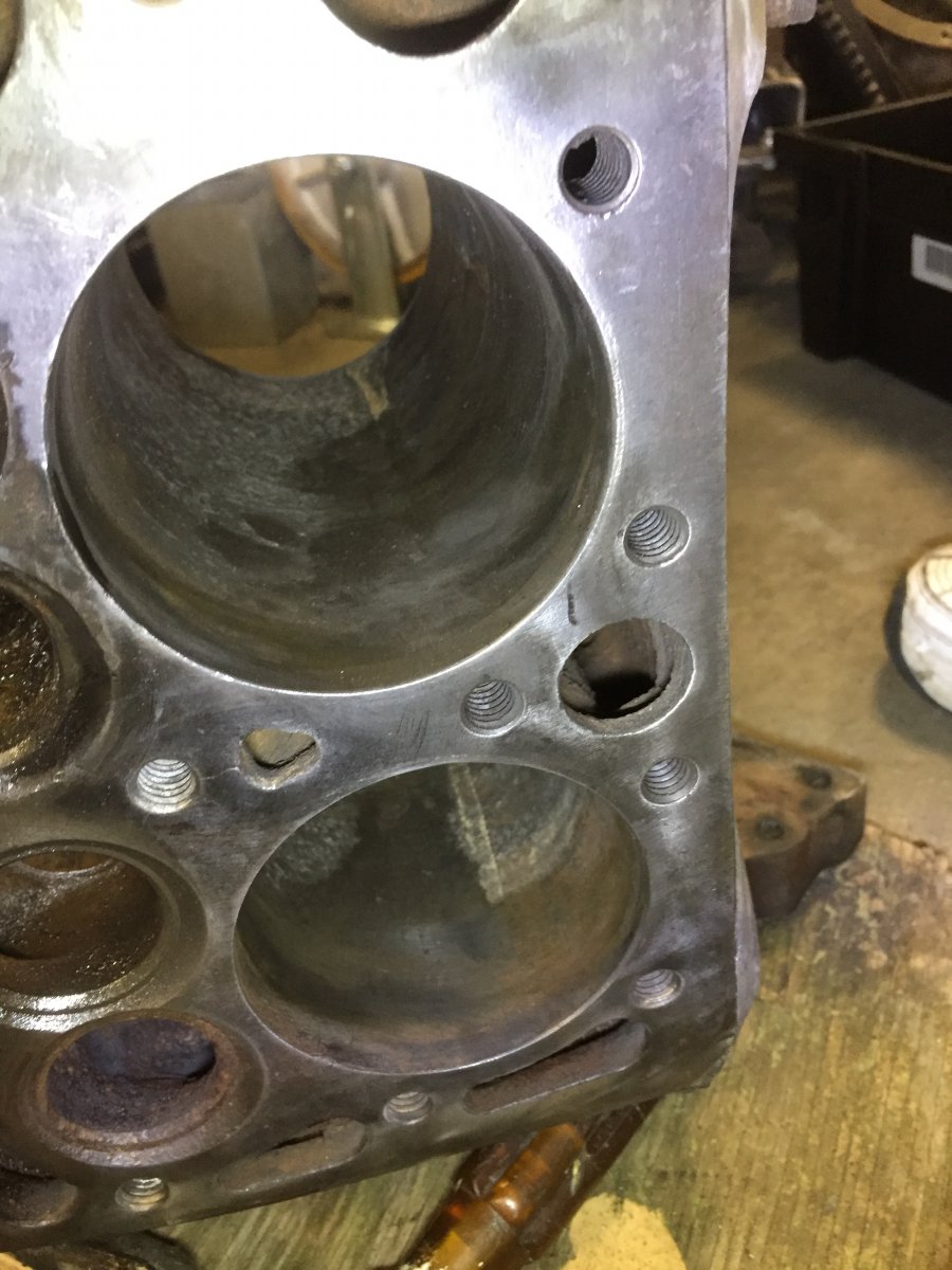

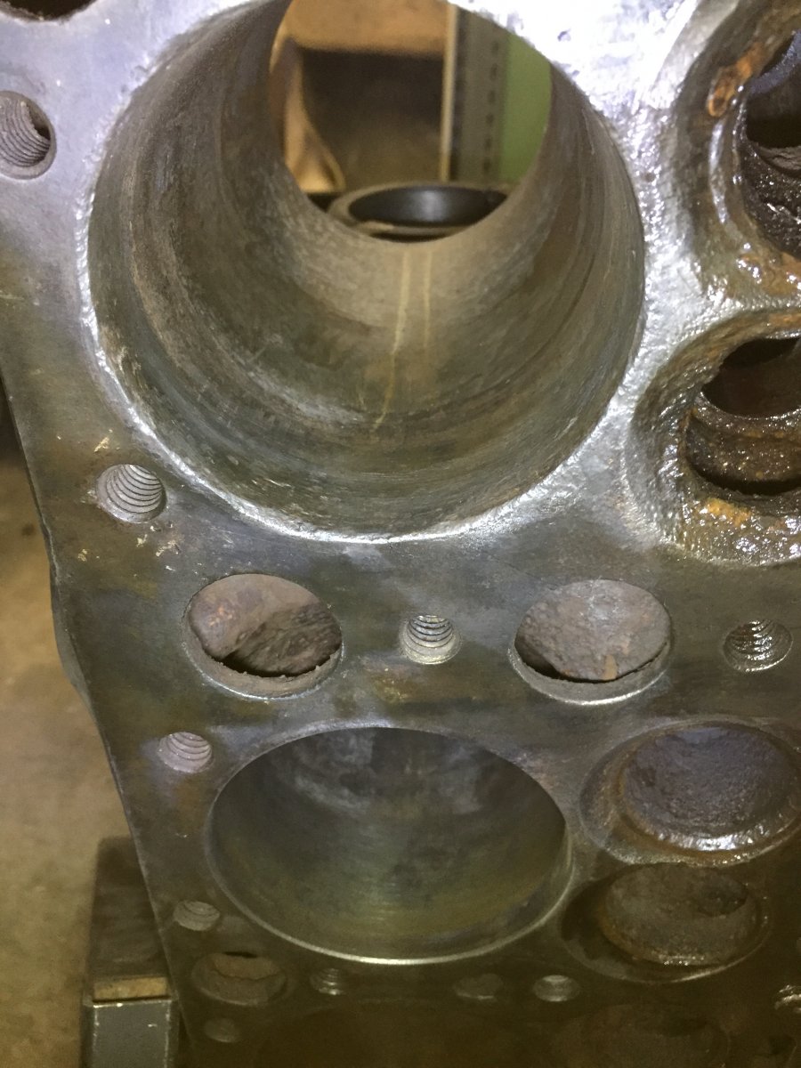

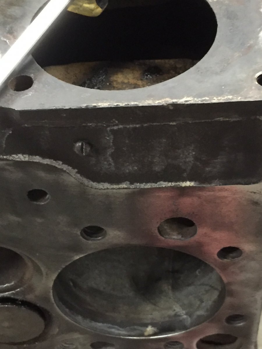

    Forgot to mention that this second block has a crack from the valve to the cylinder though I can't tell how deep it goes. And a second crack two inches along the pan rail where the gasket lays. At first I was disappointed but after doing some research on here and the Ford Barn apparently they both can be repaired.
    Sleeve the cylinder and pin the area between the cylinder and valve pocket and then a new seat. The rail issue can apparently be repaired with JB Weld since it isn't pressurized. I'm intrigued with the other thread on here where the fellow used block cement to add a little beef to the lower block...

    Hmm. I always read that pan rail cracks were fatal.
    It's Auliz in Europe who had the thread where he fills the bottom inch or so of the water jacket with block rock.

    Yep, I thought they were the death knell but apparently some are being saved. H&H apparently gets them welded, some use JB Weld, Auliz does the engine cement thing...
    I did a search and Mart, Crusty Flathead rebuild, welded his up. But these are only for cracks along where the gasket fits not for cracks that go inside of the block. I'll now be keeping this second block as you never know....

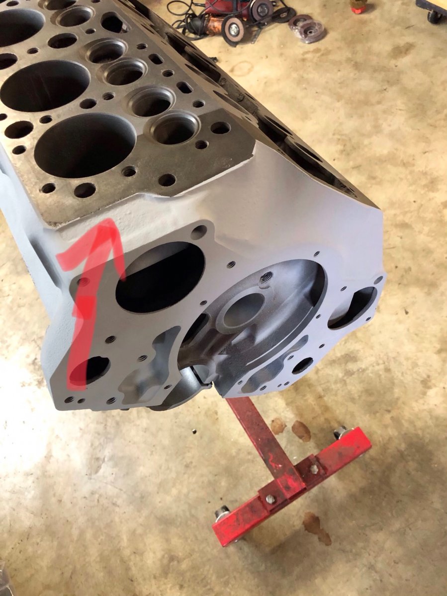

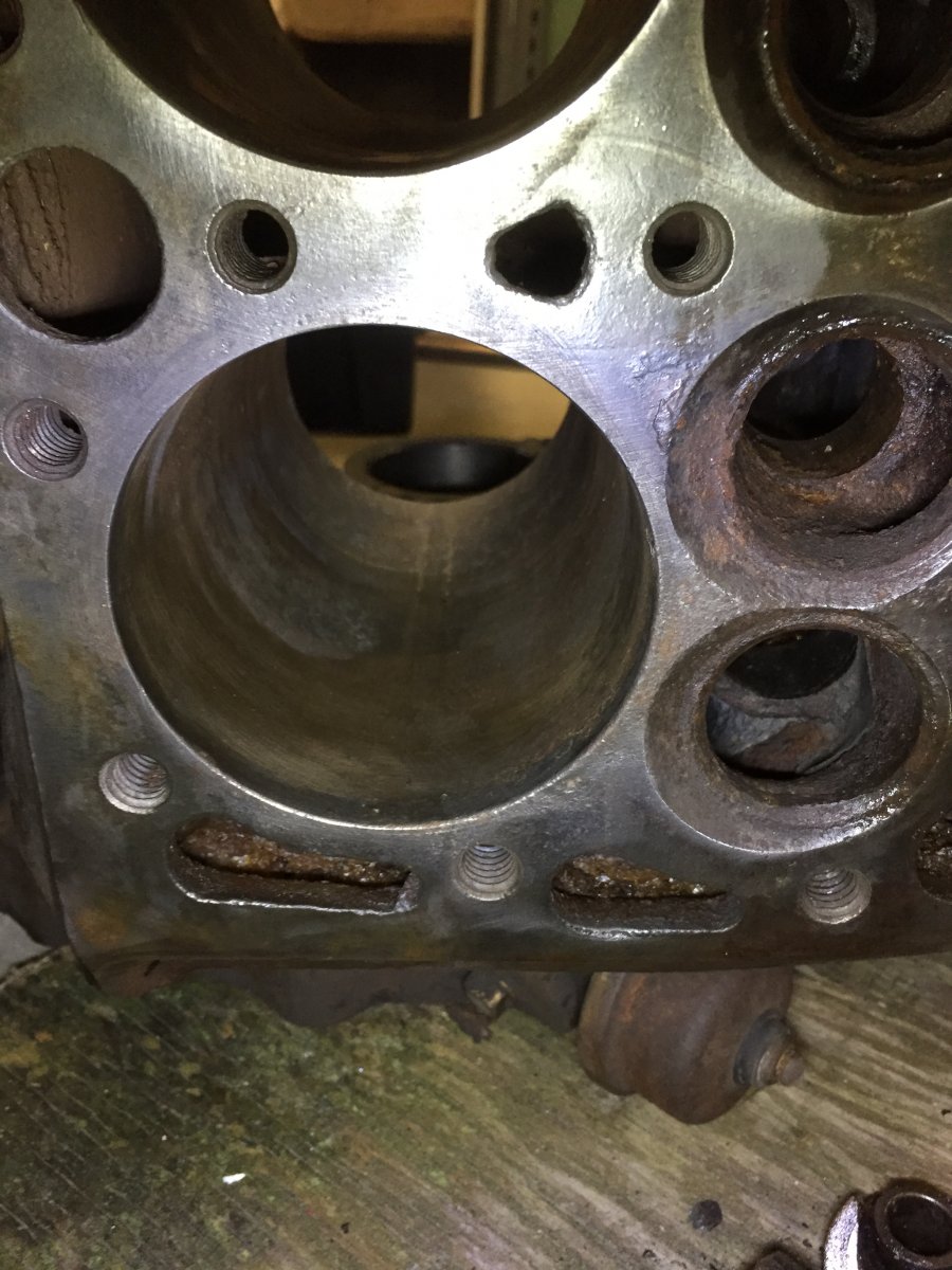

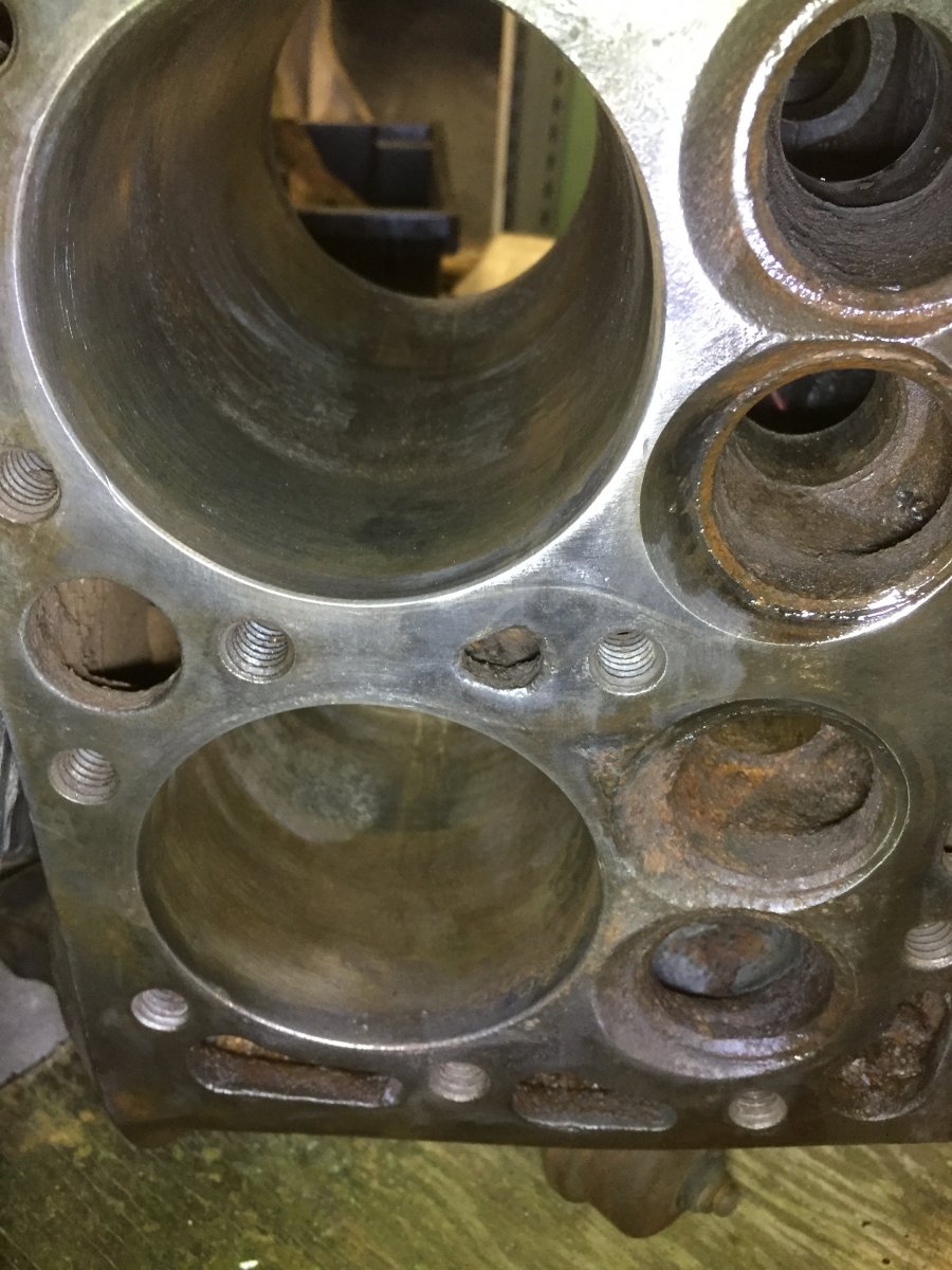

    Can someone identify which year block had this little relief at the front of the right hand deck? See pic...

    It looks like someone's taken a power sander to the deck surface. If so it will need to have the decks milled, so before spending money on it make sure it will clean up within acceptable limits.

    Well I did go over it quickly and lightly with a wire brush. Any idea on what year of block? It says C0BA. I'm just wondering about that little relief.
  30. 9580FC44-21FC-4EFB-AADB-8AADE0852E45.jpeg I’m not certain if I understand about the pic with the relief .
    Are you talking about this ,,,,where the red arrow points ?
